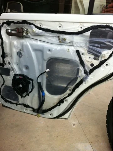

I used a 10mil visqueen that can be sourced for $20 at any home improvement store, and a 3M black caulk on a rope that Lou suggested, that can source at any body shop supply.
Choose the visqueen sheets after failing at installing the 80 OE vapor barriers, simply because there wasn't enough slack in the OE product, so cut my own.
The 55 would be a lot easier, since there's only a single door handle to accommodate. Unbolt it, slide a much larger visqueen sheet behind, stretch, then press against the 3M product. Trim closely around edge of sealant.
It would've been a much simpler process, but I also chose to do on a +100 degree day, and the black caulk is hard to work with when hot. I even took Lou's advice and refrigerated before each panel, and it was still sticky.
Nothing like black caulk on your fingers when sweating profusely......
Only pic I have and of the first. Progressively got better.
One thing to ensure before sealing it up, is that the drains are clear and that your done inside the door.
