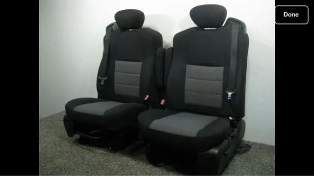

I'm considering F250 seats that look like this:
They're manual buckets, with armrests, and ABTS, some of the basic criteria sought, plus preliminary measurements indicate they'll fit.
If selected, the only choices for belt colors that coincide with the overall scheme is black, which has prompted serious consideration to a black interior.
So, if the black avenue is travelled, can see black door panels, new black covers for the front and rear seats being in order, but want to match all, as closely as possible.
My question to all is, (sorry for the thread jack, but this seems easier) is an all black interior going to put me out to pasture with the black sheep?
I'm kidding, more is there anything that I'd regret, since returning to OE seat or OE seat covers on replacement buckets doesn't seem to be a feasible option, in all black?

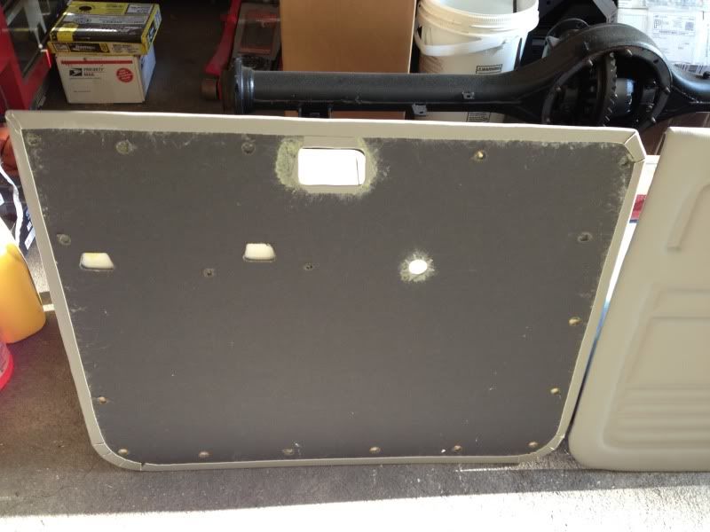

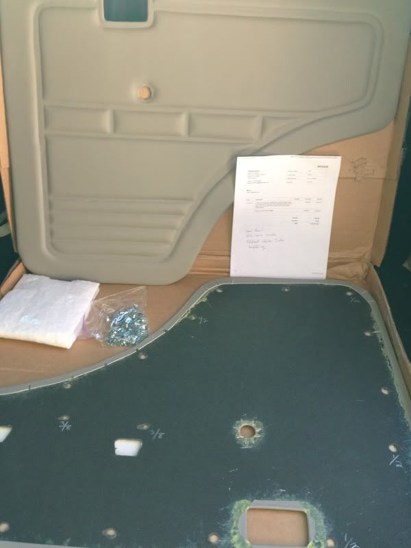

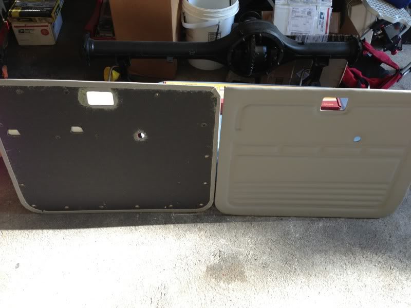

Man - go out of town a few days and this thread wonders all over the place. Back on topic, got my set of panels from Steve and unpacked them to take some pics this morning. These came well packed with the clips included:
Front panels:
Close-up of back of panel (greyish stuff is glue):
Rear panels:
The panel material is pretty close to the stock stuff, you can see the cutouts in the board for the arm rests. Hopefully I'll get to test fit at least one panel tonight, I'll post up what I find. I'm going to be painting my arm rests and window cranks with high end SEM paint (vinyl prep/adhesion promoter/flexible primer/multi-coat), so all the panels wont be installed until that is done. I will install a front and back to ensure fit for everyone, I had promised Steve I'd make sure the clips work as well.

Question- what are the little holes on the back of both panels for? On the rear panel they are labeled "3/8"?
I'm not sure, guess I'll see when I'm installing them. I had sent the stock panels, he pulled off the vinyl and made exact copies ... these holes are present in those panels.
