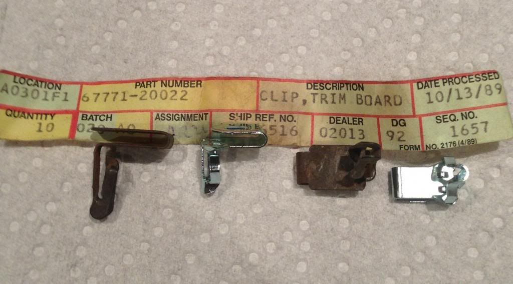

Didn't have time to test fit the panels last night, but did take a pic of the clips included compared to the stock clips:
You can see they are shorter in both directions, and a little wider at the clip wings. Should be able to let you know how they work tonight. I've only got 30 of the 64 OEM needed, so really hoping they work ;)

Installed two of these tonight and the fit was perfect, had to modify the clips slightly and figure out orientation since I had nothing to go on ... but easy otherwise. I ended up just squeezing the wings on the clips he sent with needle nose pliers to make them fit in the plastic grommets better (sorry for crappy pic):
