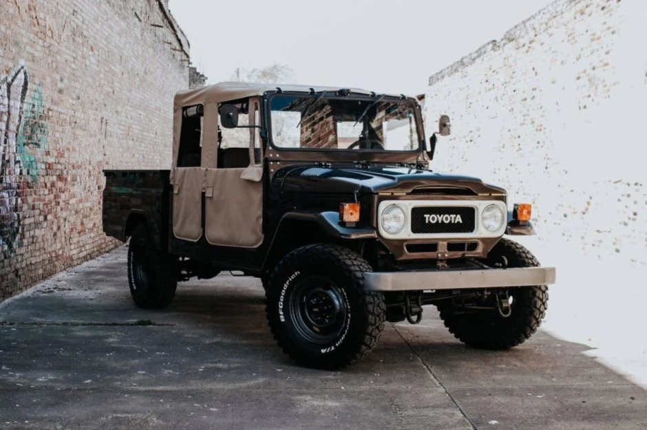

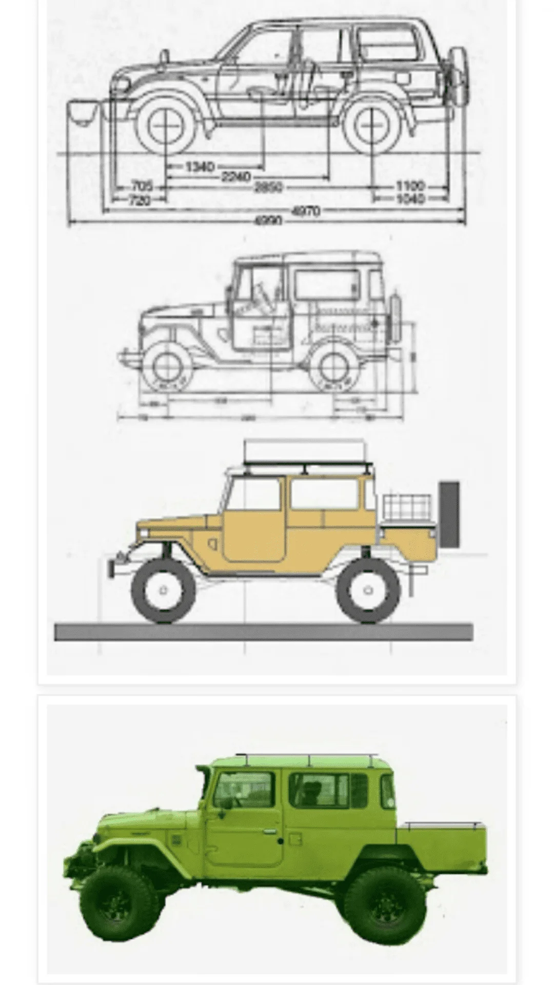

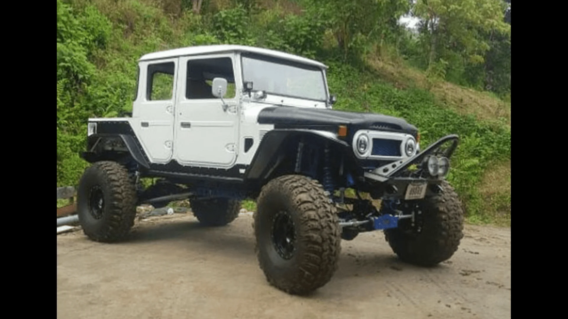

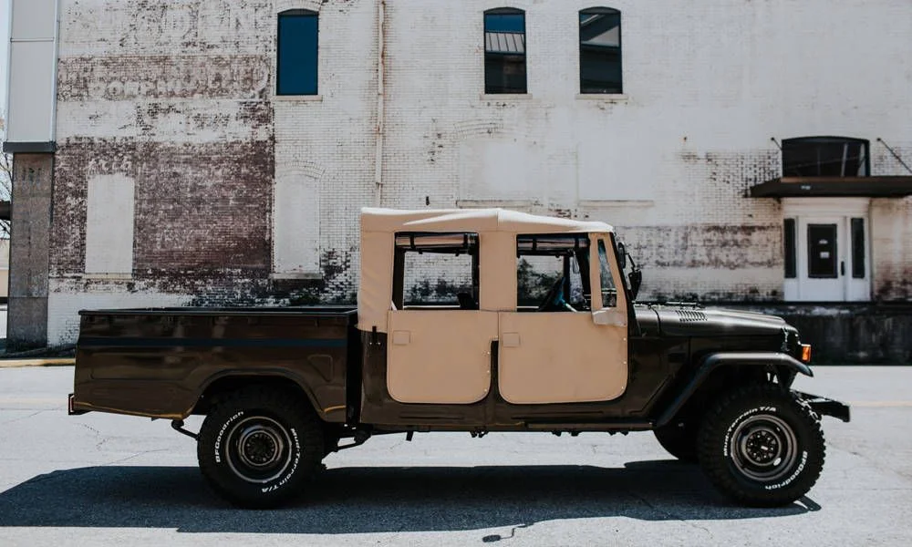

Neither of those pics are what you are describing.

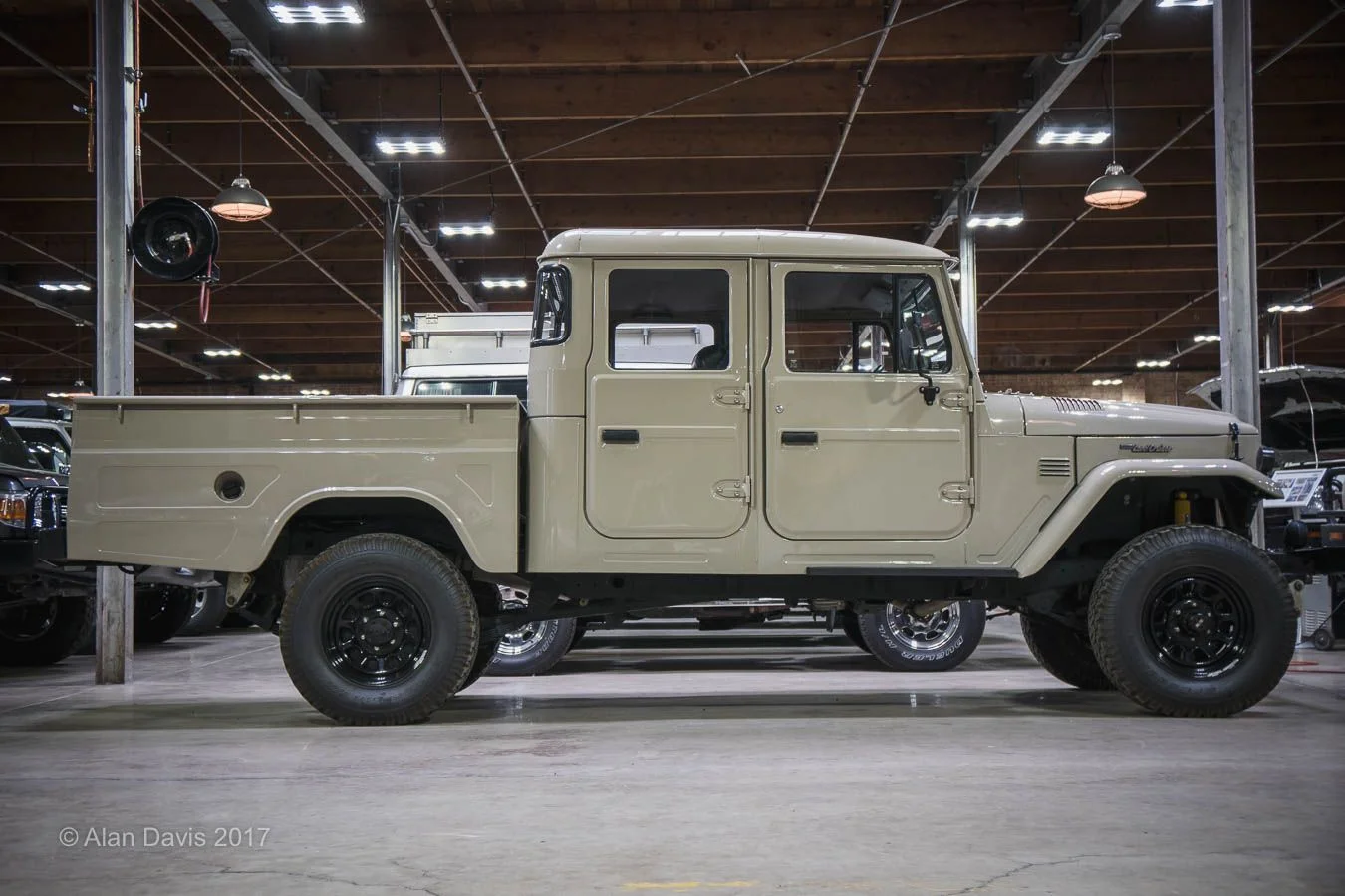

Dream rigs... here is one of my favorite pics...

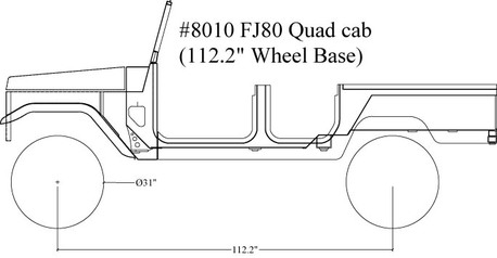

The Aqualu 4 door 40 tub has a 80 series wide option but not in a 4 door 45 option.
You can put a 45 crew cab soft top on that 4 door Aqualu 40 body, the back of the top will land on the axle.

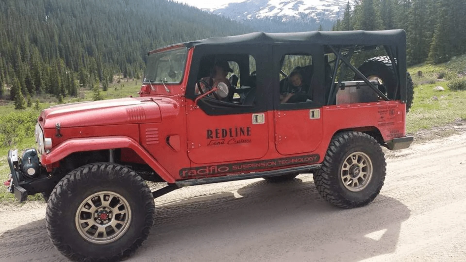

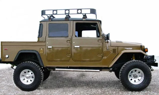

here is a 4 door 45 hard top, but picture it as a soft top.

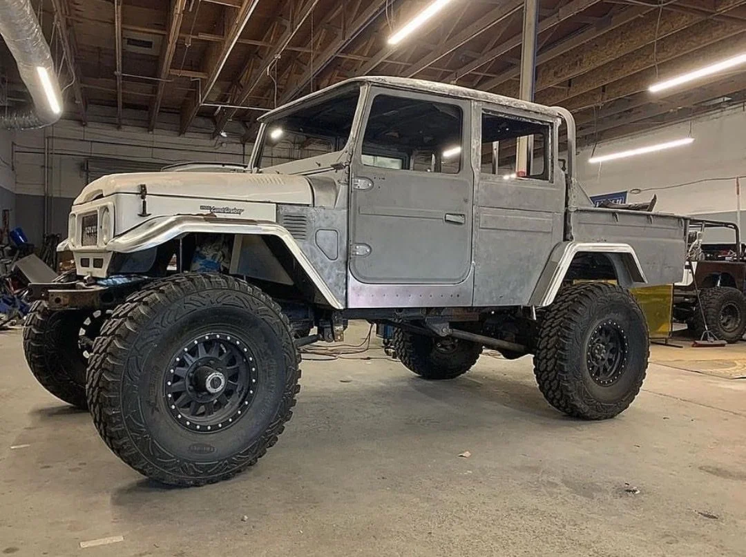

Truer words have never been spoken. Building one now from a 2 door 45 rust bucket. Been going on 2 years now. It's getting there but not fast enough.
