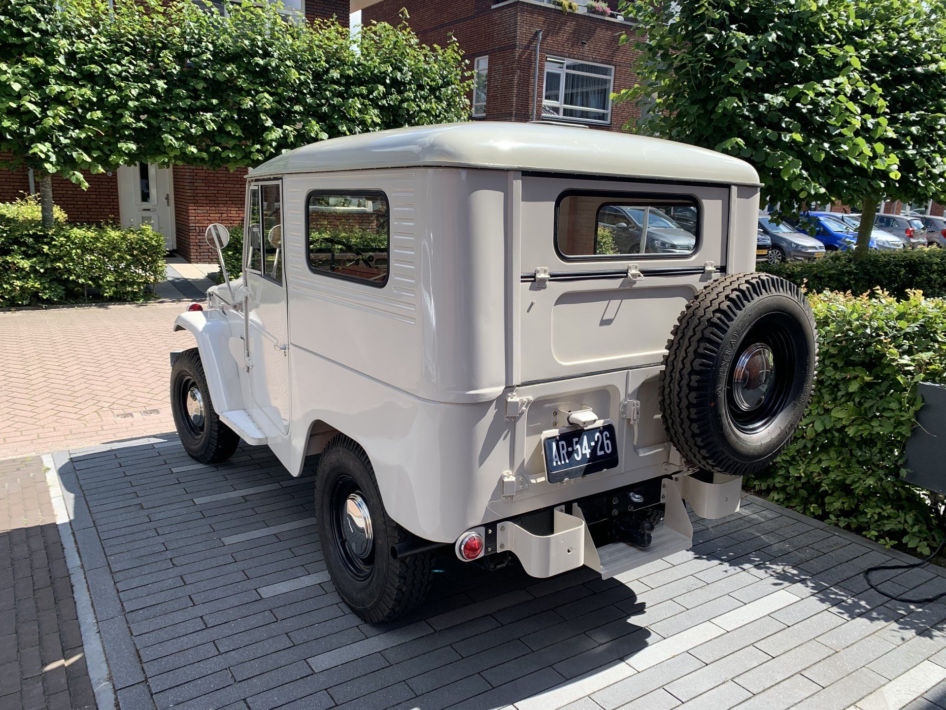

the engine is replaced but you have the stock carb. The gearbox has been three on the tree. The top and rear hatch is stock. So is the spare wheel. The pintle hook and specialy the trailer socket are highly wanted!

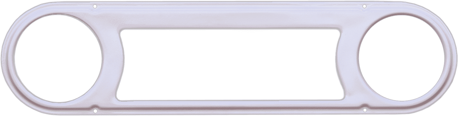

BTW Do you have the stamped bezel?
For inspiration: this is what you can make of it;)
What is the pintle hook and trailer socket? What do you mean by stamped bezel??
