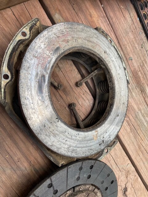

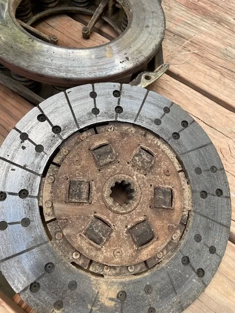

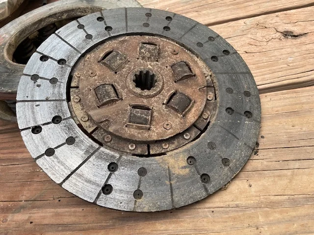

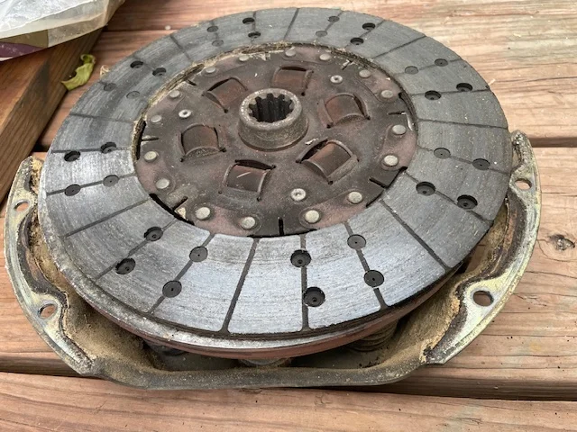

Prioritizing the prep more before continuing the clutch replacement. Took the advice of one of the experienced people on here and called the tech line of the mfg of the replacement clutch. That turned out to be good advice. PB is right, we don't have to remove the bellhousing but the tech recommended it. Wrote about 15 steps from the mechanic on the tech line, and also found this video of removing the bellhousing. Not sure if he is doing it right but it shows at least what bolts to remove. For other people in noobland, make sure to put minimal grease on splines of input shaft and clutch disk. Just enough to make it slick but not visibly greasy. If any grease gets on the clutch disk it ruins it and has to be swapped again according to what tech line told me.
Why do you have to remove the bellhousing? Are you doing more than a clutch replacement? The bellhousing is part of the motor mounts. All the clutch parts slide out of the bottom of it. You rotate the flywheel to get to the bolts. Did the tech you talked to ever work on a 40? You should remove the flywheel so you can get it resurfaced. Fyi, I didnt
watch the video.
Why do you have to remove the bellhousing? Are you doing more than a clutch replacement? The bellhousing is part of the motor mounts. All the clutch parts slide out of the bottom of it. You rotate the flywheel to get to the bolts. Did the tech you talked to ever work on a 40? You should remove the flywheel so you can get it resurfaced. Fyi I didnt
Watch the video.

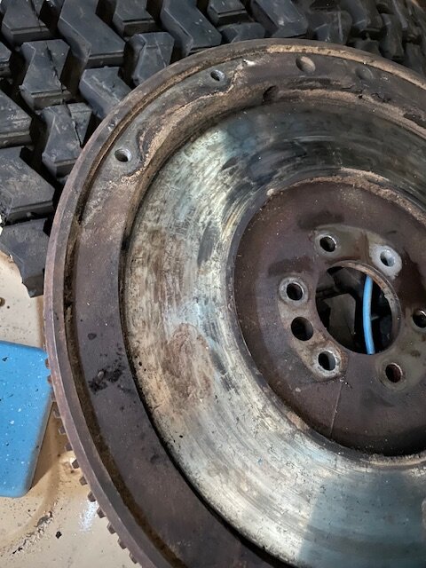

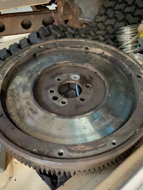

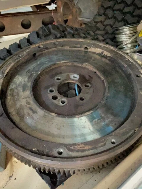

I'll call him again tomorrow and ask him. I'm just going to get the pressure plate and possibly the flywheel out tonight. He told me to hit the flywheel with some fine sandpaper and clean it off with a rag sprayed with brake cleaner. Also to spray some brake cleaner on the pressure plate and clean it. Check for burs on input shaft and bearings. 40channel removed it without removing the bellhousing. I dread undoing the motor mounts if I have to. Trust me I'd rather not mess with that if I don't have to. He was trying to tell me that the larger rounded side of the throwout bearing points to the pressure plate (aka away from the clutch fork and retainer hub. Does this sound correct to you? I'm not replacing anything beyond the clutch. But I do intend to take tranny off again to put on some new seals and gaskets.
Theres no reason to remove the b/h. You'll just be bolting back on. If the flywheel doesn't have ton of hot spots, and is true, cleaning it up might be OK.
Worked just like 40Channel and @pb4ugo said, it's actually pretty easy to get out within the bell housing. These wasps need to start paying me rent. Ordering a boot for the fork. Going with professional resurfacing.

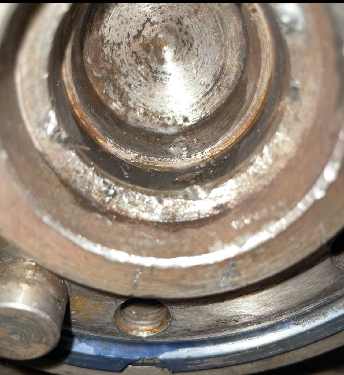

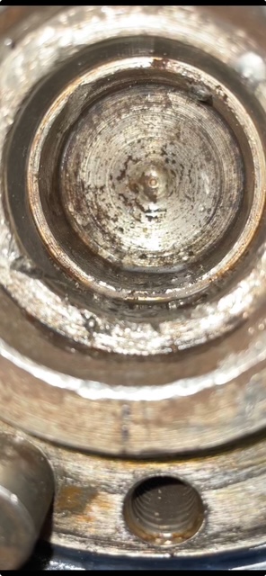

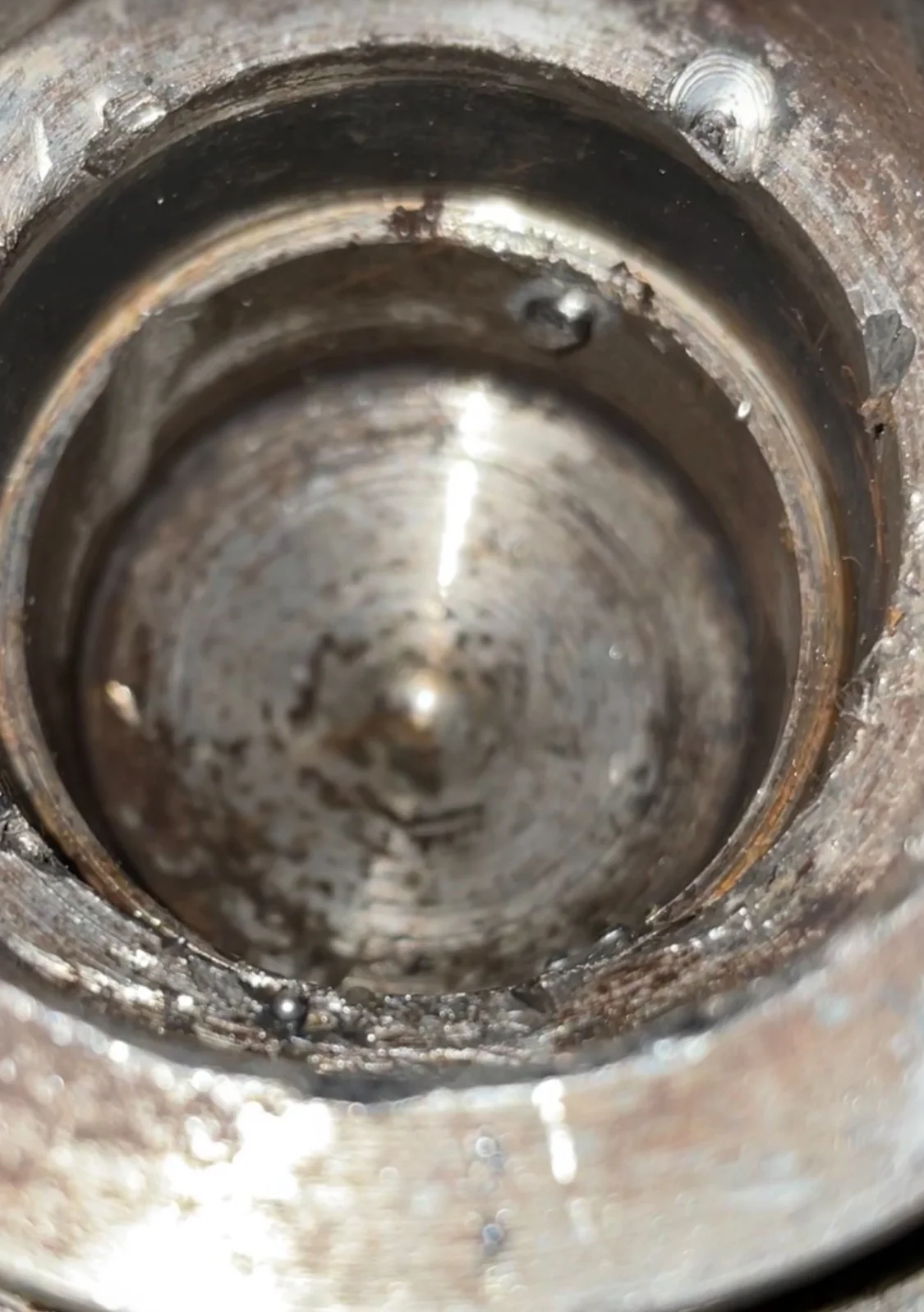

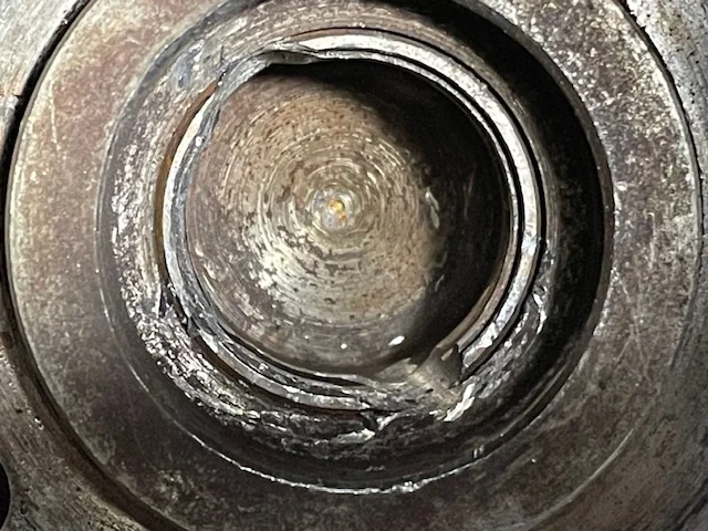

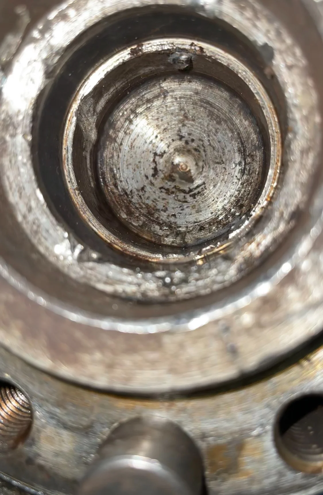

Anyone have any suggestions on removing the outer race of the pilot bearing? Besides torching, Dremel, and WD40? Will attempt welding and etcher next.
Maybe a Dremel with a ceramic cut off wheel/dask doing 2 deep groves on a slant, then whack it with a chisel to make it split.
Maybe tig a few lines to make it shrink up.
Noob question but rather be safe than sorry since never done this before. Does this still look safe to use with it being nicked at the bottom? The welder did the trick for sure. No need for a slide hammer. Used the cutting wheel on the Dremel which is what nicked the bottom a bit. The other spot on the bottom is from rust from how it looks. Everything else seems to look smooth where the bearing goes.
