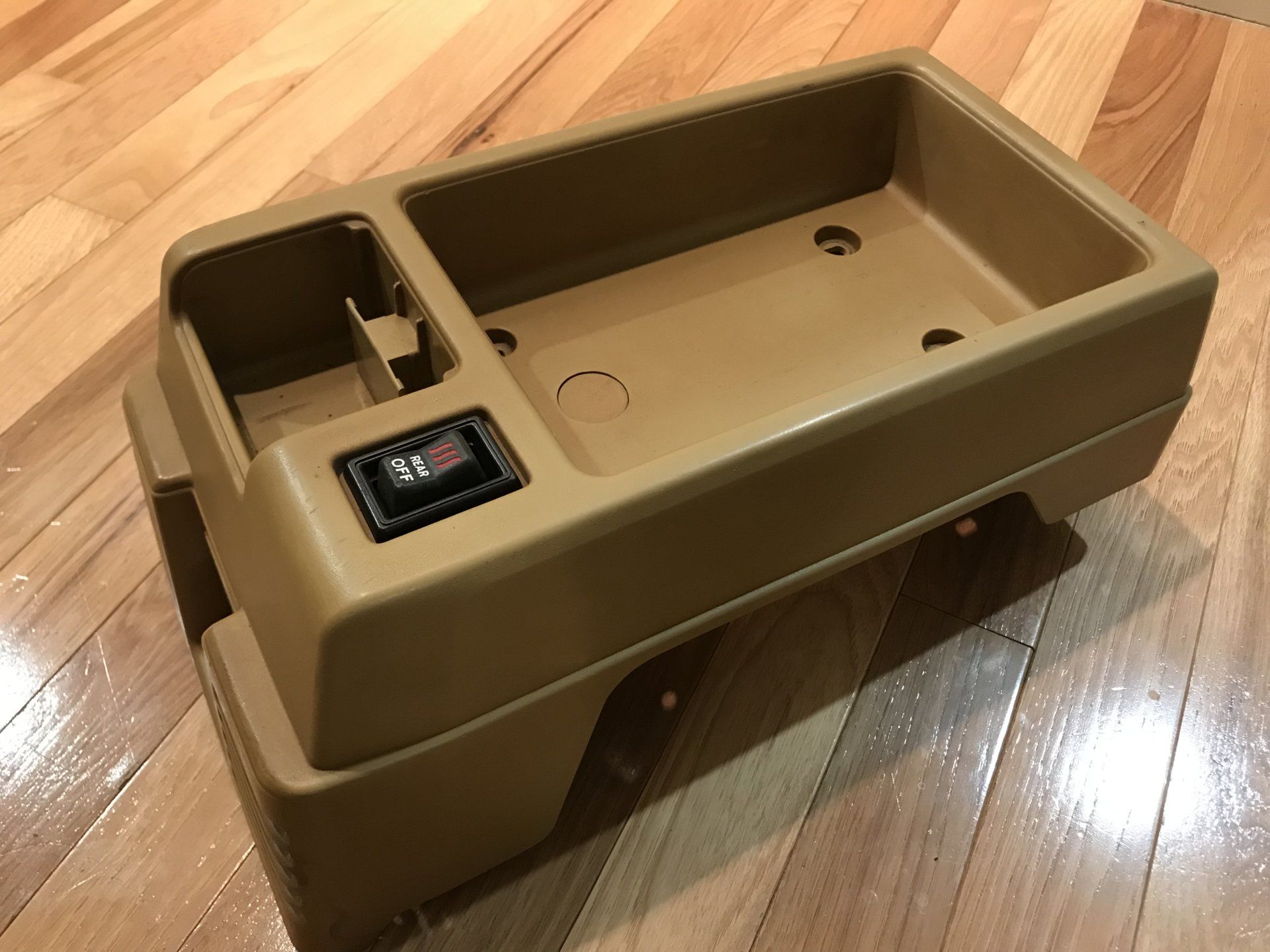

I've had a 77 with the external mounted rear heater and that one really cranked out the heat. I now have a 1981 FJ40 with the rear heater inside/under the center console and it doesn't blow for $h!t. I'm wondering if that's normal for these or if I should pull and take it apart to clean up and lubricate?

They get pretty warm and I can feel a little bit of warm air coming out of the bottom of the 2 rear vents but to say it's blowing out would be a lie lol.

if both of the hoses/pipes are hot and you are saying it is an air flow thing,
you'll need to remove the console and get to the fan, either it is not spinning fast enough or most likely the heater core is plugged on one side or the other from accumulated crap and needs to be cleaned
Blow the fins out. I had a rear heater that would get hot but would not transfer heat. I washed it out and the fins were caked shut with mud. At some point in its life the truck got wheeled hard in some mud and it got into the cab and clogged the heater core up. It looked OK from the outside but was almost a solid brick when you got down and looked at the fins.

Ok, yeah that's how my 77 was. From the "looks" it appears the thermostat has been changed, all the housing is clean and new, my front heater blows pretty hot.

Alright wow !! This one spent it's first 30 years in Cali and then Seattle so who knows how much use it got but being in NE Ohio it's a requirement now Lol. I ran it today for about 40 minutes the front heater was blowing hot the pipes/hoses going to the rear were warm not super hot of course the insulation is very good on em though. I'll add rear heater removal to The List :-) Thanks again !

Yes it does and it's open, if I put my hand on the floor by the rear vents I can barely feel warm air, so this appears to be more of a blower fan/air flow issue.
Funny thing is none of the pipes feel really hot, warm yes but not to the point that I can't keep my hand on them.
That tells me that the heater core is also clogged up, not allowing hot coolant to flow through the proper way. Both lines should be hot if it is working correctly.
