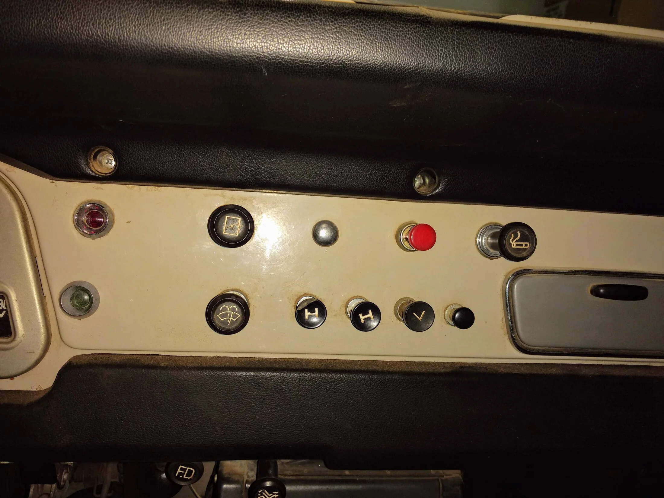

Show us a pic of its location on the dash and what it's connected to.

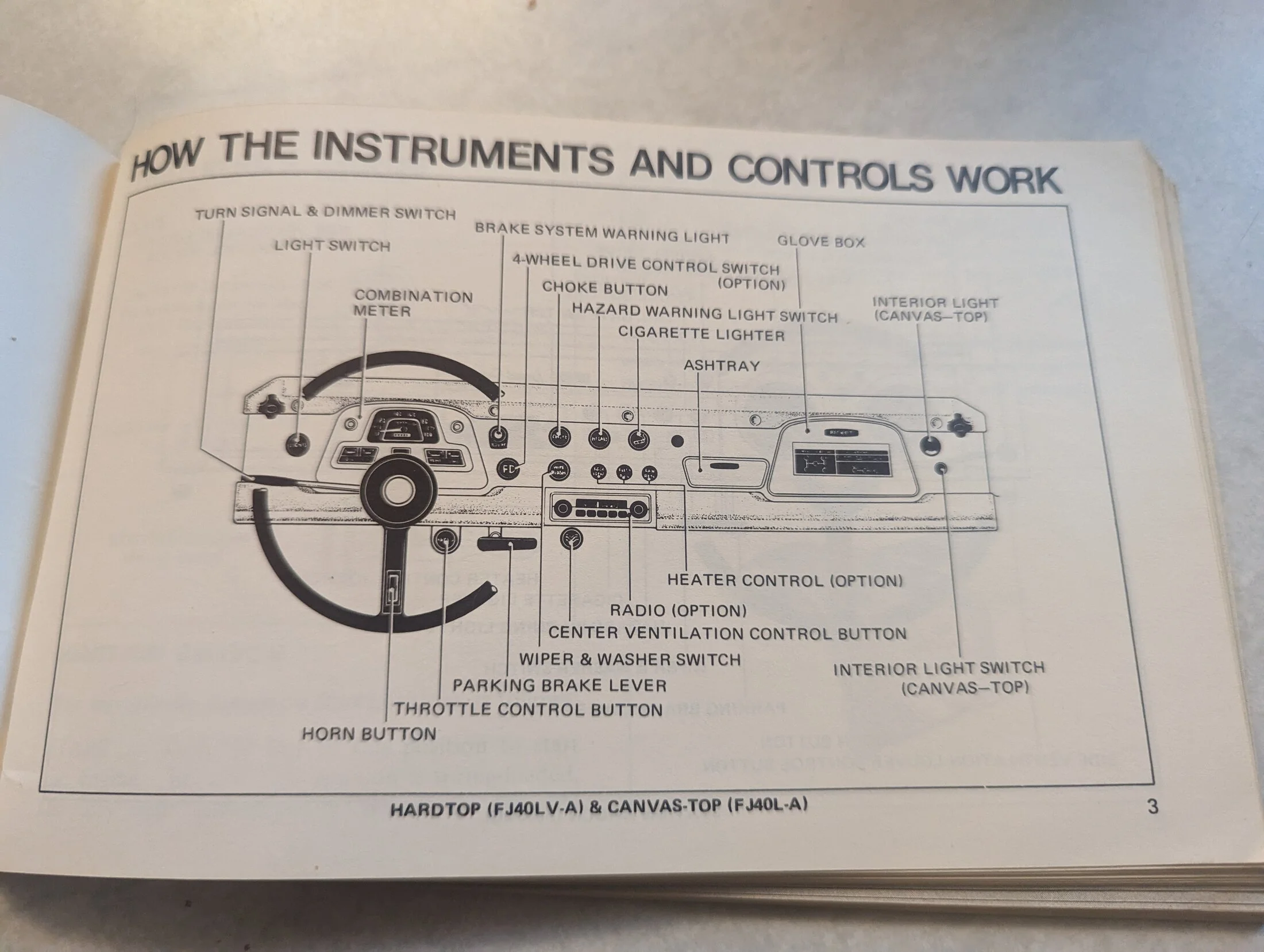

Do not believe you have a 73 model. Possibly a early built 74 model. Heater with the vent on top and valve to control fluid to the heater coils started with the 74 model. 74 model did not have a separate knob for the rear heater. High speed on the front blower turned on the rear heat.
73 owner's manual.

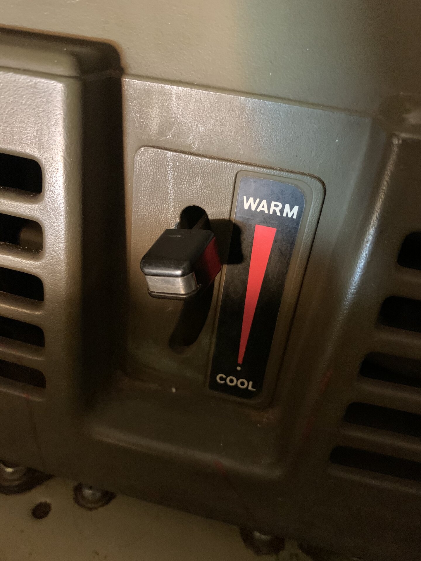

Your dash is just like my 75. That silver knobs setup isn't stk, what's it hooked up to?
What @Living in the Past said. Warm pull manually opens the water control valve mounted on the other side of the firewall. and the fan knob......well.
