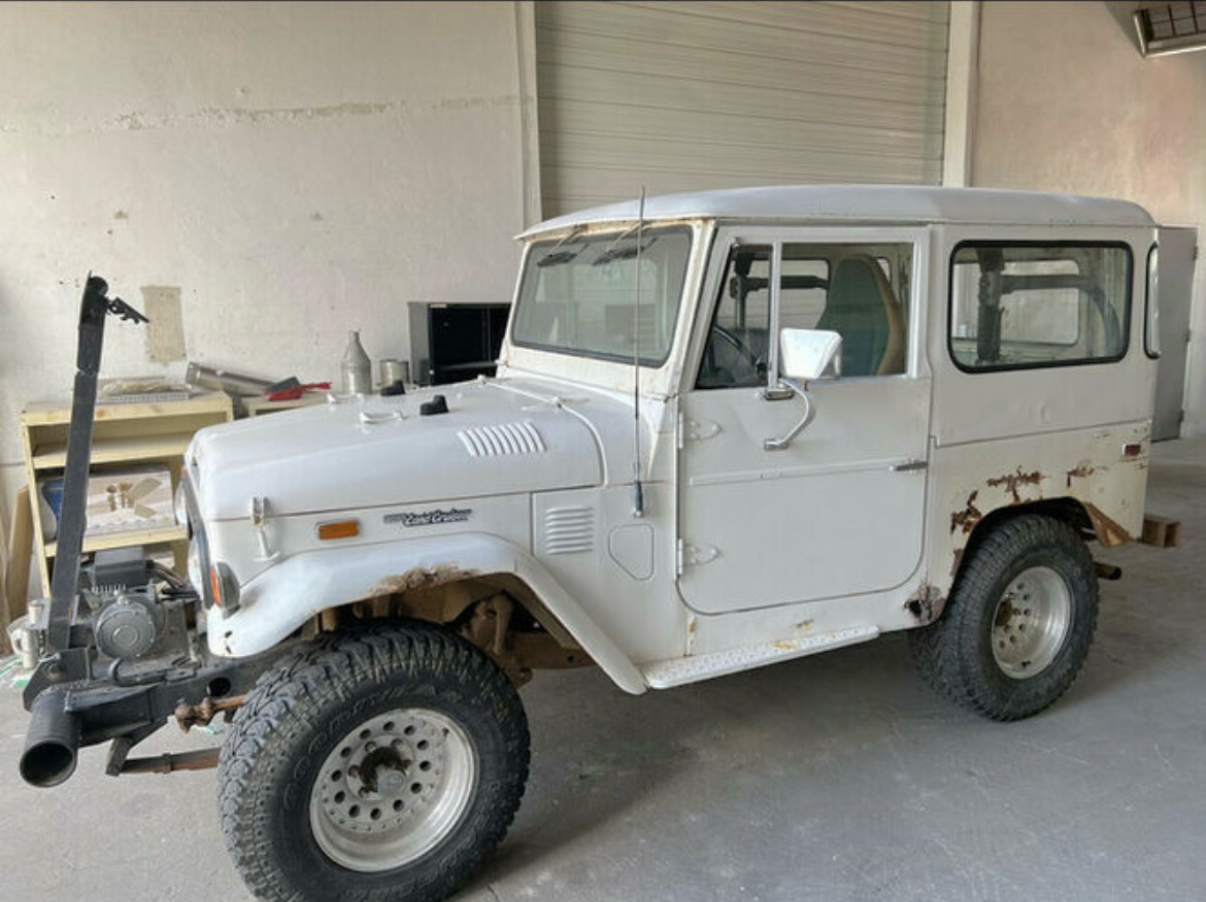

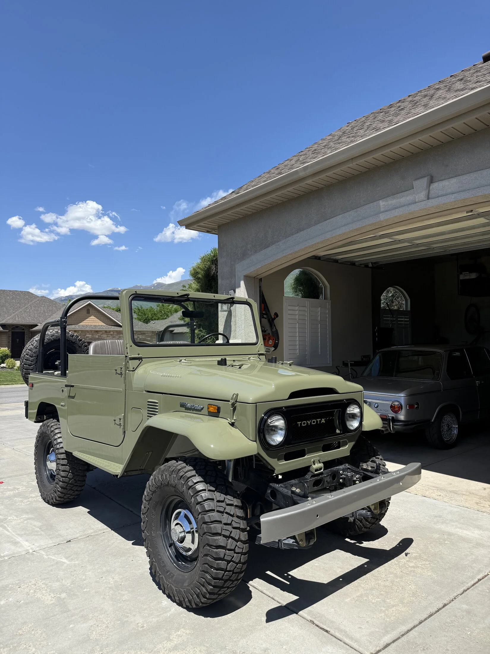

Also included a before and after. I was pretty meticulous in this restore. I did not however get into the differential itself (besides oil drain and refresh).
