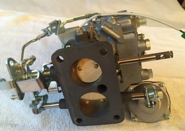

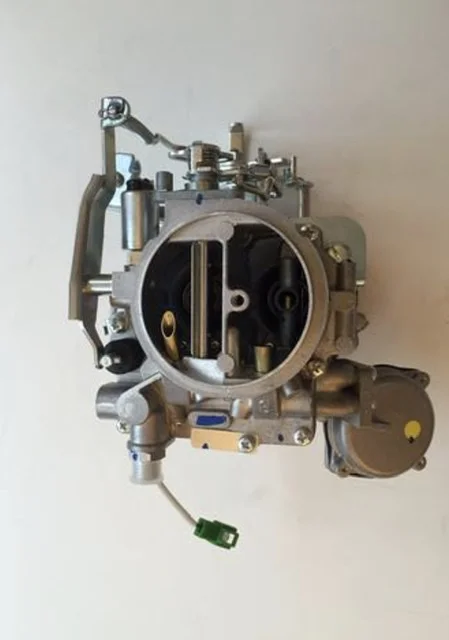

I found a Non USA Genreal Markets NOS 21100-61010 OEM NOS carb which was originally on my truck in 4/1976 according to this parts link. I’m now running an aftermarket H3662 version of 21100-61012. What are the differences between OEM # 21100-61010 vs OEM #21100-61012?
My distributor is small cap vacuum advance non USA #19100-61010 link here
Anyone have a point of view on which one to choose for my application if I want to go with an OEM carb.

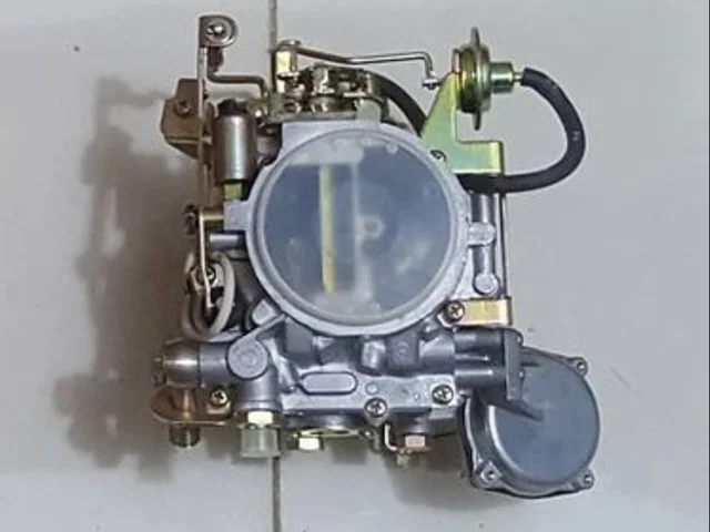

The biggest functional difference I see is that the 21100-61010 has a choke breaker that the 21100-61012 does not have.
Thanks. I’m not familiar with the purpose of a “choke breaker” on a de smogged 2F with a manual choke. I’m leaning towards replacing with
OEM 21100-61012.
OEM 21100-61012.
It is for drivers who forget to close the choke knob after warming up - it forces the choke to open

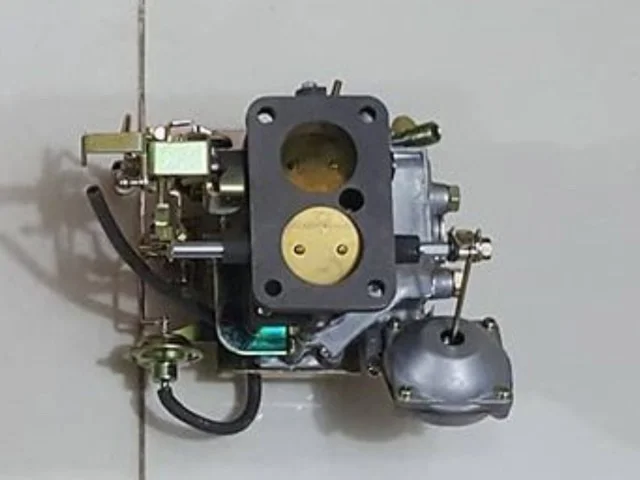

I think the jetting is quite different from the 61012, as well as the choke breaker.
Best I can find (but haven't verified) is the 61010 primary is 1.44 / 2ndary is 2.30 as these were 2F World non-smog carbs on both 40s and 55s.
Don’t forget the height difference.
