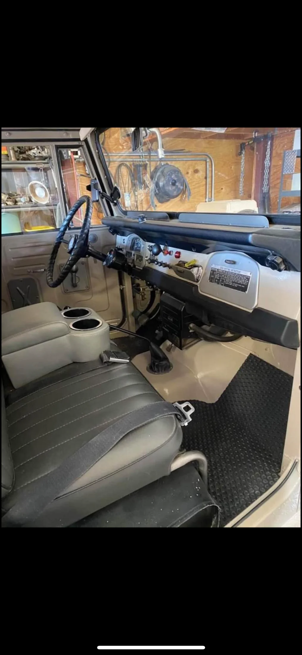

Hello folks,
I’ve benefited from this forum for many years, but haven’t posted a question before. I’m not very tech savvy, so I’m sorry if I’m not following protocol.
My question is about installing a Vintage Air Gen IV SureFit on an FJ40 with dash FD vacuum pull lever. I’ve reached out to Vintage Air, but they haven’t been able to advise me on this install. The vacuum lever obstructs the install and I really don’t want to convert to a floor shift (I know it’s crazy, but I don’t want to modify it anymore than absolutely necessary). Has anyone figured out a workaround? If you’ve done this before, you’ll probably know immediately what I’m talking about.
I am heartbroken that I have to make this modification, but I’m unable to drive my beloved FJ in Houston due to the heat. I love operating this time capsule, but the heat is honestly not worth it for me anymore.
Thank you,
-Cooper
We notched the Gen IV plenum around the pull and glassed it shut. I’ll see if I can find a pic.
Another option- albeit a ton of work would be to use an Old Air Hurricane evap in the cabin and then Use the Vintage Air in the engine bay.
Awesome! Thanks for the quick reply! I’d much rather modify the Gen IV than the FJ.
