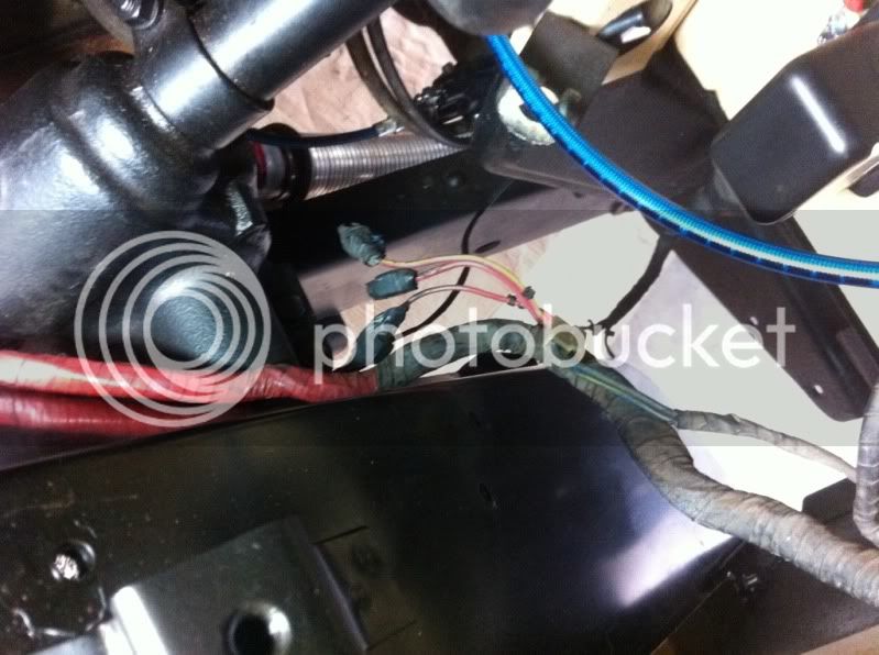

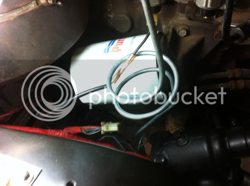

I got the exhaust all fabbed up and that fixed all of the off idle hesitation. She runs great now, I also hooked the aftermarket voltage regulator up and it showed a positive indication on the ammeter for about 2 miles then it went back to a negative draw like before it was connected. Do these fail often or did something else go wrong? I still have a lot of disconnected plugs and no idea what they go to. There are at least six wires per side and a plastic plug going no where. Any ideas?

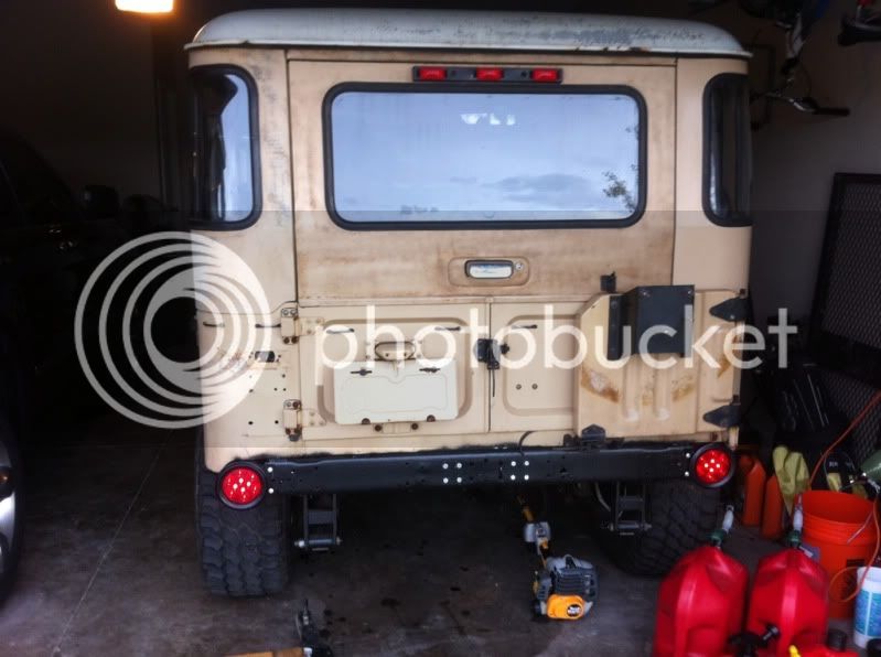

New brake lights are in and wired. And they work!

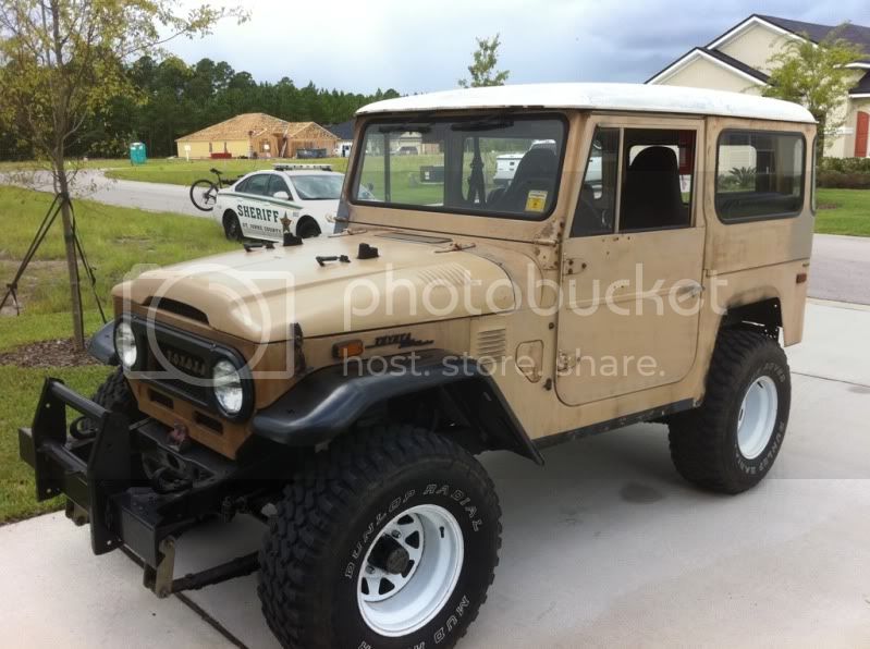

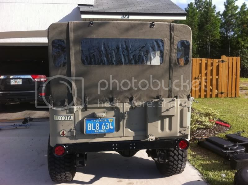

Made a few key purchases today; a feeler gauge - to properly set the points gap allowing the motor to start without ether and run better than I've ever seen it run, a vacuum brake bleeder - totally worthless... I ended up sticking the hose into a water bottle of brake fluid and all four corners bled in 30 minutes, and a can of seafoam - not sure if it's doing much just yet. I picked up an antique tag for it and we took it for it's first trip outside the neighborhood. It was a good day, oh and the soft top was delivered and looks great. I can't wait to get this hard top off and get the Paki on. Any tips on the removal?
Obligatory first trip to the gas station shot

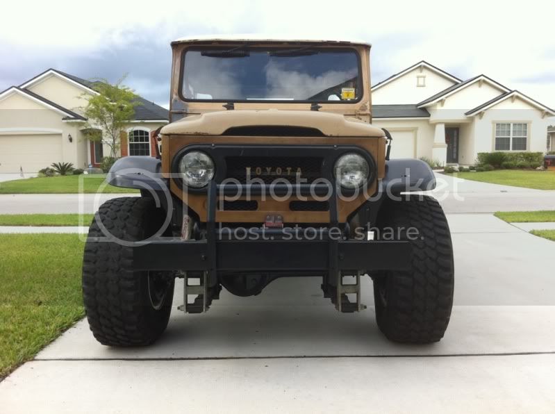

Fuel pumps leaking pretty bad, I probably should switch that out before it burst into flames. I guess it's time to move onto bodywork and paint. I'm planning on installing the Paki top this week and ordering some stockish wheels+33x10.5x15 KM2. Anyone need some 75% Tread dry rotted 33x12.5x15 And a hard top?

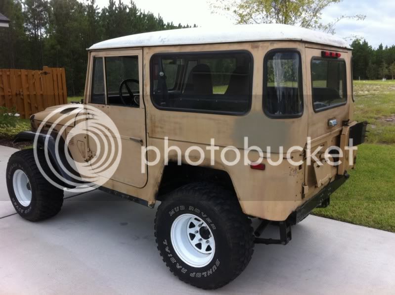

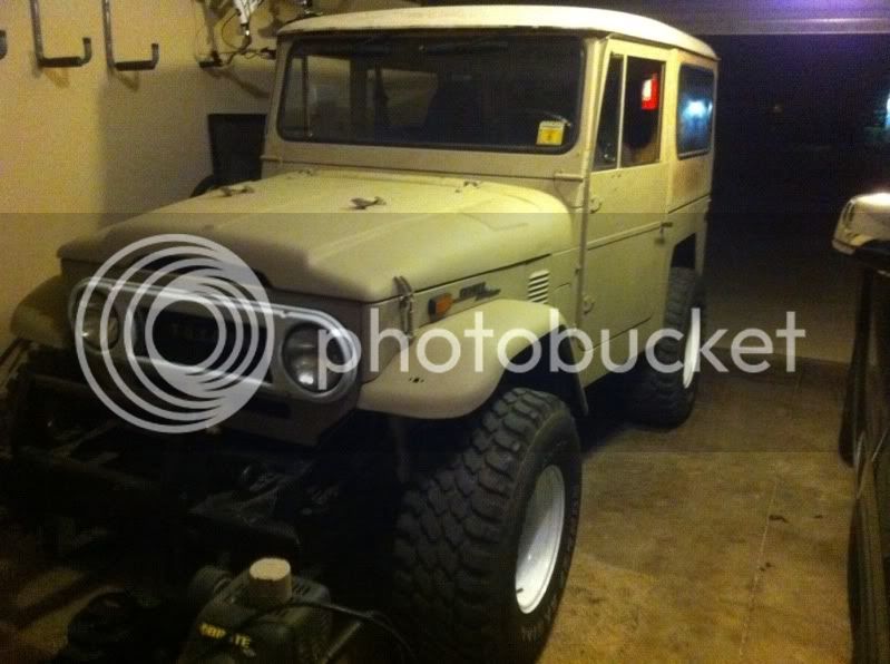

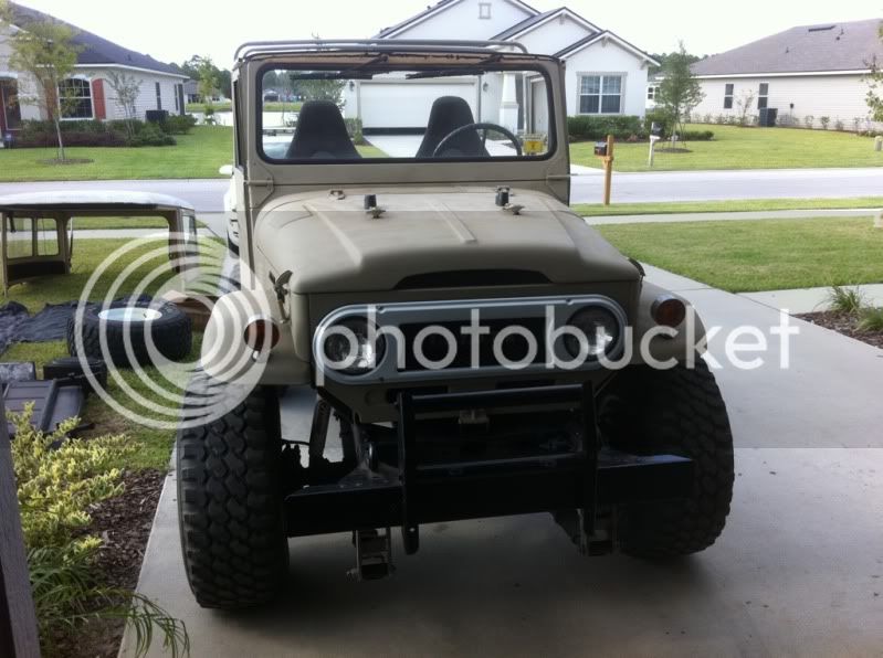

After a whole day of sanding, priming, sanding, priming, sanding, painting its now all one color. Went with rustoleum khaki after stopping by a few local paint places that wouldn't even look at it for under $3k. It took all day but turned out pretty well for $50. Didn't do the top since it's coming off later this week when the Paki top goes on. Crappy nighttime garage shot.
Oh POs, why!?

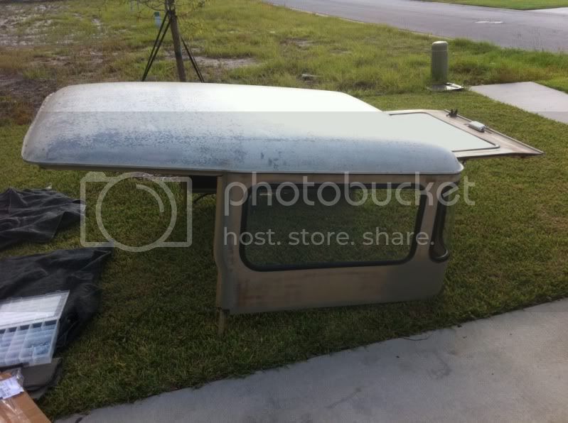

I spent about an hour fighting the top until I remembered to loosen the striker plates and it poped right up.
Defenitly get at least another person to help you lift it off, it's a beast. Where the hell am I going to put this damn thing.

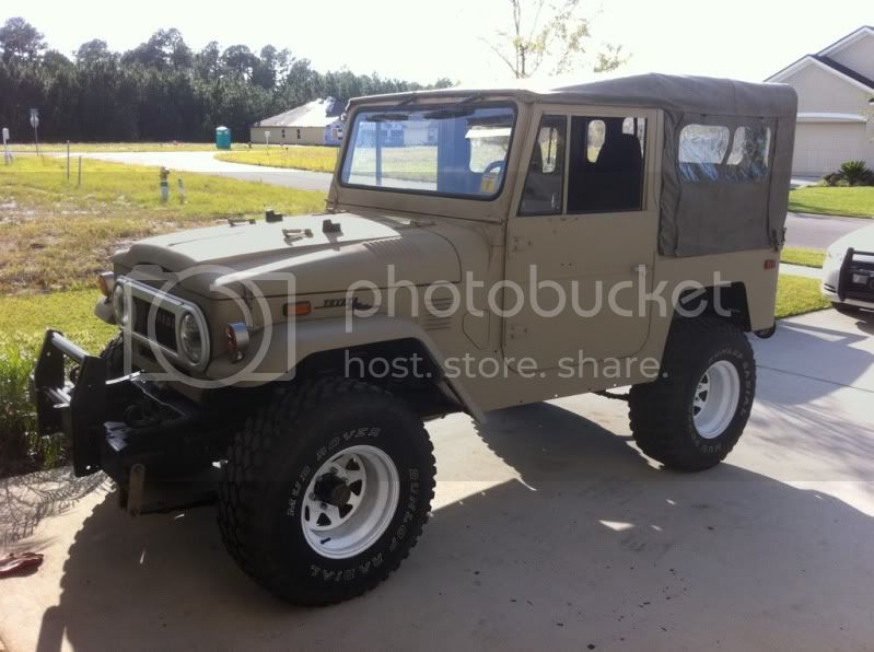

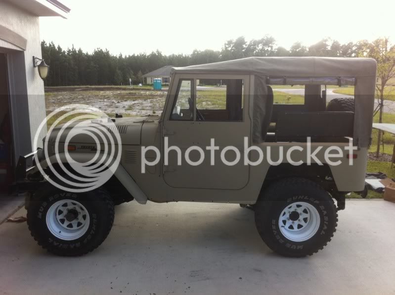

Bows on and looking good.
Top went on pretty easily, just laid it on the hood and started at the front working my way to the rear. Footman loops were all in the right place thankfully. Just got to drill holes for all the other fasteners to tighten it up and it will be done.
windows down.
Tightened this side since this pic

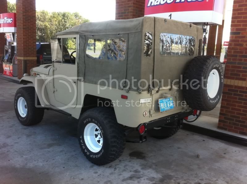

Much better gas station shot, lol.
The top was in a box for who knows how long before it went on so I left it out in the sun hoping that it would unwrinkle a bit. It's a little loose as well so I picked up $4 in pipe insulation for the bows to stretch it out.
New running boards are on too, sure makes getting in and out easier.* Actually running it daily it starts instantly, but the fuel pump HAS to be replaced asap though. Carb rebuild kit is in, so that should keep me busy. There is a huge difference in rigidity going from hard to soft top, I can feel the whole 40 twisting around every turn.

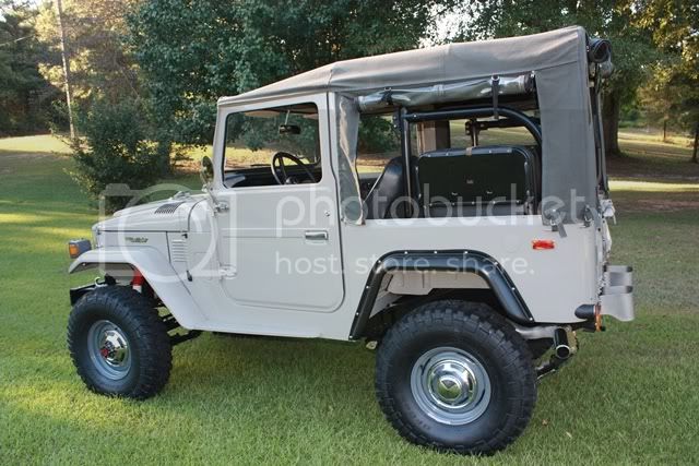

CFO keeps bitching about the tires so I need to make a decision. 33x10.5 bfg km2 or 34x9.5 SS tsl ? Both will go on stock rims, where do I get them and will the 74'-up rims work? There is some random website selling them for $75 each. Or I can spend $122 a rim from $OR for the 72' rims
just ordered 75' - up factory steelies so i can do a disk swap later, hubcaps, and a set of 33x10.5 BFG MT KM2 should be here next week!
That's EXACTLY the setup I was going to recommend. FYI, they come primed black. You'll need to paint 'em gray. Best bet on wheels is usually your local dealer because they won't charge shipping.
They are stock and worn out. They will be replaced shortly with anti inversion shackles and a rough country 4" lift. The top and bows were $1600 from a fellow mudder.
