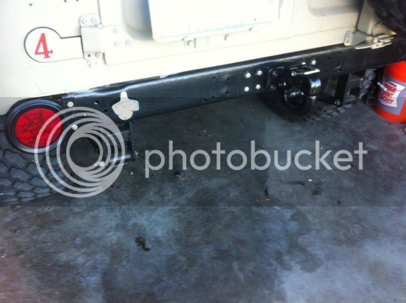

Forgot to post my best mod to date
No not the pintle or LEDs, look closer.

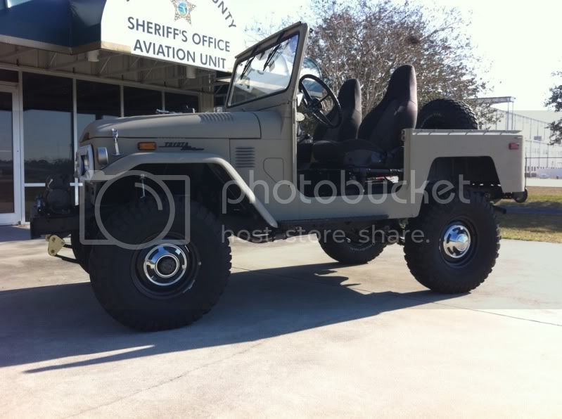

I've now got an 86" fj40 in a 82" garage

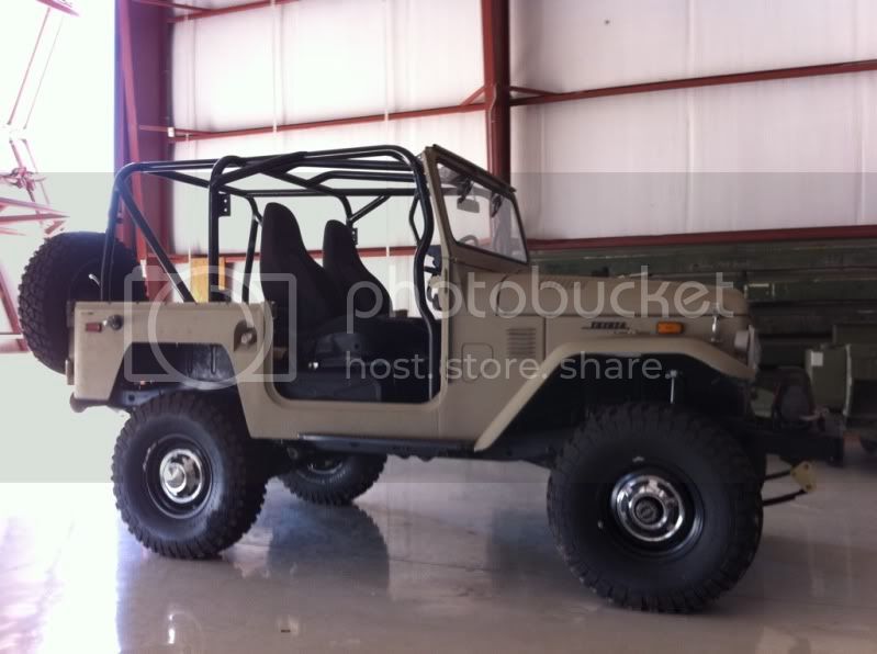

Front of the lift is done, took about 4 hours for the front and 5 for the back by my self. I doubt it would have gone much quicker with help, if anyone is thinking of doing it themselves.

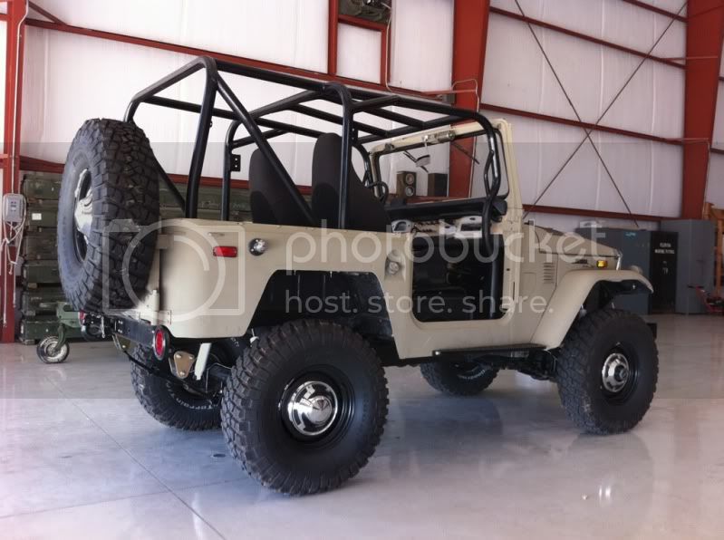

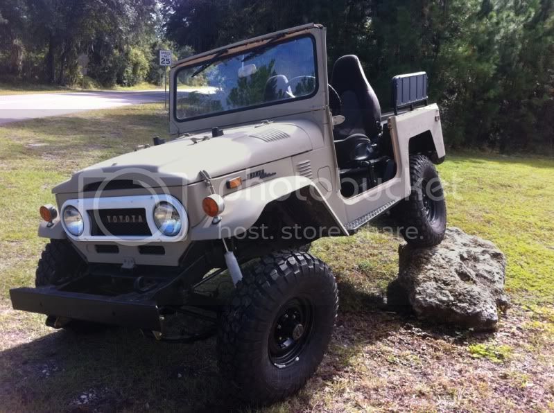

Still a little tall at 5" up front and 6" in the back. I'm still about an inch too high to get it back in the garage.
I took it offroad for about an hour trying to get it to settle, but I think it will take a while.
I kinda like the look with no caps, kinda wish I held off on em.
Driveway is on a slope, 40 is actually pretty level.
PO included a full car cover with the sale, I'm going to try it out and see if it's water tight tonight. If it's dry tomorrow I'm going to keep trying to get it to settle. If it leaks the tops coming off until it drops an inch.

Took the hubcaps off too, I think it looks a lot meaner.

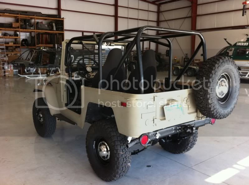

powdercoat took a couple scratches during the trip but for the price i cant complain. it will go in friday and hopefully the frame tie ins and hip guards will be here shortly. i plan to fab a seat cradle up and put some scat seats in if i can find a good deal. i also need to fab some brackets to put the troop seats back in.

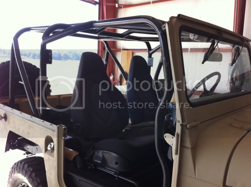

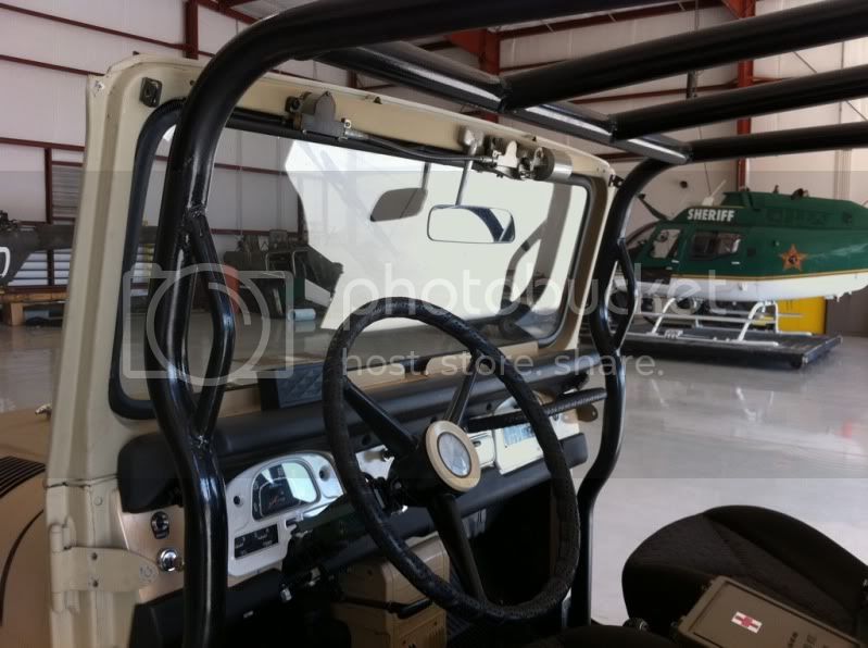

install was pretty uneventful, i used an engine hoist to lift it up, drove under, and dropped it in. it lined up really well, i just cut the carpet out from under the front feet, drilled the holes and bolted it down. once the frame tie-ins get here it will get unbolted and welded up.
damn you Rough Country! when will your stupid rear springs settle an inch? still too high

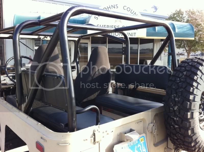

really hoping i can fab up some brackets and feet for my troop seats, i refuse to go to a forward facing bench, the troop seats make it a 40! but they are going to be really close together...
http://i80.photobucket.com/albums/j161/nickswan/86f11e8d.jpg

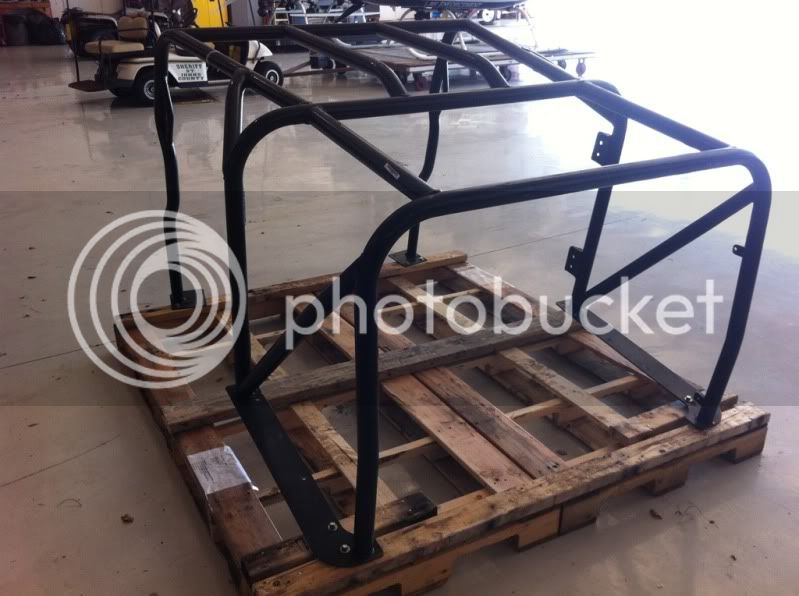

MT makes a hell of a product and i gotta thank fellow MUD member "Bang Bang" for such an awesome deal on this cage.

I plan to get the Paki top put back on this weekend, hopefully the doors and bows dont have any fitment issues. the overhead bars stick up a lot higher than i expected.

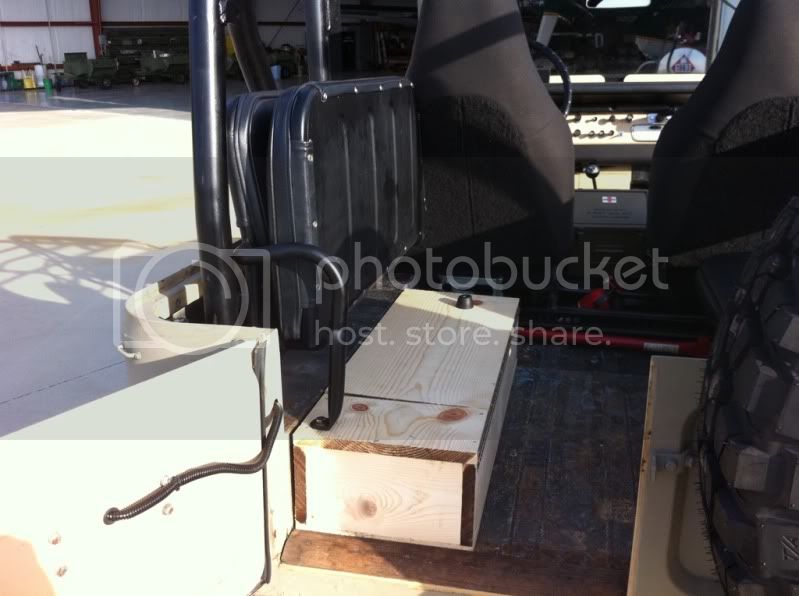

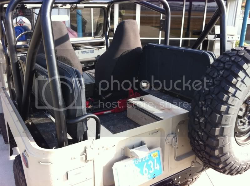

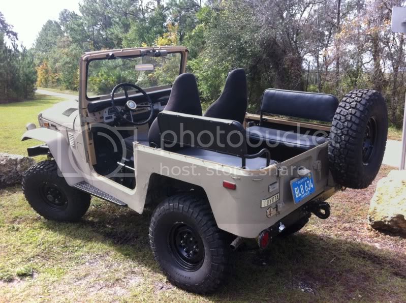

Troop seats are in!
I built some storage boxes for under the seats
They should hold all my tools and recovery gear. They are not quite finished, I think I'll use a cheap truck bed coating for now until I get the whole tub coated.
Looks great! I'm not sure what to make of the "Safety Third" on the winch though...
