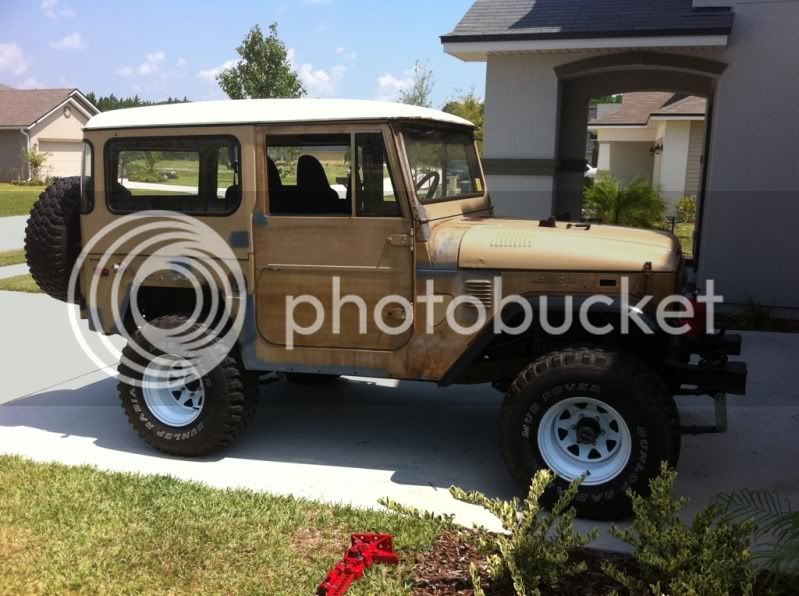

if you look at the driveway pics you can see the "sweet" lift the PO put on it with the longest shackles he could find. anyone know if $OR is the only source for stock length anti-inversion shackles? they seem to be the only place i can find. this 40 is going back to stock height and five of these are going on.

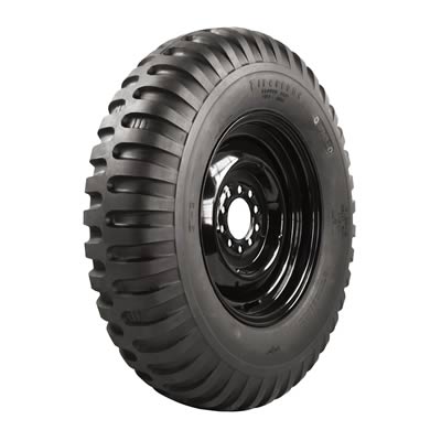

this is more of the look im going for and these tires are under $100 and from what ive read feel like you have power steering. obviously they do have some wet road issues but honestly this thing is going to the beach and wheeling 90% of the time.

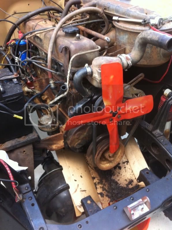

How not to swap water pumps...
Looks like my donor motor had an AC option in '73 and my parts motor didn't in '72. The '73 has a double pulley for the compressor and the '72 doesn't, so I had to stack some washers to move the fan from hitting the crank pulley.
Luckily a little heat, PB, and vice grips extracted the two broken bolts. I tapped em to clean em out and mounted the donor pump with some 1 minute gasket maker. Seams to be holding tight so far. I ran it for 10 minutes and finally changed the oil and filter, as well as antifreeze.
