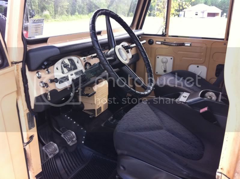

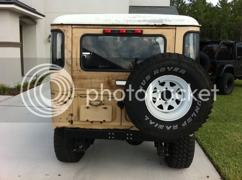

Welp, no need for video... nothing good to report. we pulled it in gear through the driveway without it budging, so we decided to pull it and drop the clutch at increasing speeds starting with 5mph and going up to 30 mph to no avail. after the first drop at 5mph it locked the wheels, skidded for a foot or so, then seemed to break free and roll... we're thinking it was the clutch finally slipping on the flywheel because the motor is still frozen in the exact same spot. more than likely we are guessing the PO or PPO welded these cylinders shut via oil starvation or worse. we cant see any gaping holes in the block with broken rods hanging out but we just wont know until we tear into it. good news though, the new motor will be here sunday and I hope to have it ready to swap by next weekend. If this thing is welded shut I am assuming its scrap as well as most of the internal components, correct me if im wrong.

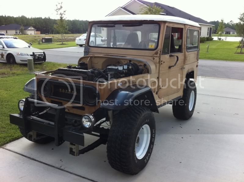

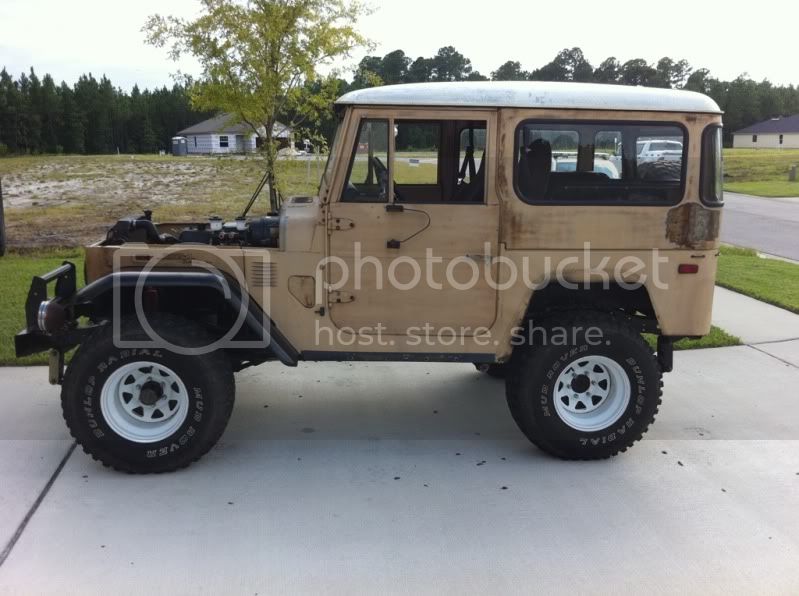

On a lighter side i was able to snap a few cell shots of it in the driveway.
I know sexy, right?
Looks good! You'll want to check underneath the carpet for sure for rust. Is that a stock color or is it a repaint?
The ride looks SWEET (well other that have'n a boat anchor as a motor). Wish mine looked that clean!

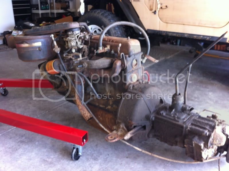

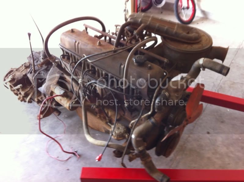

here is my new 2 ton engine hoist that cost as much as the motor its lifting.

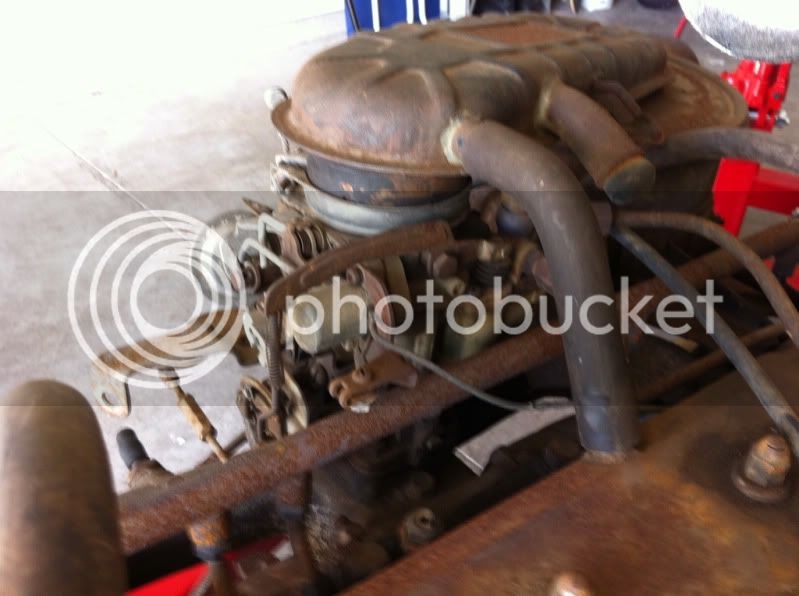

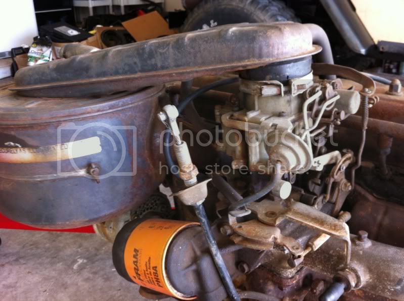

anyone know if thats an Aisin carb and oil bath filter? it feels solid, shifts well, and weighs a fxxxing ton. hopefully it will be in place this weekend, any first engine swap pointers?
i plan to degrease and scrub it down tomorrow as well as swap over some of the accessories. i assume thats the stock exhaust manifold. im also assuming i dont see a lot of those on 40s for a reason. anything i should do now before i shoe horn it in that will be much easier now?
That sure looks stock to me.
Did you turn it over and check the compression?
I'd also check the clutch while it's relatively easy to access. Way easier to replace now than after the engine is in.
Get rid of the metal fan.
