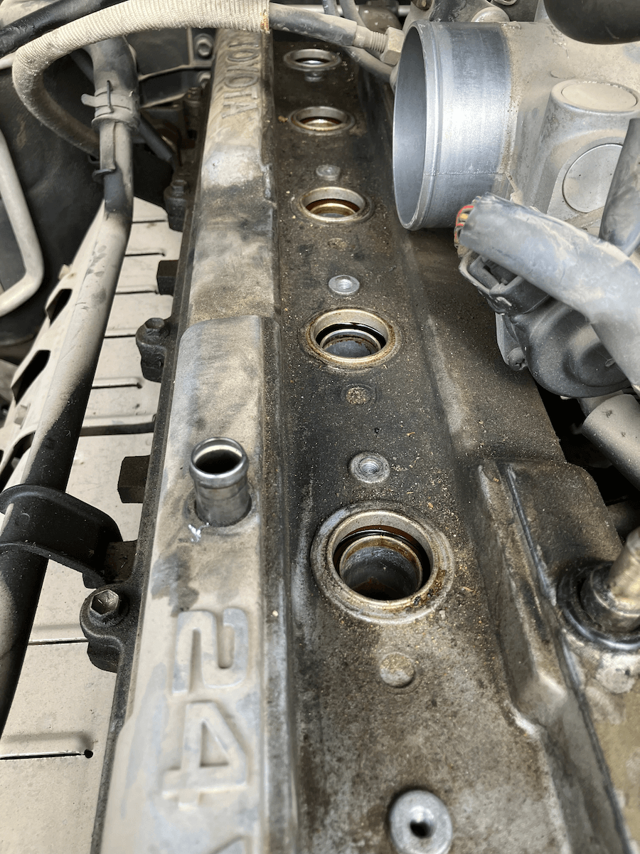

Just finished up the compression tests (cold engine), a little bit confused:
#1: 171
#2: 165
#3: 165
#4: 140
#5: 162
#6: 160
One mechanic told me I had a misfire on #6, another told me I had 98% leak down on #1. I ran each cylinder like 3 times to make sure, but this isn't all that complicated to do. I did notice in the top of the spark plug holes some fluid in what appear to be the spark plug wire gasket or something (not sure what to call it). It's the brown stuff in the picture below, kind of hard to see. Also have pictures of the spark plugs, #1 is far left #6 is far right.
Only thing that concerned me was the gas spraying out as I was doing the compression tests. I was doing it by myself so pretty hard to tell where it was coming from, but I think mostly cylinder #4 and some of #2. I have a video but you have to look really closely to see it.
Not really sure where to go from here, the fuel injector route seems probably the most reasonable. Worth it to still do leak down? I kind of want to on cylinder #1 since one mechanic said they did it on that cylinder, but with 160psi it just seems dumb. My heater control valve does look grim, it has a bunch of crusty stuff leaking out of it, definitely need to replace that.
None of your spark plugs look steam cleaned so that may indicate the headgasket is sealing OK.
If there was a leak on an exhaust valve, I think you'd see that in the compression numbers.
Did you test the ECU coolant temp sensor with an OBD reader? It really could be that simple.
With those compression results, and if the ECU temp sensor checks out, I'd put some money into fuel injectors given you are trying to solve an excessive fuel in the tail pipe issue. You can have them cleaned and tested at various places, I've used RC engineering for mine. Keep in mind it is possible for them to fail at high mileage, I've had that happen as well, had mine cleaned at 220K and had one fail (not squirting at all) at 330K. I replaced all six at that point. It's not cheap to get identical replacements.

My friend is saying do the compression test on a hot engine since I do have (alleged) 98% leak down numbers on cylinder #1. I was trying to avoid running the engine for 5-10min, but is there the possibility when it's hot and all the parts sit a little differently, that I could get drastically different numbers? And for cylinder #4, and 140 is a little low is that something that is probably the start of an issue? Or can just see >10% variance on 30yo engines?

Compression is decent. That won’t cause the misfire.
Injectors are a common problem for misfire.
Yeah definitely feeling like this is injectors, which is awesome engine seems fine. Would that cause the white smoke out of the tailpipe too?

Constant spray from injector stuck open can cause exhaust fogging. I have seen it before. A mechanic stethoscope can be used to listen to the injectors for clicking. No click. Replace ALL injectors so you have good power balance..
But have you done a coolant system psi test? What about a radiator combustion gas test?

Makes sense, leaning towards replacing all makes sense but will check for clicking. Haven't run either, didn't know about either, but will add them to the list that's great.

Odds are this engine issue is a bad injector wire or plug, not the injector itself. If a bad wire grounds out, it will hold the injector open.
You were supposed to pull the fuel pump fuse prior to doing the compression test so the injectors wouldn't have fuel pressure.
Inspect the wire harness near the EGR valve for burns or crispiness. This is a common area for wire failure and injectors to fail because of it.
With 171 psi on cylinder #1, you do not have 98% leak down on that cylinder. Again, that mechanic is an idiot.

Thank you on the knuckles, good to know - will definitely add that to the list. Glad to hear about injector as well, all signs really seem to be pointing to that - will get a stethoscope just to make sure before I pull the intake manifold, and check OBD this week.
I figured out I needed to pull the EFI relay a little late :rofl: , surprised it wasn't in the FSM though. Re-ran the compression tests with a hot engine though (and pulled EFI relay) and got 160-174 on all cylinders. No gas spewing this time. Agreed on leak down, is it even worth it at this point to run leak down on this? My understanding is leak down is helpful for low compression cylinders, but not sure if there is value on cylinders with solid compression. Would prefer not to spend a couple hours finding TDC on all cylinders.

Just ran OBD - coolant sensor is reading 130 degrees Fahrenheit, seems like what it should be. It is throwing P0306, cylinder #6 misfire, which is probably why all these mechanics were saying engine needs to be replaced. Nothing remarkable otherwise about OBD data.
