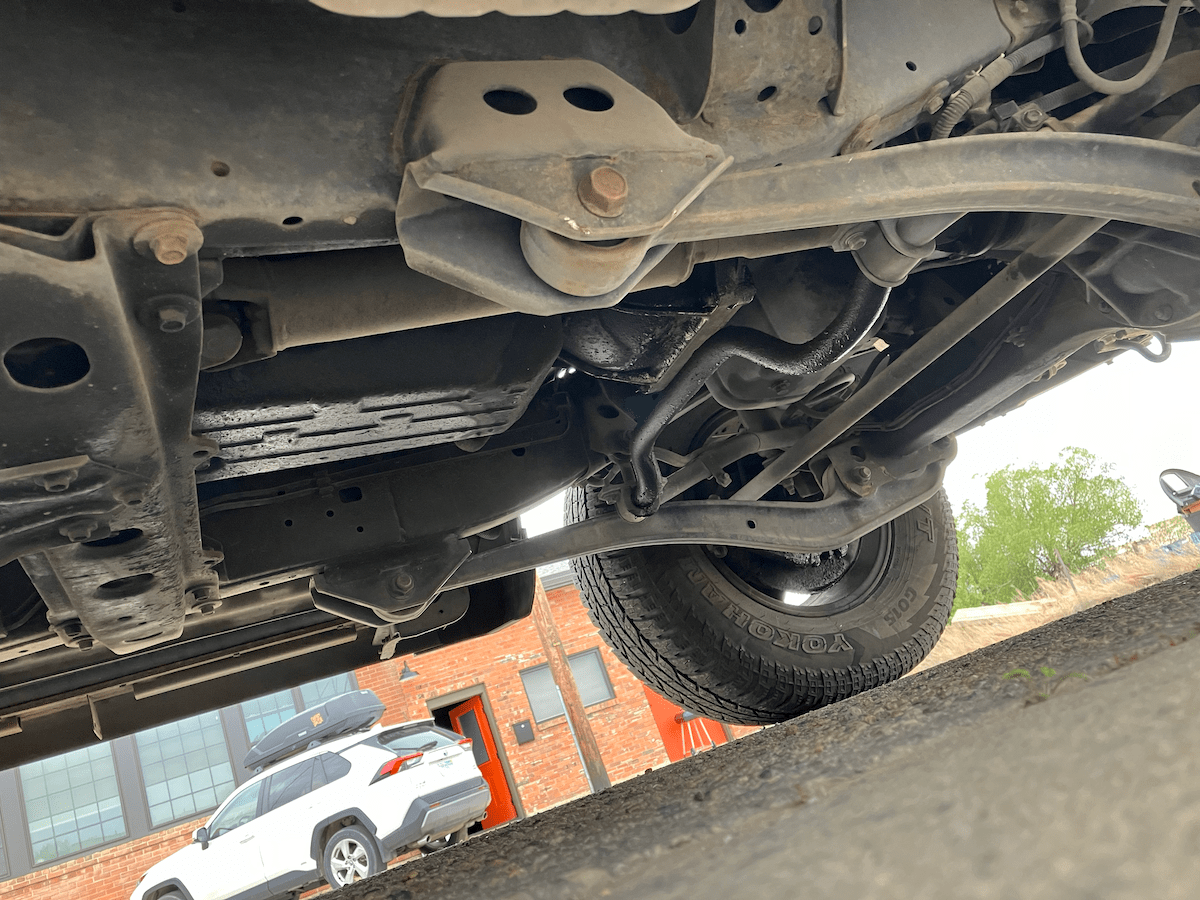

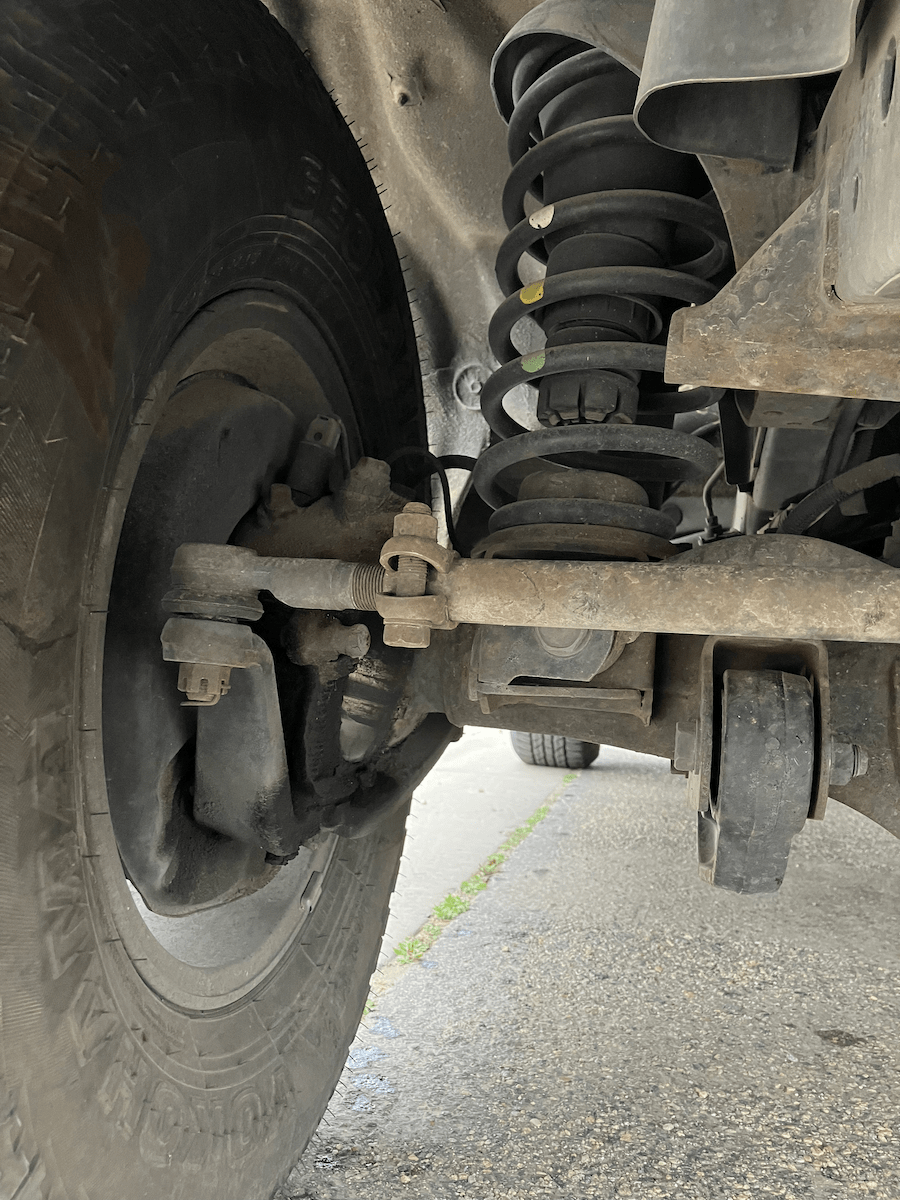

Ok got the video of the startup, screeching happens way more in reverse. Smoke smells like gas (not oil). Fuel gauge works with battery, but I just opened the gas cap (filled it a few hours ago) and took about 5 seconds for the pressure to fully release.
Also added some extra pictures of the underbody, main thing is on the third picture the U-ish shaped bar (think it's a bar not a hose), not sure what it's called, that seems to be where the leaks end up. Right underneath that there's always some fluid that smells like oil.
