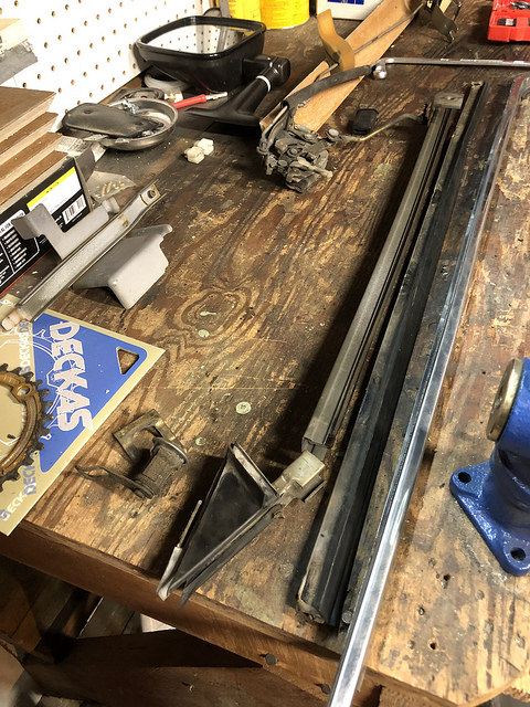

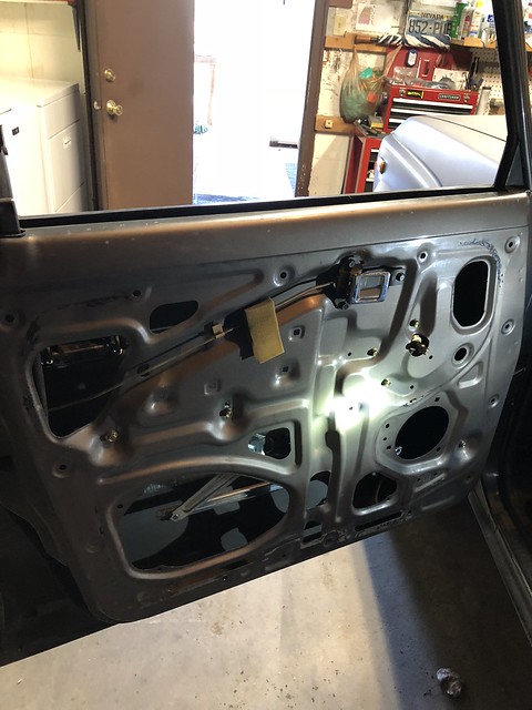

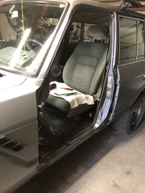

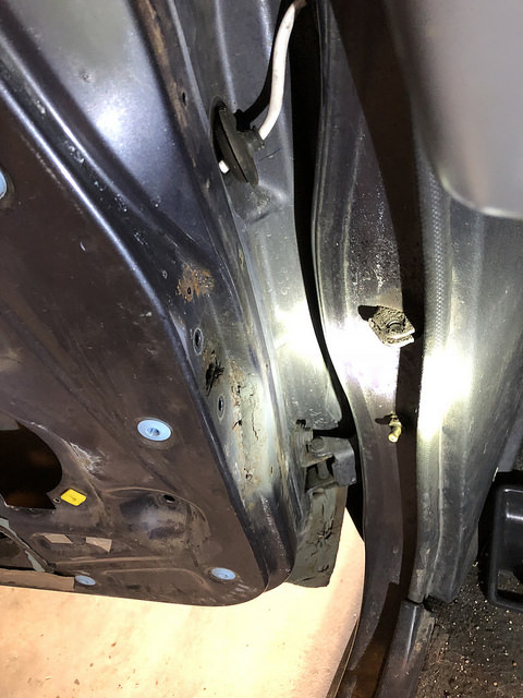

Finally had a day where i could work on BeBe without much interruption. So took the opportunity to swap drivers doors.
Took me about 5hrs total with fiddling with different things and putting some of the parts in the buzzbox for about 30 minutes. Other than that was a pretty simple and easy job. Need to see about getting a new handle as I found a piece of broken return spring in the bottom of the door which is causing the door to open slowly from the exterior.
Untitled by Greg Fisicaro, on Flickr

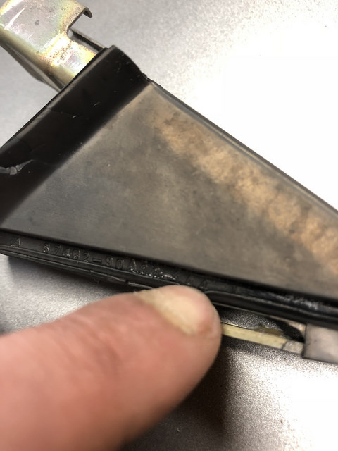

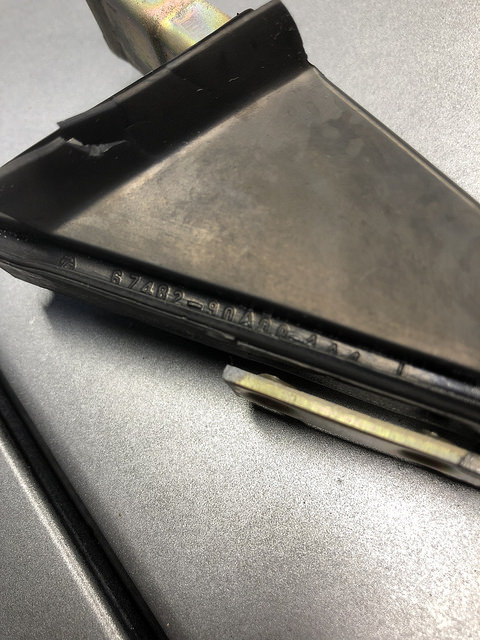

Hard to read but this is the little edge part at the front corner of the door. Single solid piece of rubber and metal, you can kinda see the code ends in AA4

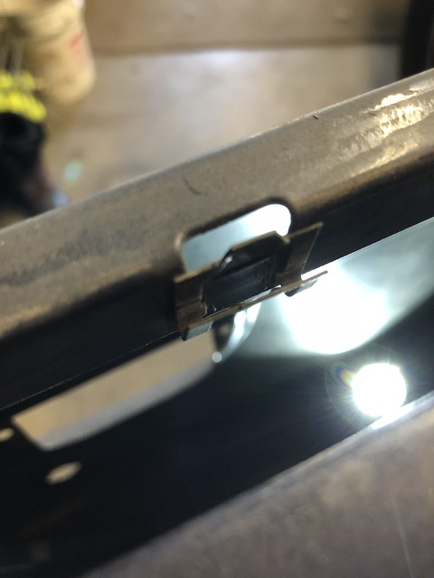

Unfortunately the stupid little clip that holds the door pull rod broke, so going to have to find a new one. Door still functions properly but rattles a bit.

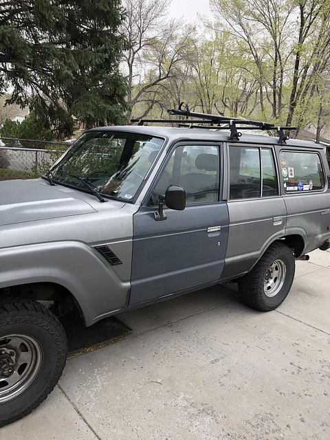

Final product, possible new color (again Rustoleum Deep Slate rattle can) against old grey.

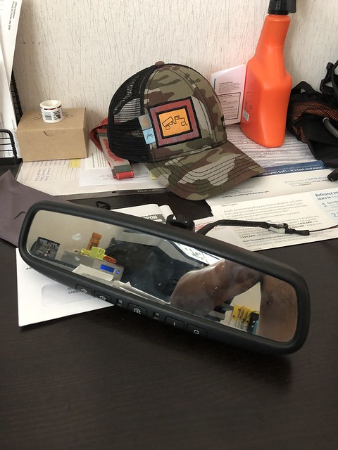

On another note, I purchased one of @NLXTACY Gentex Mirror mounts this week (should be here early next week) and took a chance and ran to my local PnP. Scored a Gentex GNTX-453 out of a 2007 Prius with the pigtail for a whopping $13! The 453 encompasses multiple GENK4Xa series that has the auto-dimming and homelink in it with some models even having the compass (mine does not). Looks like wiring will be stupid simple, three wires on the pigtail.... red, black and white with black line. Figure red is 12v, black is ground and the white w/ black is ignition (for auto dimming).
