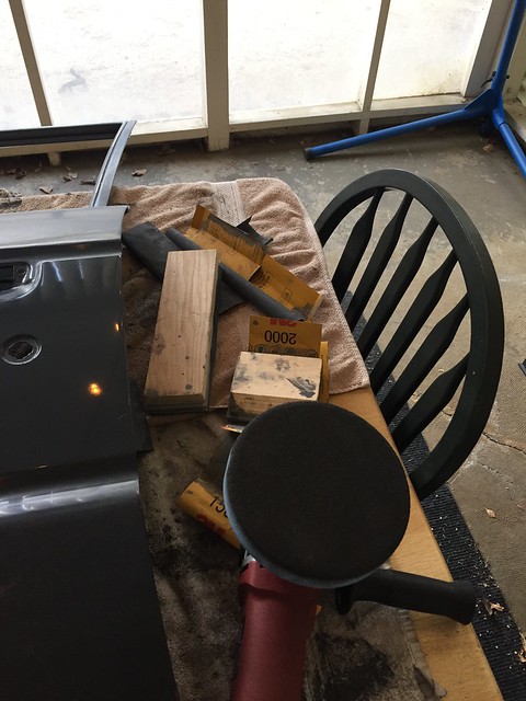

I even had some old closed cell foam laying around from when I built my rear interior panels and created my own sanding blocks from some scrap wood and the foam.

All-in-all I am pretty happy with it. Can still somewhat see my cross hatch marks but literally last night and today I maybe spent 2 1/2hrs all together on the door sanding between 1500 and 2k. It topped out at 35 today, so I basically went out, sanded for 20 mins, went in to warm up, went out for another 15-20, rinse and repeat.
Definitely burned through on my corners and edges so now I know that I need to be a little lighter with my touch and need to put more coats of paint down. Think total I put 2 full cans over the entire door which I thought was a lot at the time but doesn't seem like much now.

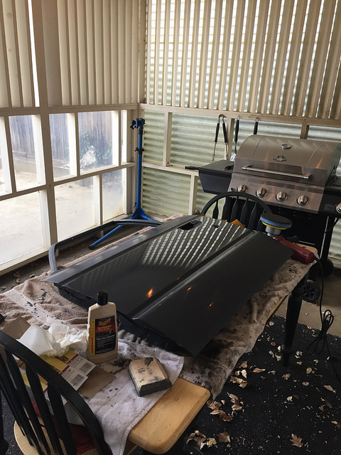

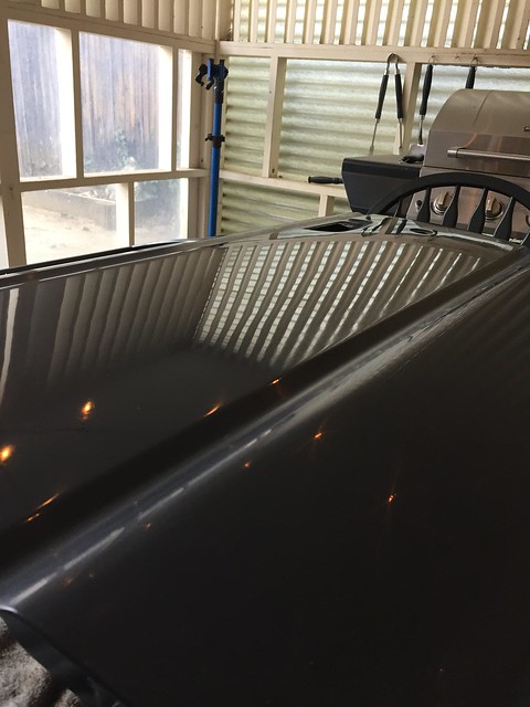

And we actually got a bit of sun today between storms. Finished up the entire door up to 2k and then polished with the Meguiar's. Again this was cheap stuff, level 5 cut/polish compound type, with a cheap HF orange medium cut pad. I did grab the black polishing pad but did not grab an actual "POLISH" sealant type as I burned through the paint on a couple of edges and again, this will not be the final paint job.

Again you can see the spots that I burned through the Rustoleum rattle can and those were areas that were somewhat hard to reach when I was moving around the door (should have done a better job when I was setting it up and determining how/where I would spray). Since my drivers door is so jacked up with big rust holes in the bottom I will be throwing this door on (swapping internals) within the next couple weeks. Then I have a spare rear passenger door from @KWalkerM that I will test spray with the HVLP gun when the weather warms up and what I believe is a close match in the Nason color to the Rustoleum. I will probably only grab like a quart of that (if they paint supply place will mix that small for me) to test it out and see how close the two are.
