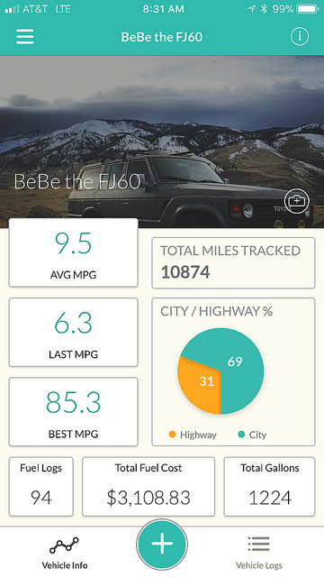

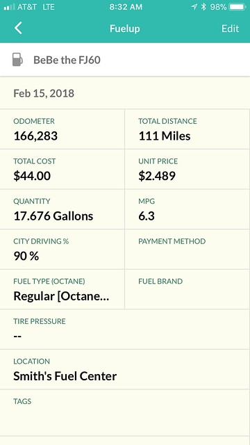

Finally got through an ENTIRE tank on Alex's carb and this happened yesterday...
Untitled by Greg Fisicaro, on Flickr
Yes that is correct, 6.3mpg for that tank. Think when I hit the reset on the trip odometer I was at about 114 miles.
Trying to troubleshoot what the hell is happening here because that is just stupid. I can live with my avg or 9-10mpg but this has been happening for a few months now.
