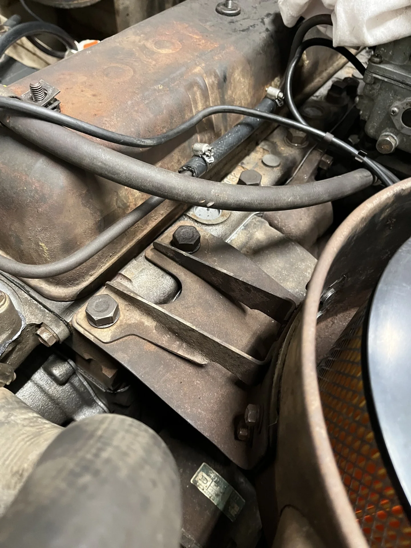

The first thing is I found out that I forgot to put air cleaner bracket on when torquing head. Pulled both bolts installed are cleaner bracket and torqued. Put radiator back in and ran truck for 10 minutes. The oil now has milk streaks on dipstick. I used a cheap rock auto head gasket also. The other issue is it will go into gear but will not turn back wheels and starts to smoke like crazy which I think is the clutch. Tranny and transfer case both have oil. In neutral I can rotate drive shaft and with a small borescope can see gears in transfer and tranny move. In gear locked up solid. Inside of both cases look good with borescope. I’m thinking need to pull tranny hump and look inside top cover. No metal on drain plugs.
OEM head gasket is nla--some folks say the fel-pro is a good alternative--Toyo still has the headbolts, plugs,expansion plugs, valve guides, valve cover gasket--check w/Mark's off road--he may have a source.
If you removed only two head bolts then re-installed, the whole torque sequence was compromised--head should be opened back up to verify the gasket hasn't failed(gonna need a new gasket any way if you take it off)--do it soon, before the gasket gets stuck to everything(make it easier to clean--)
SOR has a page that shows the tightening torque sequence for the F and 2F heads(I will tell you for sure that their sequence for a 2F is incorrect) but the one they show may be correct for an F engine.
Attached is the Haynes manual sequence--it is not correct for the 2F either, but may be for the F., and the SOR specs they are different also--there are some references to this in the FAQs--look for Max Ellerbee(don't think that listing shows the visual sequence--only the bolt specs)-- chose your poison
If you have access to a factory serv manual-follow that--both for loosening the bolts and installing.

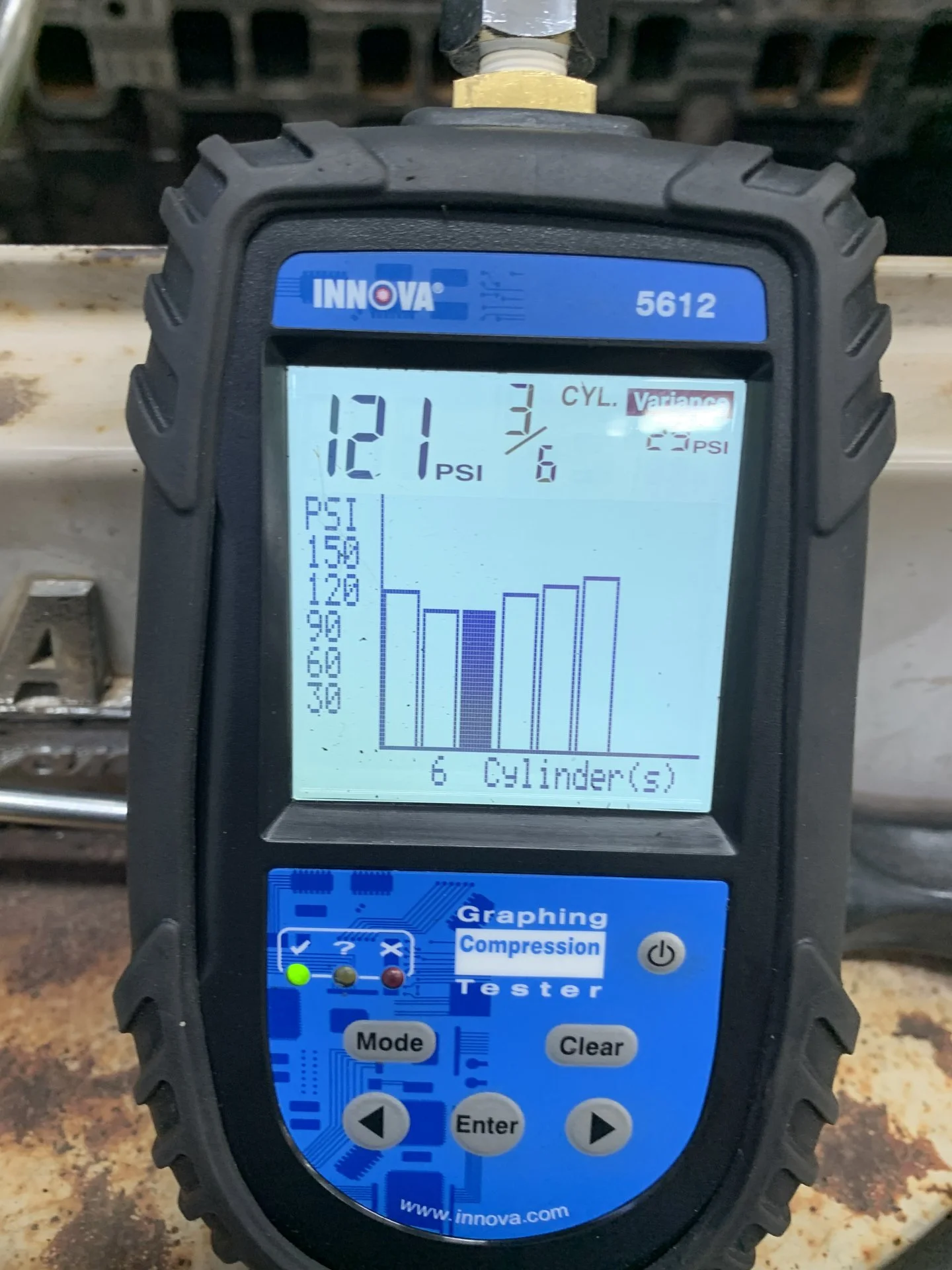

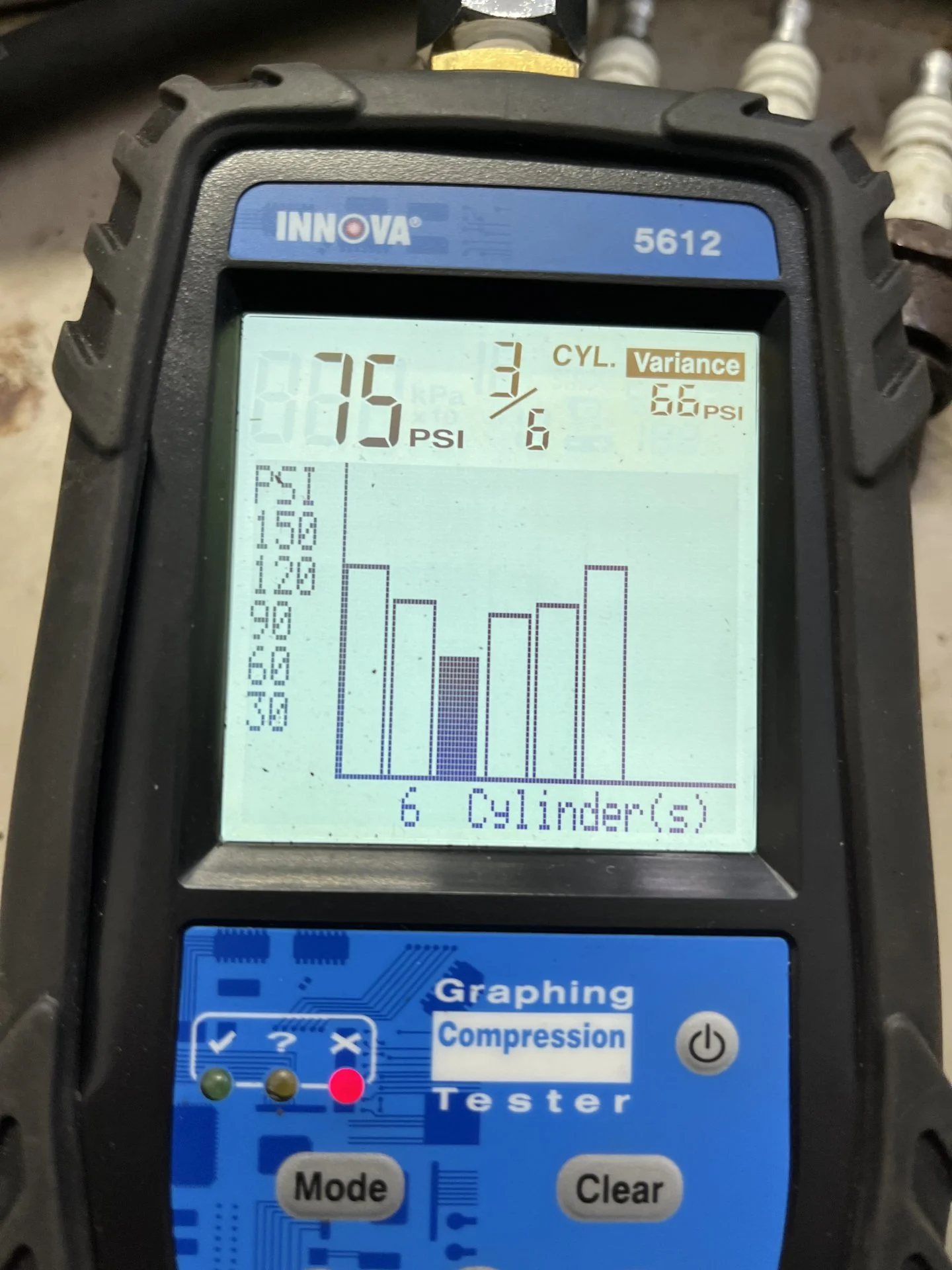

Ran engine up to temp. Idles fine. Restarts hot , but man does this thing smoke when u give it the gas! Blue smoke so my guess is lower end wore out. I took compressions after head gasket was installed and just now on a hot engine. #3 is now 75 psi. Maybe needs another valve adjustment?All plugs have oil on them but are firing.First picture after head installed, second warm engine.

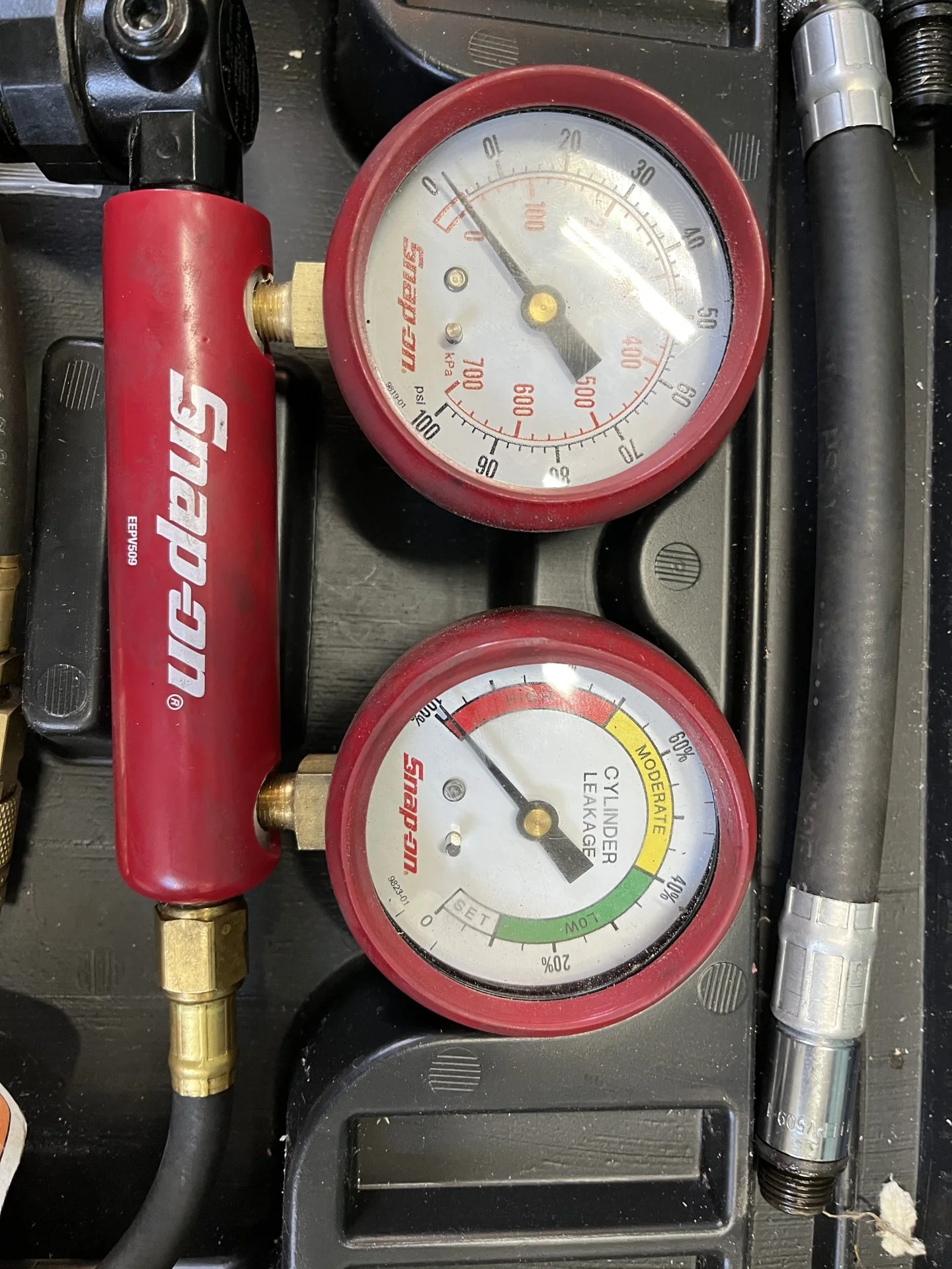

Well good news is the vacuum operated transfer case still works. I was surprised. The Engine still smokes like a chimney. Pressure tested cooling system to 22 psi. It holds pressure. Performed a cylinder leak down test at 90 psi and all are 78-80% leak down except #6 is 35%. You can hear the air in the bottom end with the oil fill cap off. Has anyone seen this bad of numbers across the board? The pistons and valves all are wet with oil which is why this thing smokes so bad(looked with borescope) I guess that lower end is wore out. It’s odd I had good compression numbers after installing rebuilt head and now they are a lot lower After running maybe 30 minutes. This thing sat a long time. Do I just need to run the crap out of it for a while Or start rebuilding the 2f I have?
A lot of times when you get the top end tight the worn bottom end will just give up, it just can't handle the extra pressure. Is your smoke out the tail pipe?
I would say warn or stuck rings. I was asking because my f engine has a couple small holes on the top sides of a piston and runs great but builds so much blow-by and it's crazy how much it smokes out the valve cover vent and nothing out the tail pipe.
Rebuilt head may have closed up some holes, now you may be seeing the lower end showing wear that was contributing(leak-down seems to be showing this)--your compr test shows 4 cylinders way under spec--that tells me the cylinder wear may be advancing due to long use, plus the inspection results showing oil in all the cylinders.

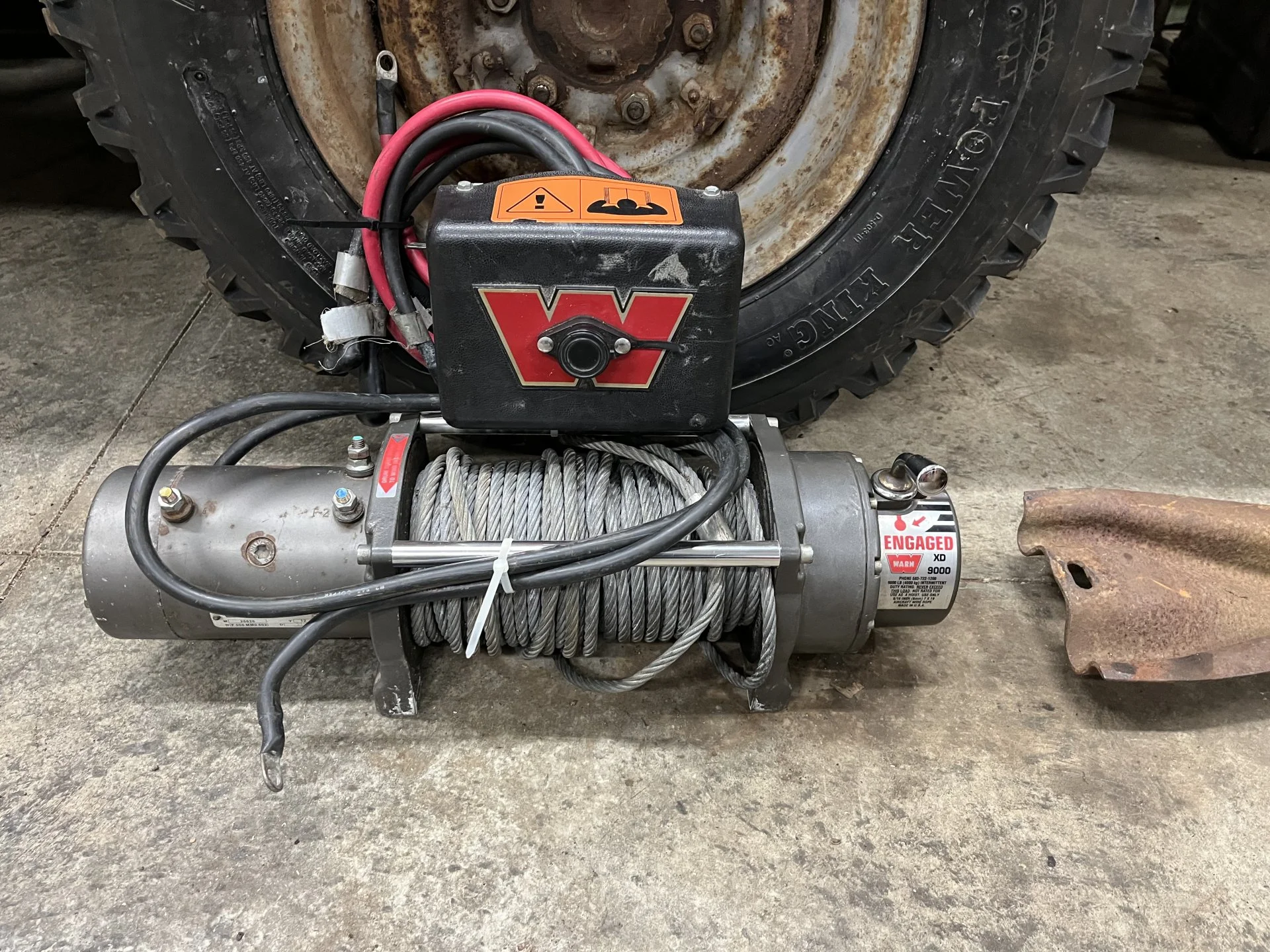

It'll probably be years before you need it, but every LandCruiser needs a winch.
I did the right thing and waited to win one in a raffle.
