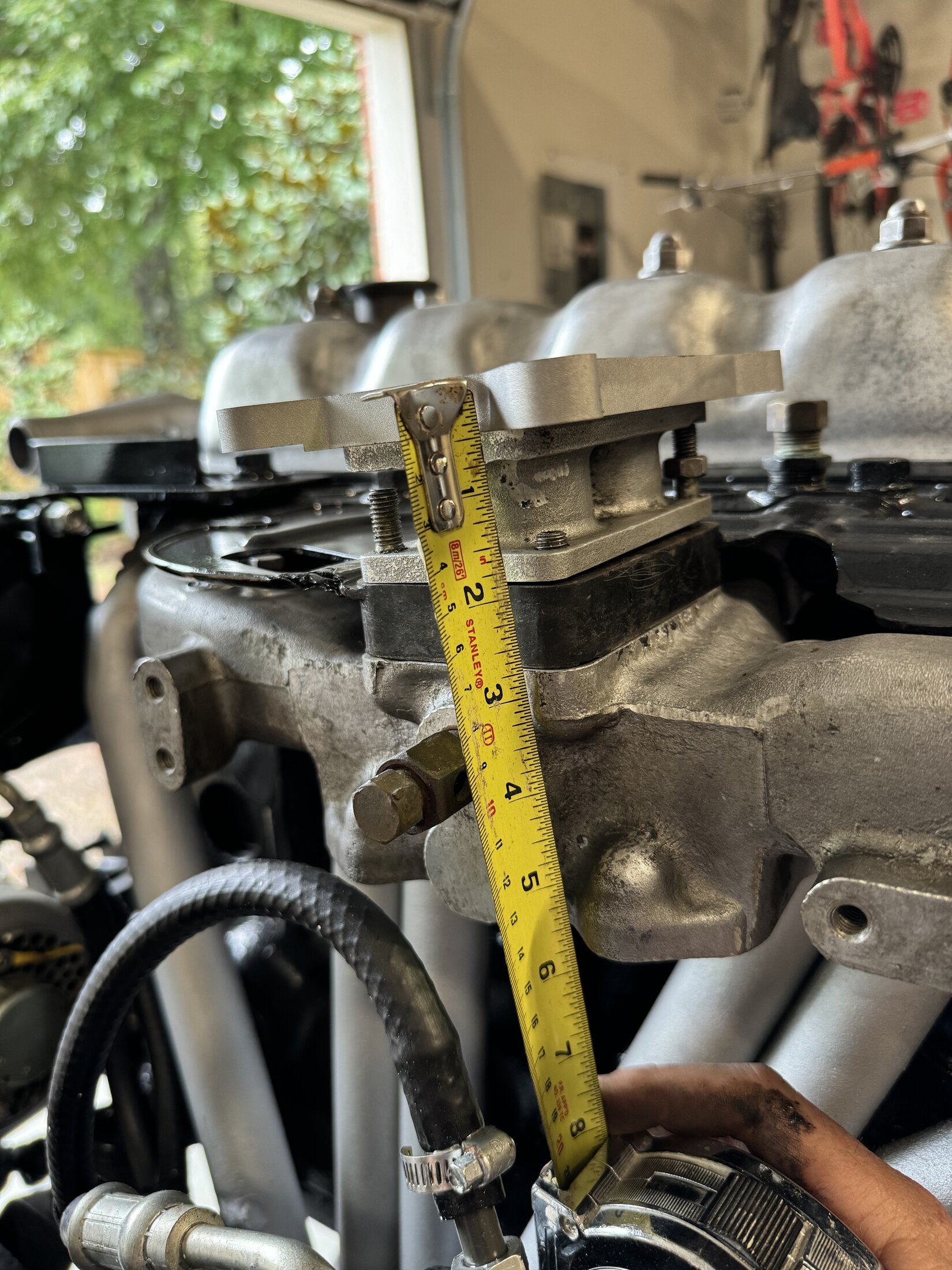

Hoping for some wisdom on this… Installing a Holley sniper on a 1976 2f. Original truck had a Weber carb and a stack of spacers.

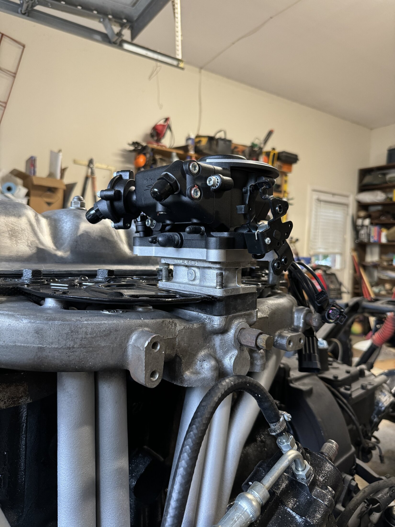

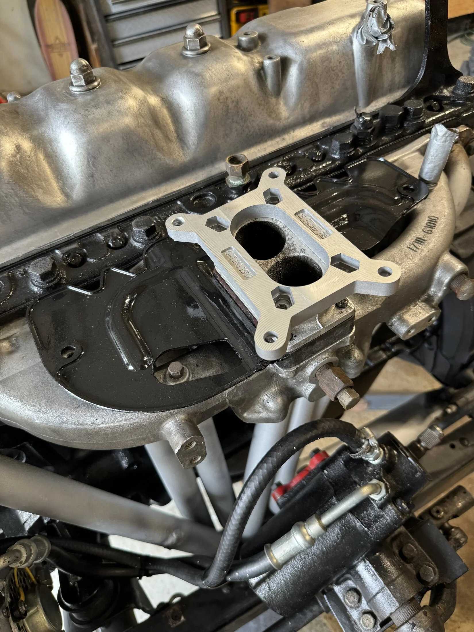

Moving to the sniper, I have it mocked up like this. Heat shield with spacer, then the man-a-free, then the adapter mount that the sniper sits on. Gives me about 2-3/4” from manifold to bottom of sniper.
Too much lift? Any issues running this set up?
No experience with a Sniper, but I think I have older manny spacer under my Rochester that came that way in 82. My thought is more mixing distance for air/fuel is better to some extent. I also have one of those tungsten screens in the path just under the carb - not sure it really helps with mixing but it does prevent big stuff making it to the pistons.
