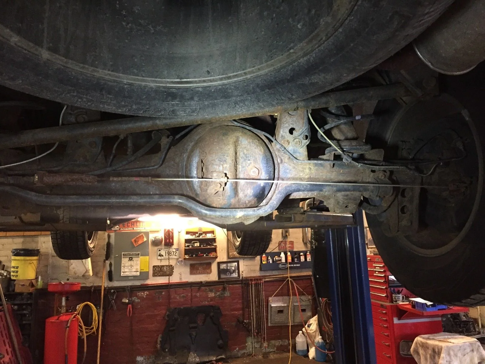

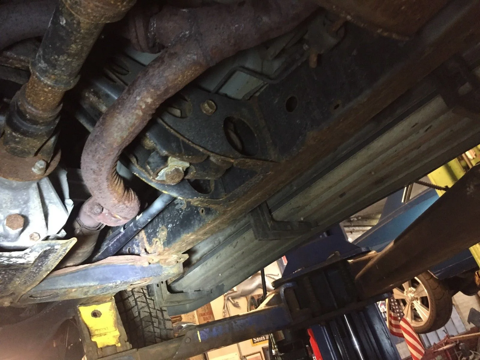

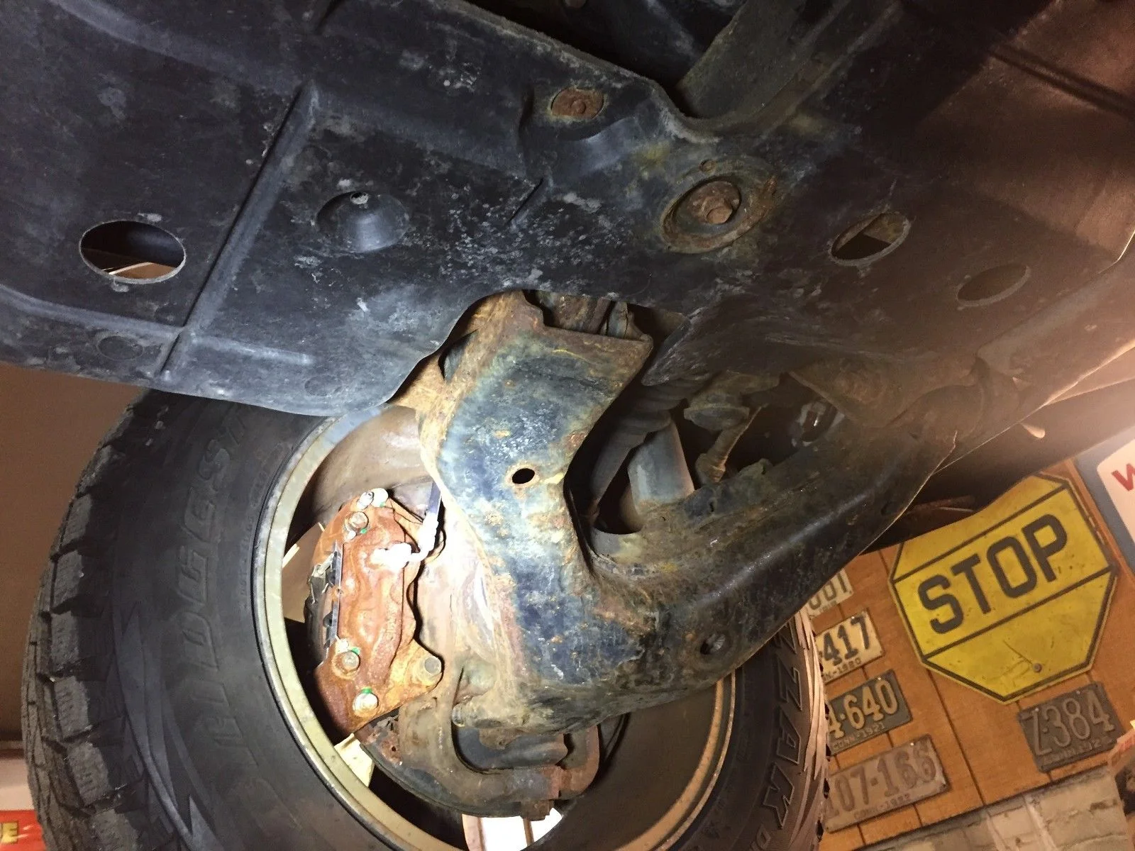

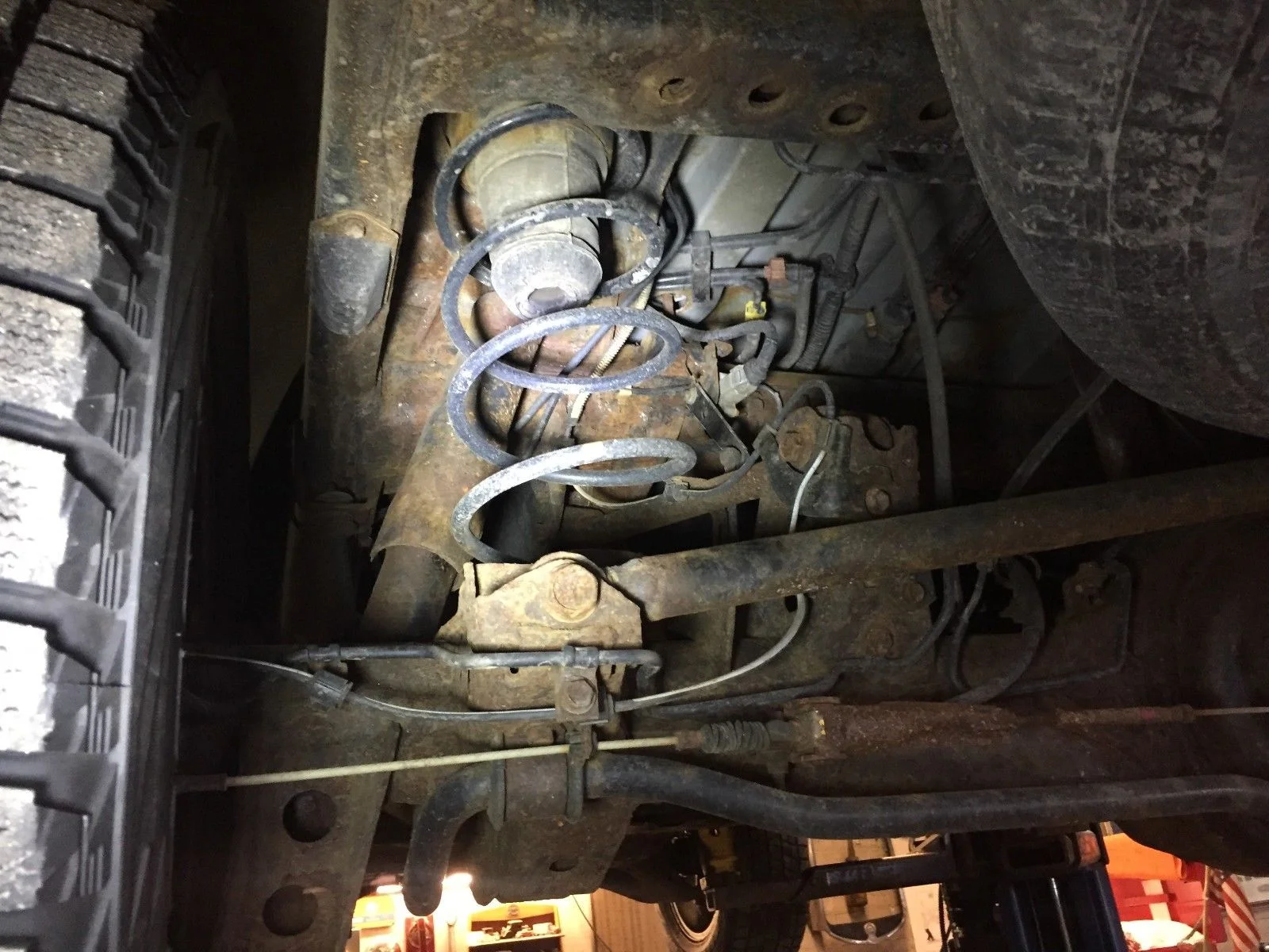

I don't know how to evaluate rust on a vehicle. This is a 2007 Connecticut LC with about 130k miles that I am hoping to get for around $17k . How bad is this rust? Buy with confidence or run away?

It's bad enough I'd not take a second looked. But I don't buy from rust belt!
I would not recommend.

pass.
For 17k there are other trucks

It is pretty rusty, however, you'd need to do a thorough inspection - spend a good hour under that thing with a brass hammer. Lightly tap around, poke around and see if anything seems soft. Check the body mount points and the cross members specifically.
Honestly, if its rust on-top of a solid structure, you can take a needle gun and scale most of that stuff off and then get it professionally undercoated. If it's not a rot box, at $15-$17k, you could easily drive that thing to 300,000K and then move onto the next.
