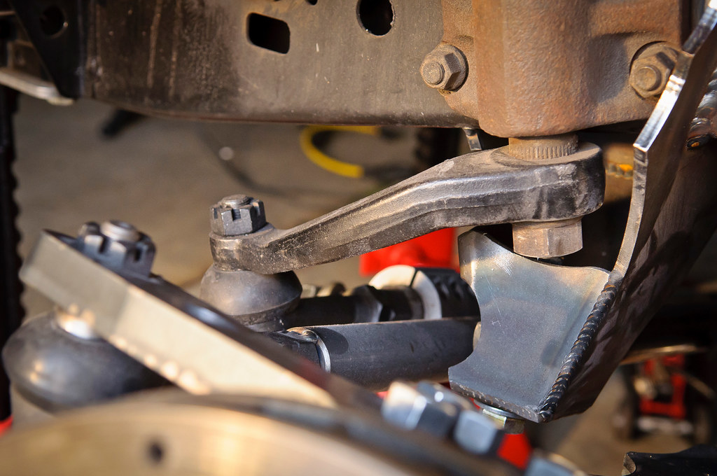

I suspect this happened when it contacted something above it that your bump stop failed to prevent. I know you probably doubt that but mechanically it would be very difficult to bend that much from stress induced by the tie rod. Clearances are wacky sometimes when all twisted up...
No that makes sense, but there is nothing that would touch the Hellfire steering arm itself. There's no marks on it aside from where the paint cracked. Doesn't matter if it's fully stuffed or drooped, wheels turned either way. Worst case scenario would be the tierod touching the pitman arm at full stuff and wheel turned to the left. The downward force of that could be transferred to the Hellfire arm. But if that did happen I would expect to see some scuffs on the top of the tierod or orange paint rubbed onto the bottom of the pitman arm. Nothing, they're both perfectly clean. Also, wouldn't you think the tierod would bend before the Hellfire arm?
This is the max interference. I set the height of the shocks about a 1/2" below contact

I really don't think so. The limit straps are set to about 1/2" before the shocks reach full extension and the whole suspension was setup with everything cleared based on shock travel. I really think it was the blank hole in the Hellfire arm that created a weak point. I should have just welded in a solid insert to avoid the big gaping hole in the arm.
What's it look like when turned all the way to the right with that tire stuffed? What about with both tires stuffed?

With the wheel stuffed and turned to the right the tierod actually drops a few inches away from the pitman arm like so:
I don't have pics of both wheels fully stuffed but this is the height at which I set the bump stops. And so far I've only felt them contact once on a trip a few weeks ago, confirmed by the paint rub on the bump pads. I really can't imagine the bent arm was caused by some sort of contact. And I say that because everything is rattlecanned and the paint would quickly show where something made contact. There's no marks on top of the tierod anywhere, nor on the pitman arm. So I'm not sure what else that leaves.
Yeah that doesn't look like a problem. Ok I stand corrected. Even with that hole, the hf arm shouldn't have bent. So much steel...
