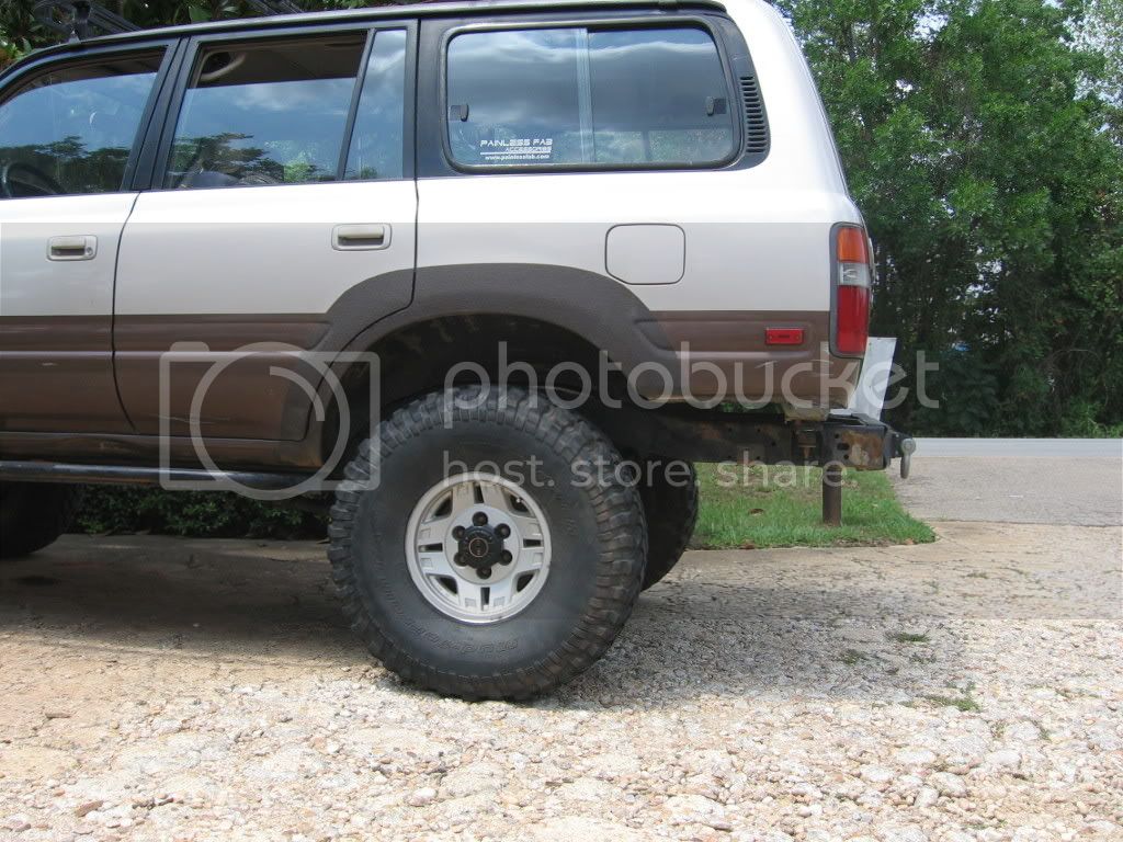

Anywho, I'm officially bumper-less now. Rear bumper is off to its new owner. After I fix the steering and finish the rocker shop / new sliders I'll get to work on the rear quarter chop and DIY rear bumper. Gonna roll with no swingouts and no spare tire. I'll be chopping the rear quarter where you see the green dotted line and will make a mini slider that attaches directly the frame. I may even trim the lower lip of the tailgate so the rear quarter chop lines up with the tailgate. We'll see. For now I just welded in a temporary cross member to make it driveable.

wow you really are going to chop a good chunk of them rear quarters!

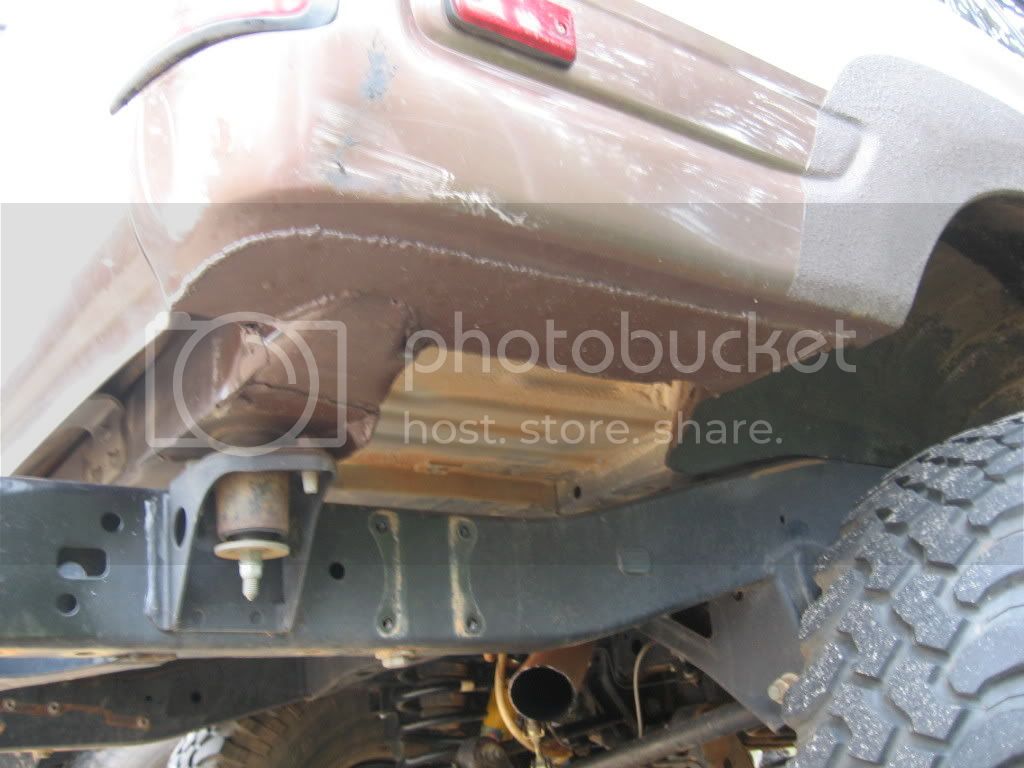

Yeah trying to take it straight under that body line. If only it weren't for that rear body mount, it'd be a lot easier. It'll look something like this:

So what are you going to do with the spare and all the other junk you had on the rear bumper?
I'm in the process of cutting this today, looks more complicated than it is, just start cuttin

Cuttings done going to seal it up this morning and lost some pics, 2 hours with a sawsall and disc cutter and she's all shaved off, I left about and inch below the body line where is cuts under to run my tube around in the notch
Pics sir please
