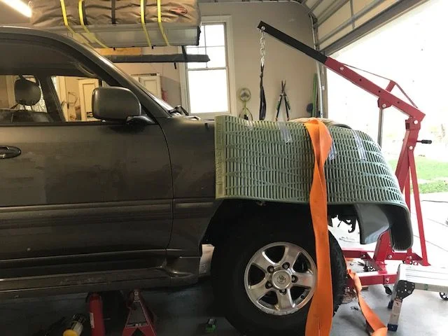

Your hoist should handle it . But IF your hoist has extendable legs (width) move them as outboard as possible for stability.
I'll proceed with entire drivetrain removal, appreciate the comments. Agreed on the pros vs cons of installation.

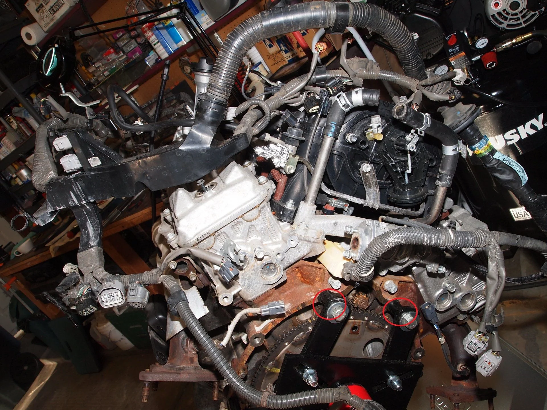

Two bolts easily missed, are just below the starter bolt at top of bell-housing.

The starter bolts, I gues I've done so many, I do not find that bad. The trick is to remove the one 10mm bolt holding wire housing connector bracket that hold 3 wire connector blocks on top of transmission. This give more room to get a 14mm, 1/2" dr. 6 pt socket on the DS starter bolt with 1/2" breaker bar. I have also (years ago) come from below across top DS of transmission with about 3' of extension & universal joint, to torque back in DS starter bolt. PS seem to never be issue.

Yes those are the top bell housing bolt easily missing, just below the 14mm starter bolts.
