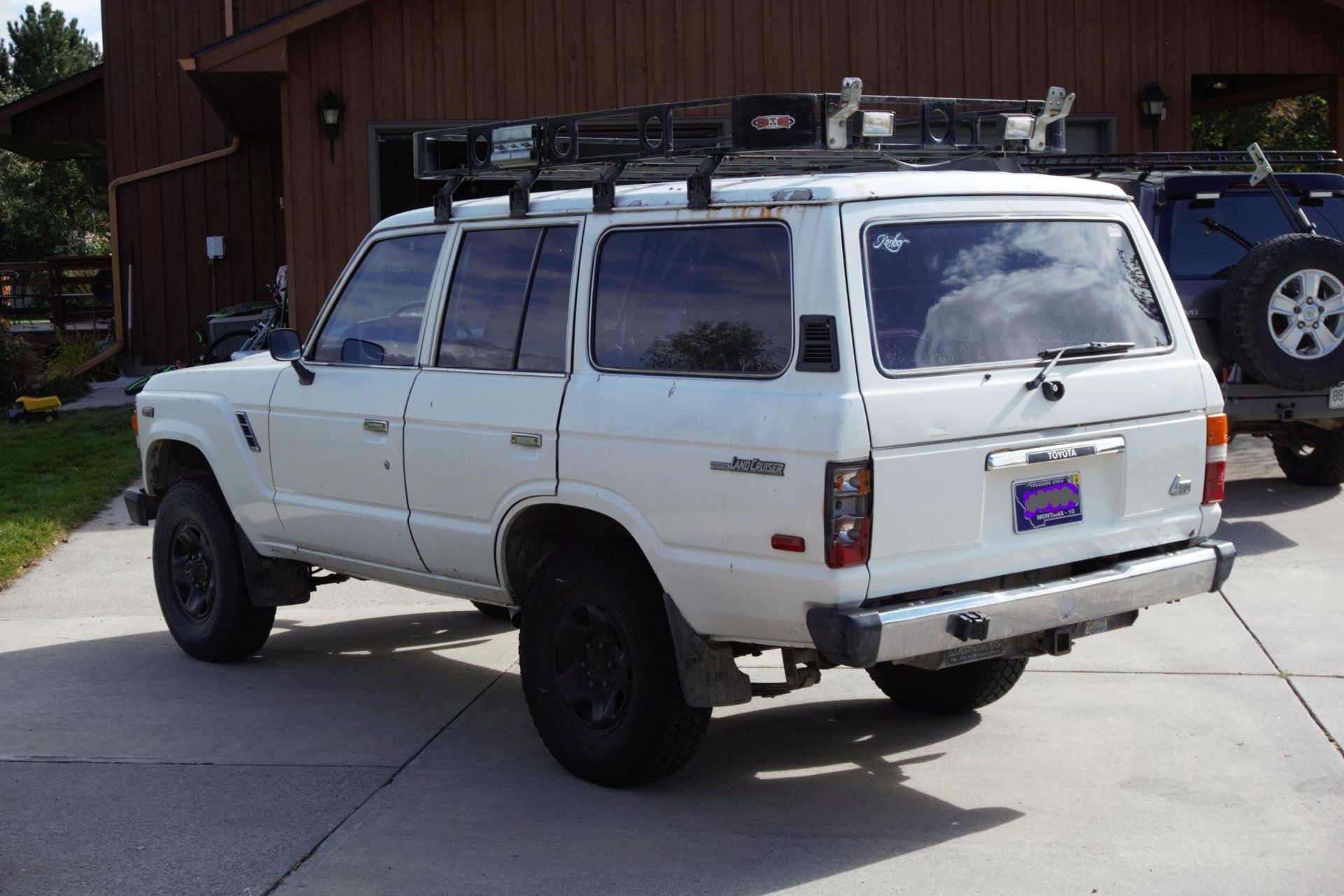

We've always been on the look out for a 60 series wagon as it is my wife's favorite Cruiser series. We jumped on this one with plans to slowly clean it up, modify it to suit our style and enjoy it. I am not sure if it is our forever 60 as I have ALWAYS wanted a silver one, but this one had enough potential to put us over the edge and go for it. Here is how it came to us...
1983 FJ60...
and as it sits today Sept 2019...
1569381652452-png.2091142
It is a 1983 FJ60 and some of the highlights were:
The Good:
  • V8 Conversion with a simple 1979 K10 Pickup Chevy 350 (done well by a pro shop)
  • Eldelbrock/Weber Carb
  • Advance Adapters Torque Splitter.
  • Centerforce Clutch
  • 4 Speed Manual
  • 38 Gallon MAF Long Range Fuel Tank
  • Older Con-ferr shackle lift... maybe 2" ish or so.
  • Modern Hands Free/Bluetooth CD/Headunit.
  • No leaks
  • Con-ferr roof rack awesome and old school.
  • Warn 9000ti winch on cradle for front/rear mounting. Anderson plugs front/rear.
  • Starts, runs, pulls and brakes straight and strong. This wagon is a kick in the pants to drive. My wife loves it.
  • Loud/burly exhaust note. Sounds good.
  • No leaks anywhere.
  • Mostly complete and unhacked.
  • Likely had an enthusiast owner in the past due to a few SOR and MAF stickers.
  • Class III tow hitch with 7pin and 4 pin wiring.
The Bad:
  • Interior is rough but likely average for a user that is 35 years old.
  • The PO swapped in some Ford cargo van seats (comfy but out of place) I did get the originals and center console in the purchase, looking for a good seat bottom.
  • Carpet is rough
  • Dash is cracked in bad ways
  • Tacoma wheels and spacers on OLD tires.
  • The wiring is all there, done mostly safely but sloppy when after market items were installed.
  • A few broken missing items, front TOYOTA emblem, rear brake lens, pass door handle etc.
  • Dented front bumper and pass fender.
The UGLY
  • It has some of the rust cancer on the roof above the rear windows. Its been smeared and squirted before, not sure just how bad it is yet but it's rough.
  • Front doors are SHOT. Never seen cancer like that on the leading front door jambs (have a line on some good less-rusty doors).
  • The fuse block showed evidence of a smoldering incident... smoked three of the fuse slots, likely due to improper fuse ratings. In addition, there was some hacking to get the circuits running again. I've already addressed this issue as it was a safety hazard.
  • The quarters are mostly solid, but time will tell, it's weird to see it rusting from the top down instead of the usual bottom up.

Here are a few shots of what we are starting with...
Straight with some rust above the rear windows... old school cool Con-ferr roof rack.
