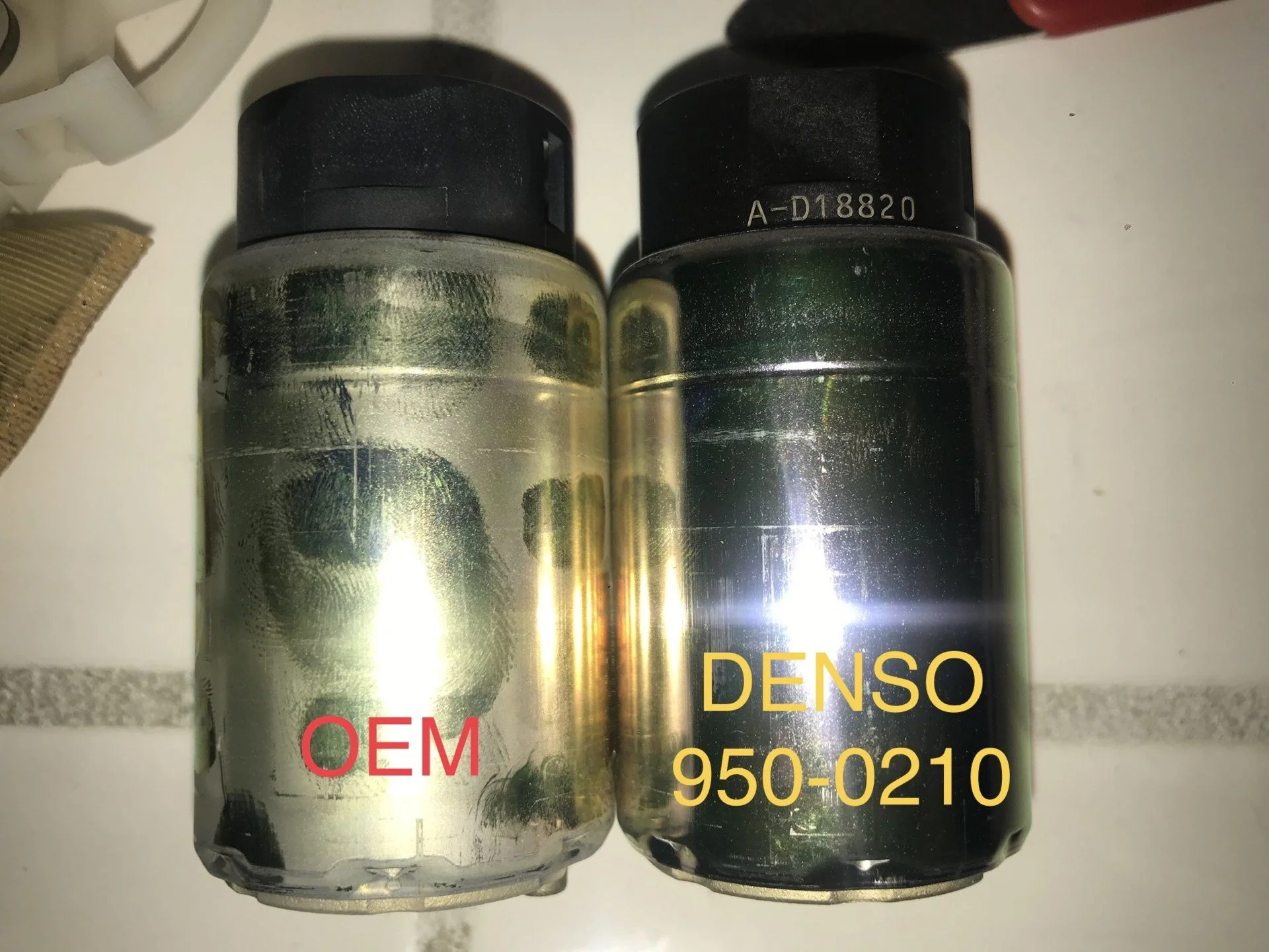

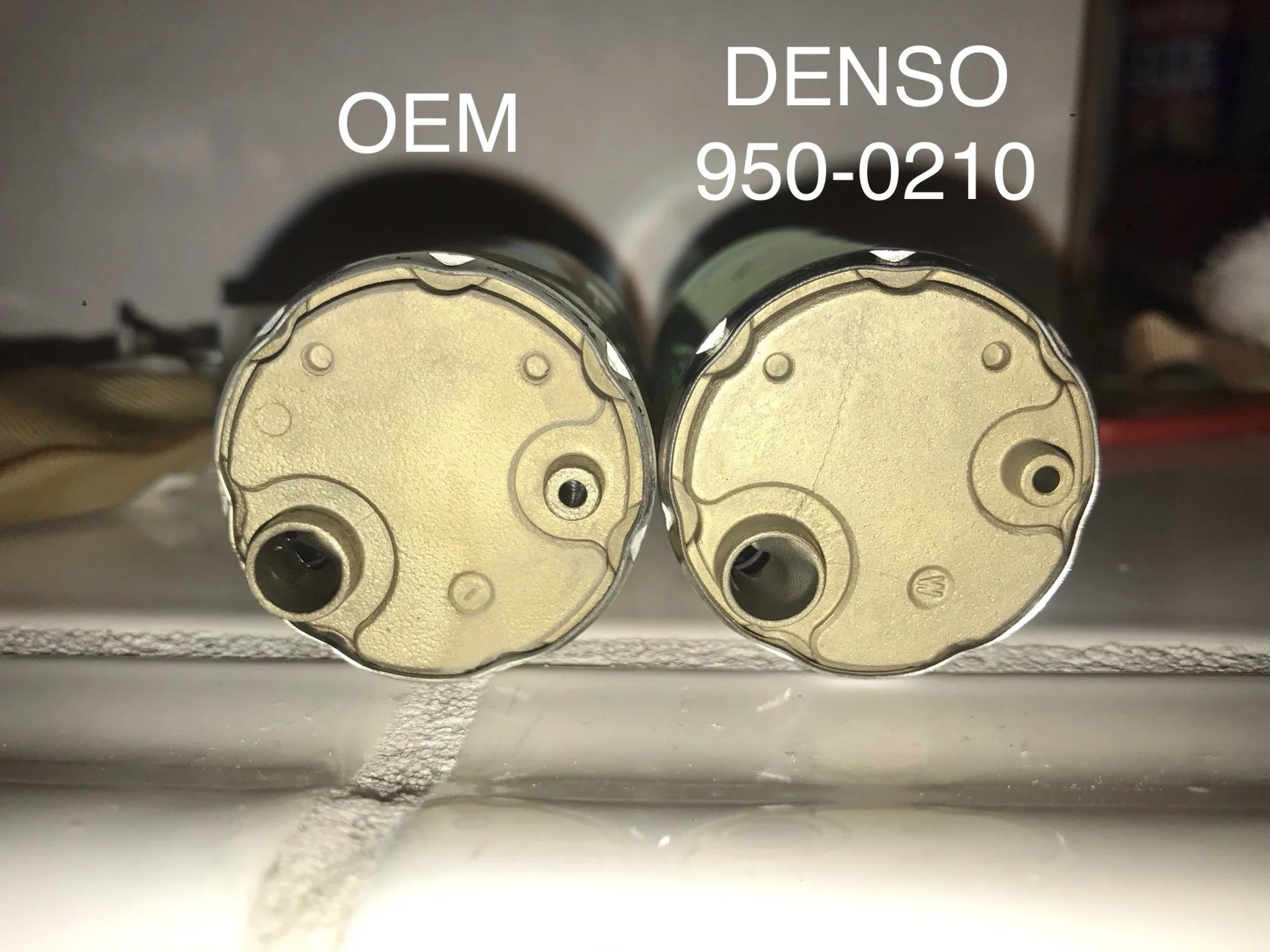

This problem is very common in the 06 and 07 models (VVTi) when they changed the fuel pump compared to the earlier models. I have gone through almost all possible ways to resolve this when this happened on my 06.
this is my fair share of my experience dealing and solving this problem.
Here’s the side by side comparison of the two fuel pumps:
i believe the fule pumps toyota sells today are the upgraded. My mechanic, when installing the fuel pump, told me it was an upgraded part number and the old one was not available.
so what part # FP is the upgraded one?
I'd have to look through this thread, i posted it a number of years ago, both the old and new part numbers for the fuel pump. But my mechanic told me there was only one pump available from the factory, and it was a replacement part to the old pump, so i don't think you can buy the old one...
