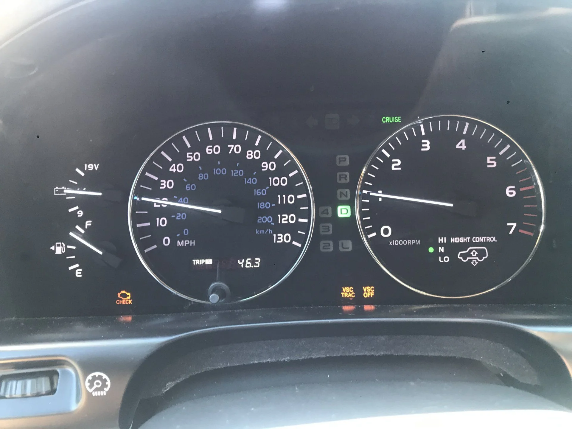

Well guys, my 06 LX seems to have this problem. Yesterday afternoon at 4:30 pm we stalled at Old Santa Fe Trail and Paseo de Peralta (big thanks to everyone who helped us push it out of the way!).
We had been driving all day, 5.5 hrs from Utah. 70’s temp. Premium major brand gas only, 1/2 tank at incident. Pulled into Santa Fe after long uphill on I25 @ 80 mph from Bernalillo. Driving in 25-45 mph city traffic for maybe 5-10 minutes. For just a few seconds before it died, engine ran really rough. After it died, in P or N it would crank strong, but no start, or else would catch briefly then die. Hard to tell everything going on with people honking at me (sorry if you were behind me!!) Started fine after 10 minutes or so.
As bad as the location was, all I could think was how much I appreciated it doing it there instead of the many hundreds of remote miles we had just covered over the previous week (Maze, Canyonlands NP and the lonely stretches of pavement getting there and back).
Lexus dealer today didn’t have any solution, glad I found this thread; have fuel pump and filter en route. Probably also will cover fuel line near the exhaust just to cover the bases, but at 223k, I reckon the pump is pooped.
