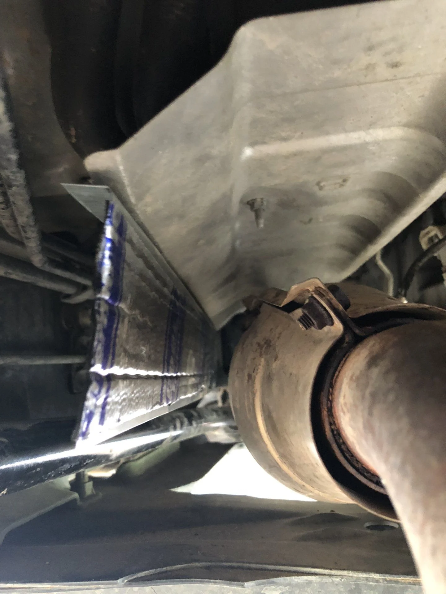

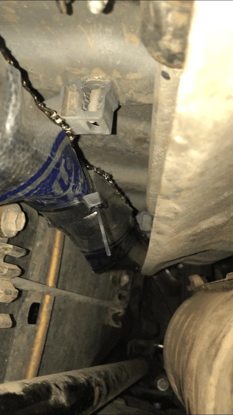

One last item, in one of the previous posts someone mentioned their Corolla had the fuel lines run close to the exhaust to heat up the fuel for better burn, especially during cold weather. I looked under my LC and, sure enough, the fuel line and the return line to the tank run right next to the catalytic converter (about 4-6inches apart) with no heat shield in between. I believe this is the number one cause of the fuel heating up, the fuel expanding in the tank, and the fuel boiling (as it did in my LC).
I had some Cool-it Thermotec heat shield laying around, i wrapped the side of the fule lines facing the cat to protect against the heat. I'll see how it does and report it. I could not figuere out how our LC's are heating up fuel while every other vehicle running in the same temps, same fuel, etc...did not. This may be the answer. this is temporary, until i build a heat shield betweent the cat (on the right in the picture) and the fuel lines.
I did drive through Mojave at 90-122degree temps for over seven hours with no issues, but there was some fuel spillage when i filled up the tank fuel, from the fuel filler. I think this next step will help cool of the fuel more...rough pic attached, but i think you get the idea. The make shift heat shield stretches past the lenght of the cat, approximately 32" long.

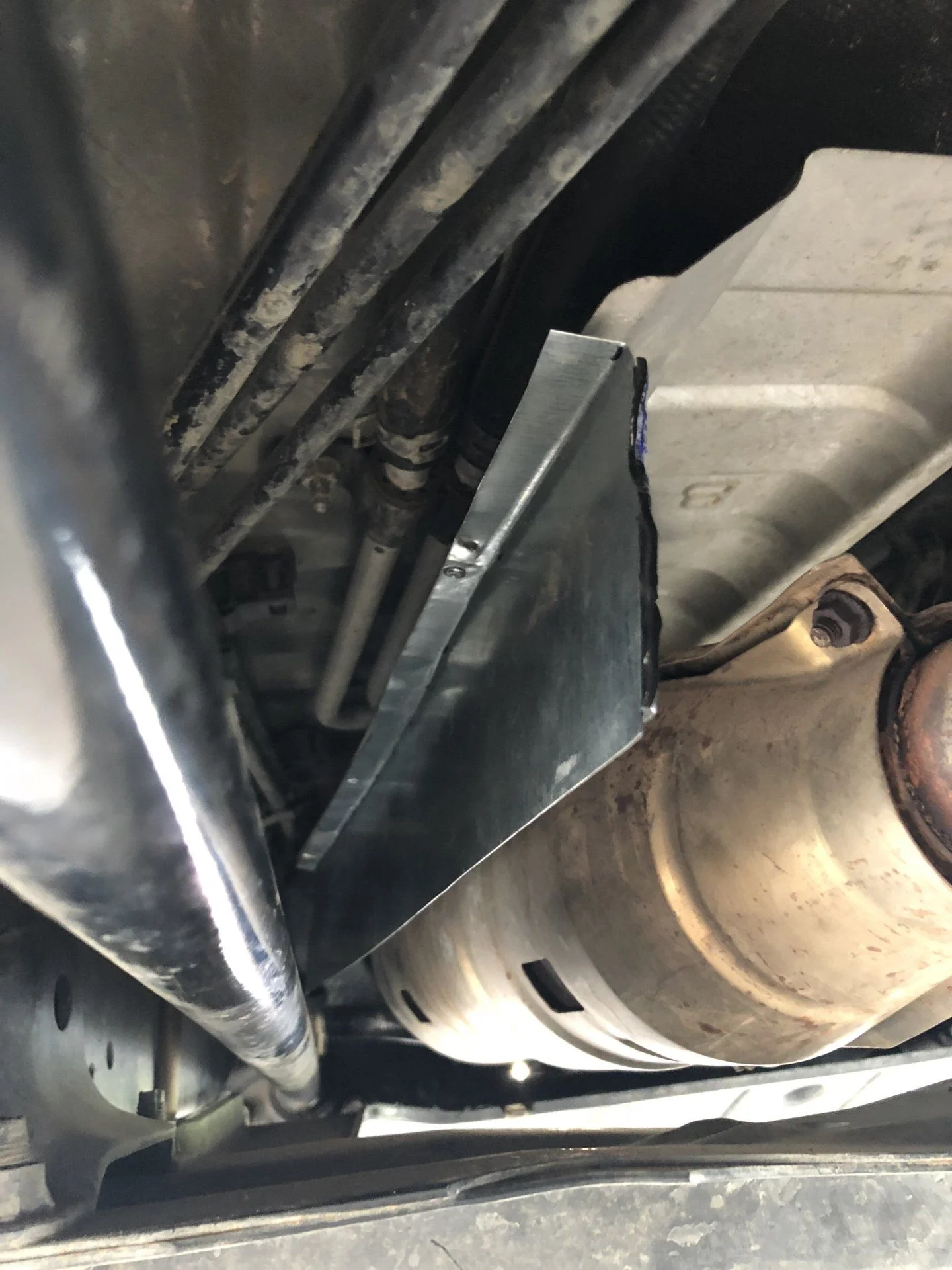

Lastly, i added a heat shield near the catalytic converter to block radiant heat which caused the gas to get hot, taking off the previous temporary heat wrap i had wrapped the fuel lines in. The heat shield is 24 gauge sheetmetal, 23" by 3.5", riveted to the existing cat heat shield. I added thermotec heat shield to the sheetmetal, only because i had it laying around, i believe it is NOT necessary...
I'm posting detailed work and results on this topic because, frankly, this was a huge PITA for me and had me considering selling the LC but i believe it's solved once and for all...
. Thanks Ive had this happen on my last trip West and going back out in a week, I’m going to duplicate your heat shield and hope the results are as good as yours were.. thanks for the idea and good pics. Edit: here’s my attempt at a heat shield, i used some heat reflective tape I had here, maybe not necessary but it can’t hurt . Sure hope I have the good results you did.
