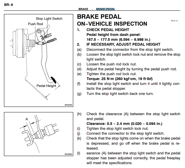

My Cruiser was slipping in and out of lockup on a trip last year. Oddly enough expansion joints in the road caused it to change from locked up to not locked up which confused me further.
With the help of folks on this forum, it was determined that my brake pedal indicator switch under the dash was out of adjustment. When the brake switch was not activated, lockup occurred normally. When the brake switch activated (brake lights came on), lockup was deactivated. The switch was just far enough out of adjustment that bumps in the road would trigger it.

This is a great clue and I mentioned previously that my CC (cruise control) doesn't get cancelled by the brake light pedal switch malfunctioning. However, I'll still do a continuity check just to rule it out. For all I know, I might've replaced it already as I've had this 80 for 18 years.

It might just need to be adjusted. Really simple to do.
My biggest clue is that my CC isn't getting cancelled so that tells me the adjustment is good but it's easy enough to check. I also lead wheeling trips and nobody has mentioned about the tail lights coming on randomly on the hwy or anything.
