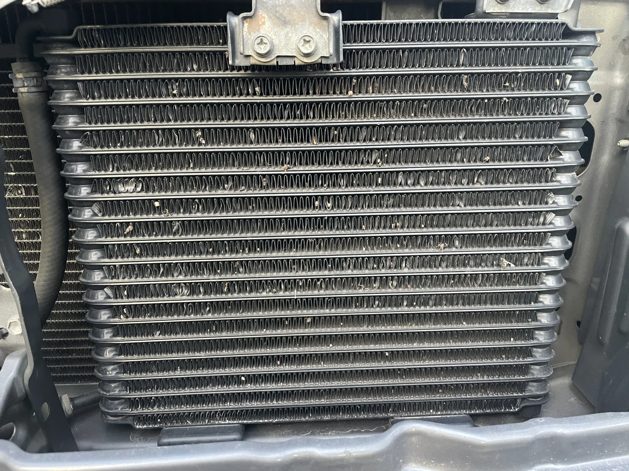

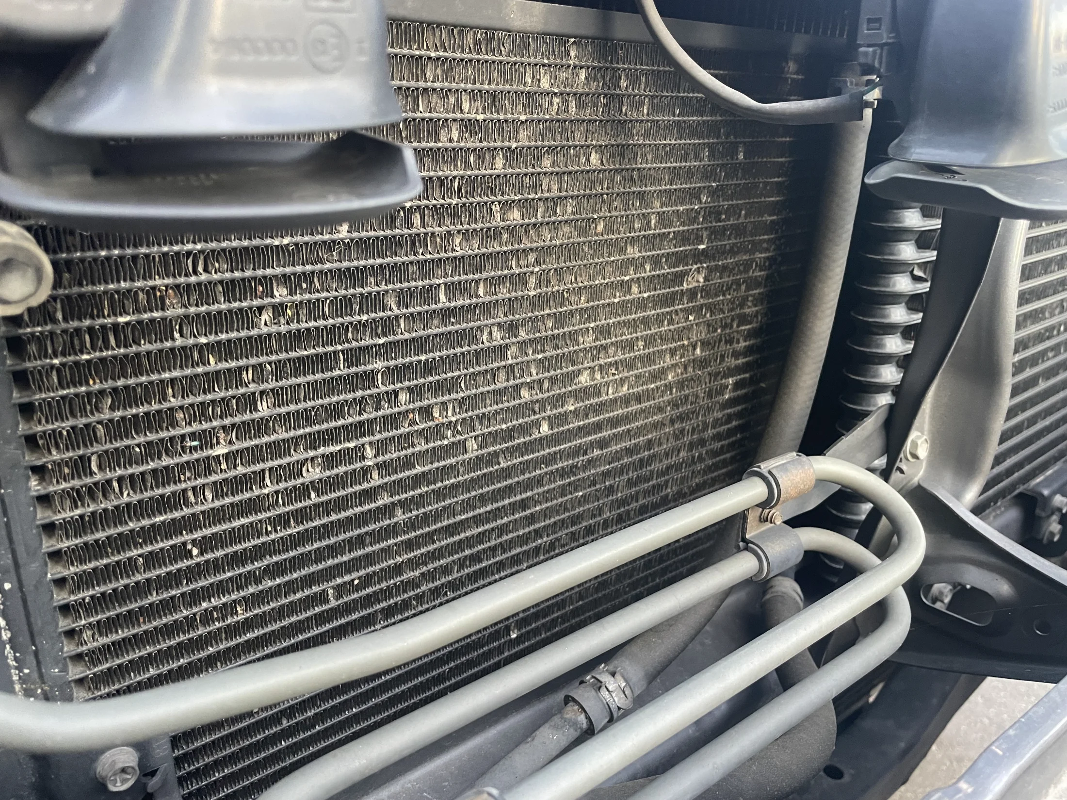

Might as well throw a cap on, below are some photos of the rad/condenser. They don't seem too bad. Will look into the fan clutch next, thanks for the reference.

To be clear, that's the trans cooler and the AC condenser coil. The radiator is behind the condenser, and it's hard to see unless you look up (from under the car) through the slim gap between the two. If it's original and has never been cleaned well (flushed from the rear, with the shroud pulled back) then it's highly likely that it has enough obstruction to affect its performance.

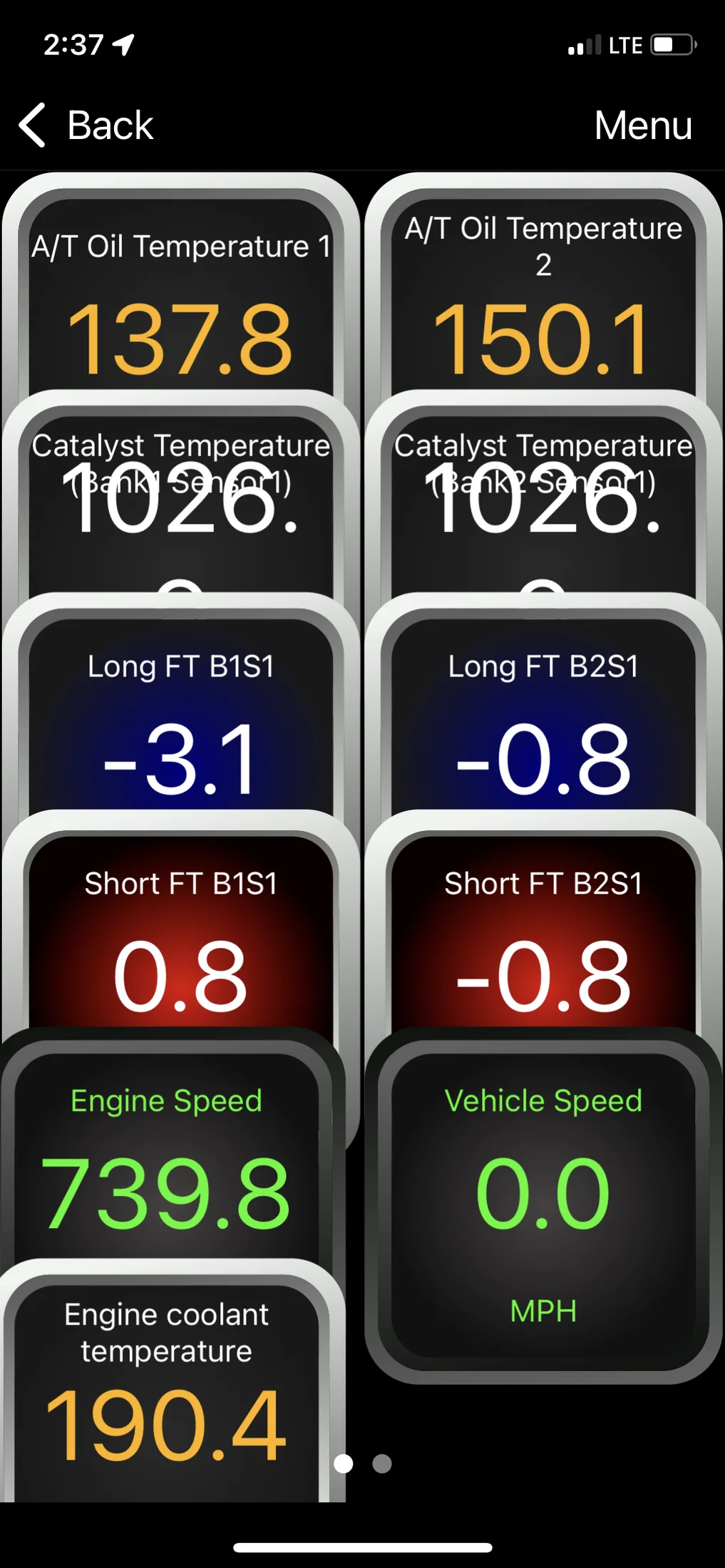

I use BlueDriver or OBDmx, to monitor and log tech stream on my iphone. It's a good idea to monitor and log: Engine coolant temp, Fuel trims, Intake air temp AT temp, MPH, RPM.
Ok, will look into doing this next. I have a scanguage with engine coolant temp as a set on my dash.
