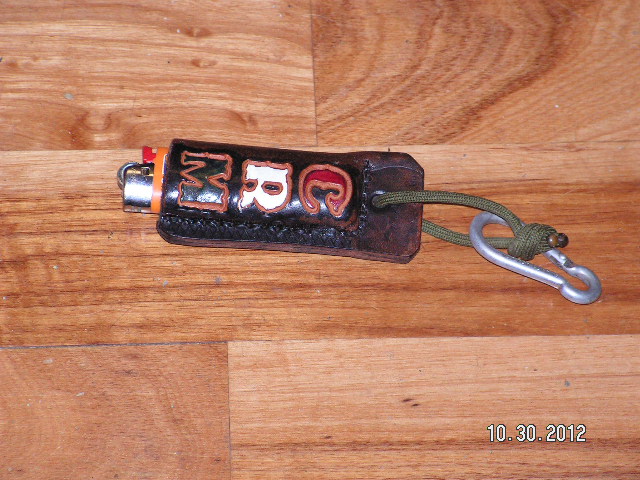

How much do you want to spend to "counterfeit" your block. There are engraving folks that can simulate about any stamping that can pass the naked eye inspection test. Or you could make a one off stamp out of tool steel using acid etched or EDM. A lot of stuff was actually free hand stamped and not set in a jig. I have stamped hundreds of Cadastral survey brass caps and scribed about twice that many bearing trees - penmanship - it never goes out of style.

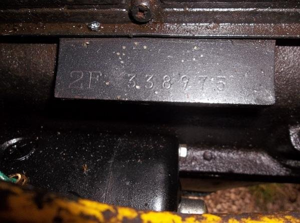

Not exactly. Ideally you would want the same font. You would also need the "F" and the "-".

What about font? Getting any special font can be done. Companies specialize in it. They do not come cheap. They do not look exactly like the original stamps due to how they are made. I estimate the set you need would cost between $500 and $1000.
Once you have them, can you strike the individual stamps with consistent force and direction? What is the force required exactly? IT takes practice. How will you secure the jig? What if you knock the jig loose? You must use a jig. Any misalignment stick out like a sore thumb.
Engraving by hand takes a huge time commitment to learn. The tools are prohibitively expensive. An engraved number does not have the displaced metal around the number and therefore looks wrong.
Making your own stamps is not practical.
IT appears that the original stamp pictured was done with an roll stamp and a machine press. Duplicating it would be near impossible.
