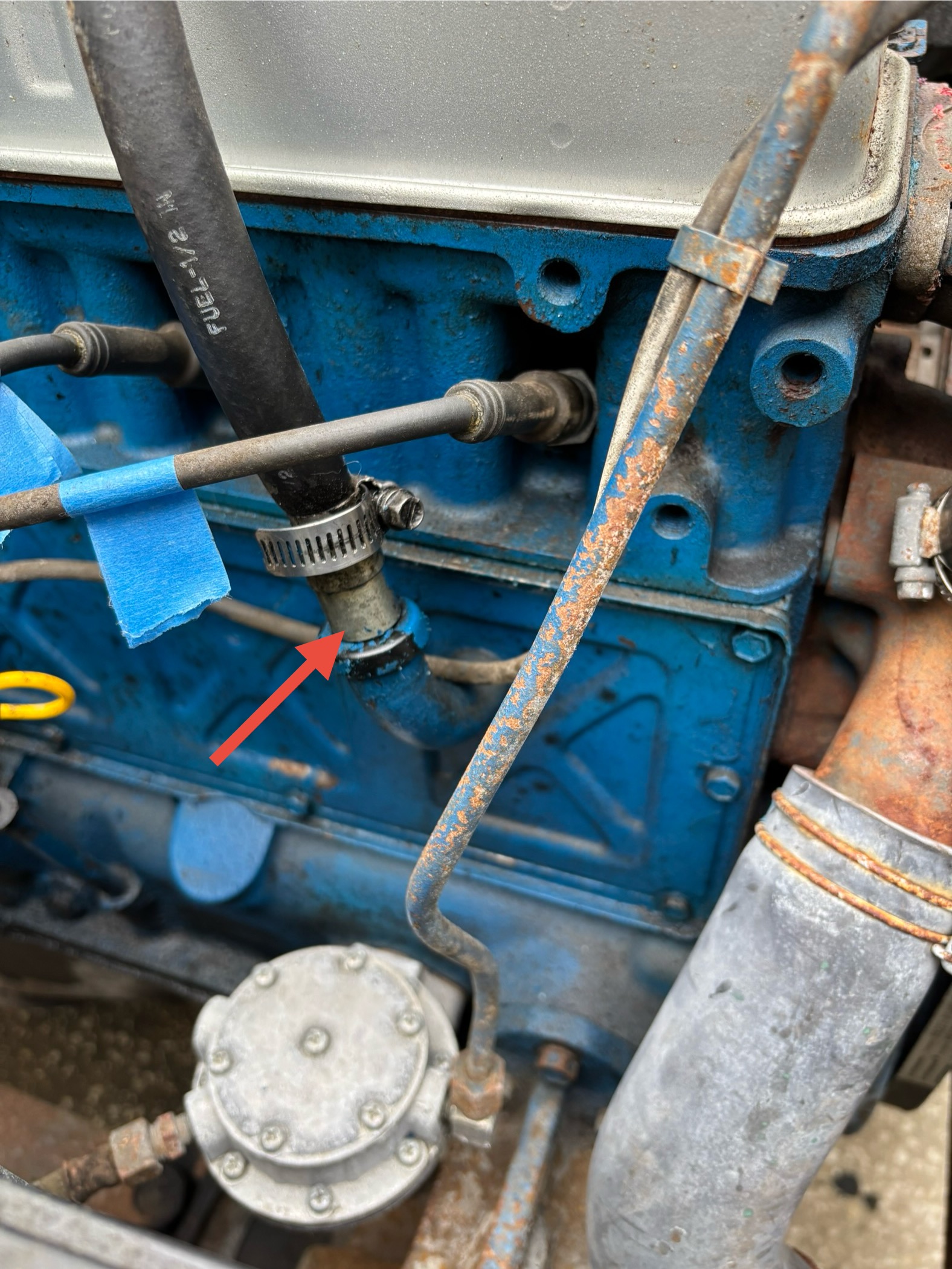

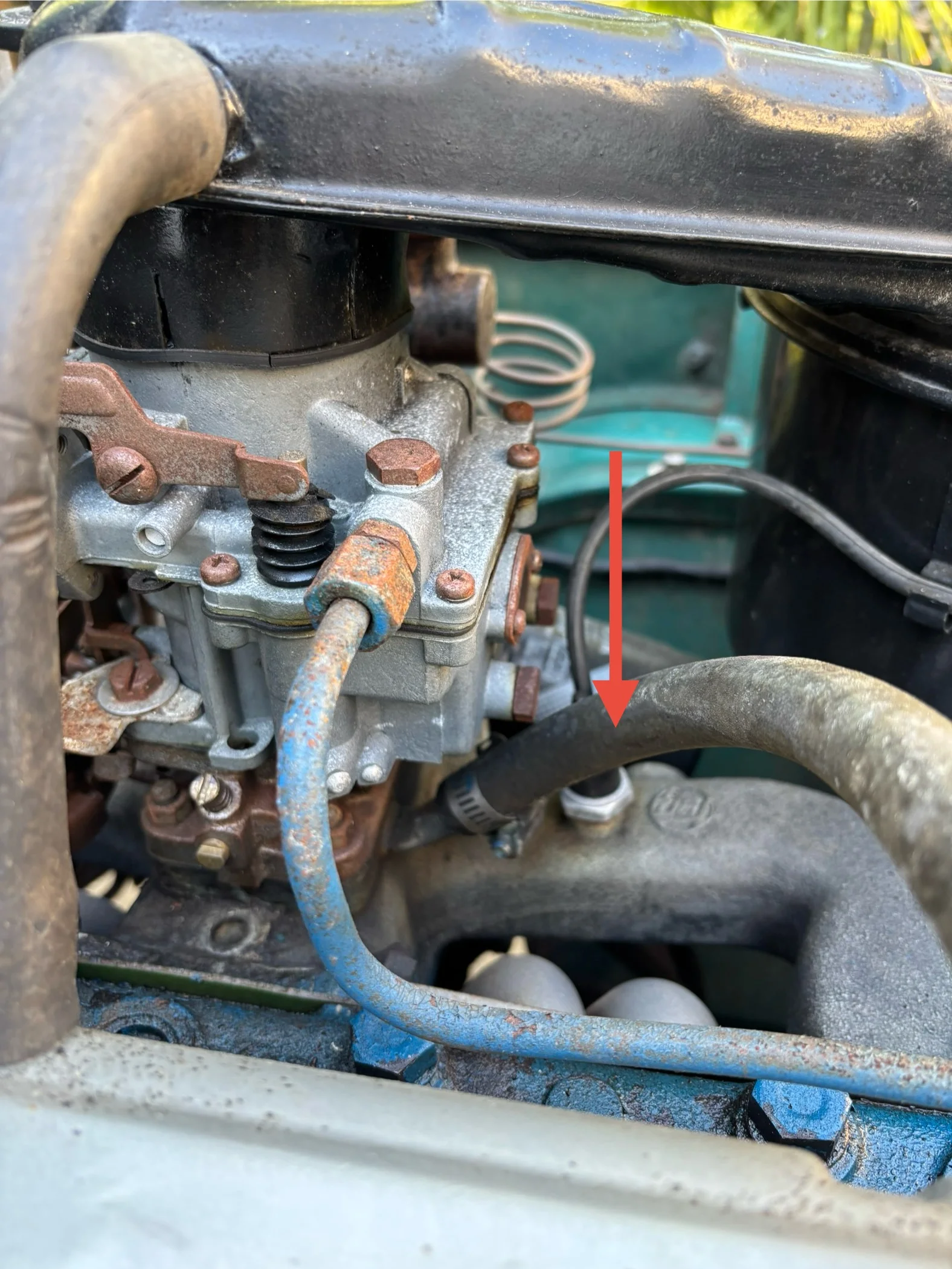

I ordered a new PCV valve and grommet for my 1972 40 with original F155 engine. Is this where the PCV valve is in the first photo? Second photo shows the other end of the 1/2” hose. Thanks for any responses.
Hose is more like 7/16 IIRC.
