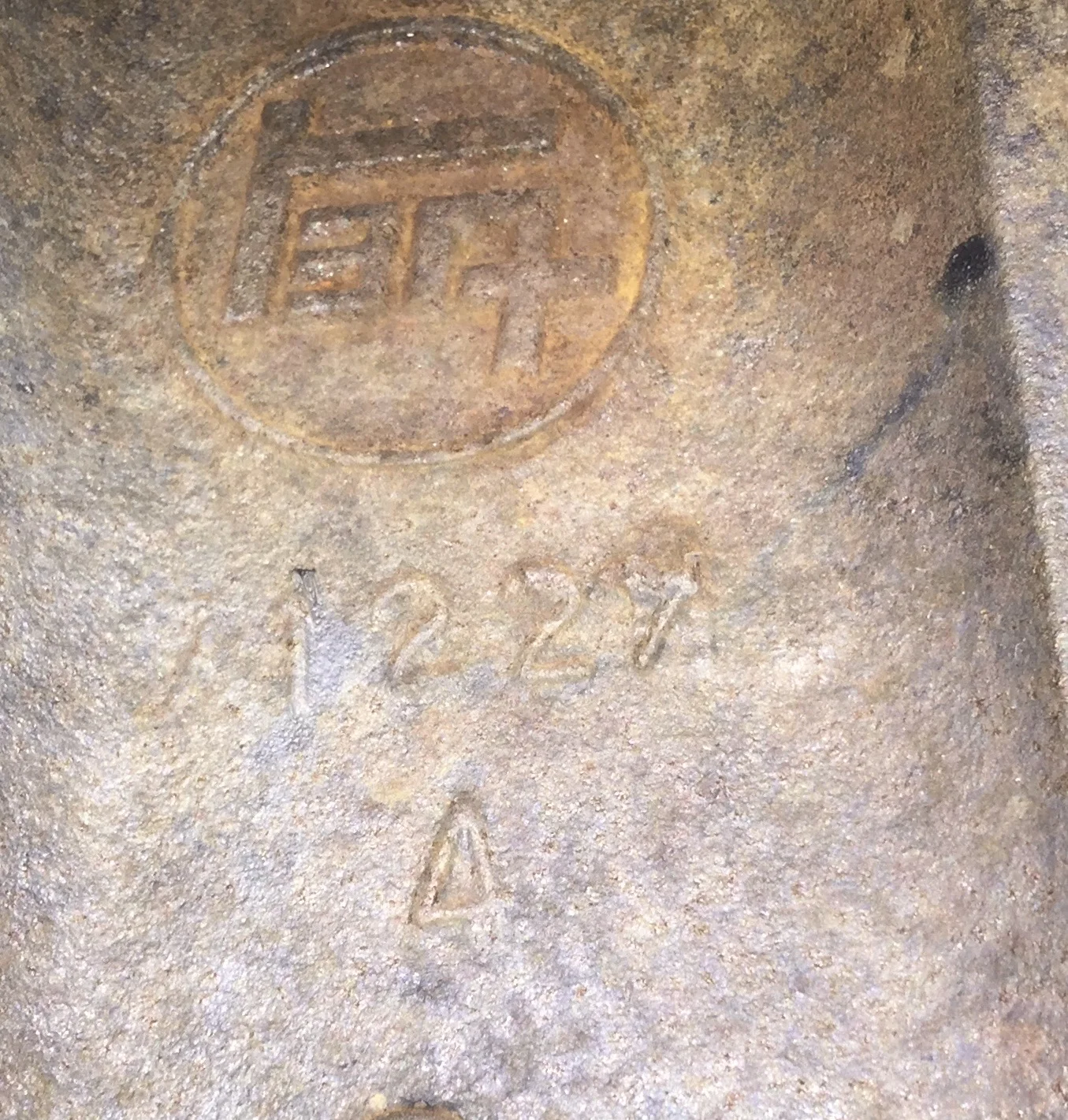

There is a date code cast into the block, under the exhaust header, forward end of the engine. The fist digit is the year (6 = 66) then a 2 digit month and a 2 digit day. Motors were generally cast 2 to 3 months prior to assembly into the rig.
Picture if from an early 68, build date February 1968….. you can barely see the 7, followed by 1227….engine cast December 27, 1967.

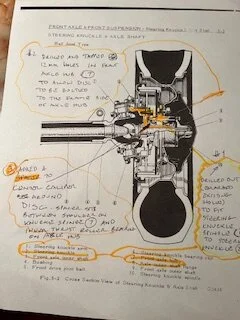

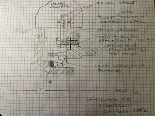

Here are some very rough sketches of the modification to allow the front axle of a 1966 FJ40 (1968 title) to be converted from drum brakes to disc brakes.
Had to use the steering knuckles from a FJ40 front axle that had disc brakes (not sure what year) to have the proper caliper mounting "ears".
Modifications included:
1. Enlarged holes on the flange that mounts the Steering Knuckle Spindle to the Steering Knuckle

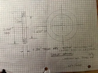

2. Added a spacer between the thrust shoulder on the Steering Knuckle Spindle and the inner race of the inner tapered roller thrust bearing
3. Drilled and tapped a set of holes to allow the disc to be bolted to the Front Axle Hub. Stayed on the same bolt circle as the wheel mounting studs.
4. To be done: Machine a spacer (appx 1/4 thick) between the wheel lugs and wheel to avoid interference between the calipers and the inner face of the wheels.
I have not done any stress analysis on this modification (nor do I plan to and If I did I would use Solid Works). However, I believe there are no significant additional or higher stresses placed on any component, and I do not plan to race or highway drive this vehicle. Hope this helps.

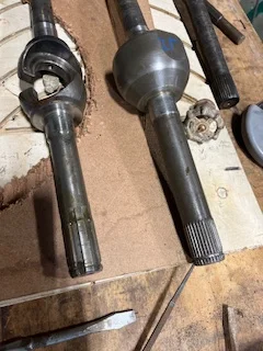

I reached out to Cruiser Outfitters for technical help. By the way they are extremely helpful and professional. I mentioned above the spare front axle with disc brakes as being from a newer FJ 40. In fact it is from a FJ 60. The text in italics is the response when I asked this question to the Cruiser Tech: "On using the complete FJ60 axle. Only the long side of the axle housing is longer (~3") which when under the narrow 40 series creates a fitment issue with the differential and the leaf springs. It requires specialized spring hangers and parts and/or "outboarding" the leaf springs which is significantly more work."
The picture above shows the difference between the two axles inner shafts. The left is from my FJ 40 with a ball joint. The right is from the "donor" FJ 60 axle, which is much larger diameter and uses a Birfield type CV Joint
