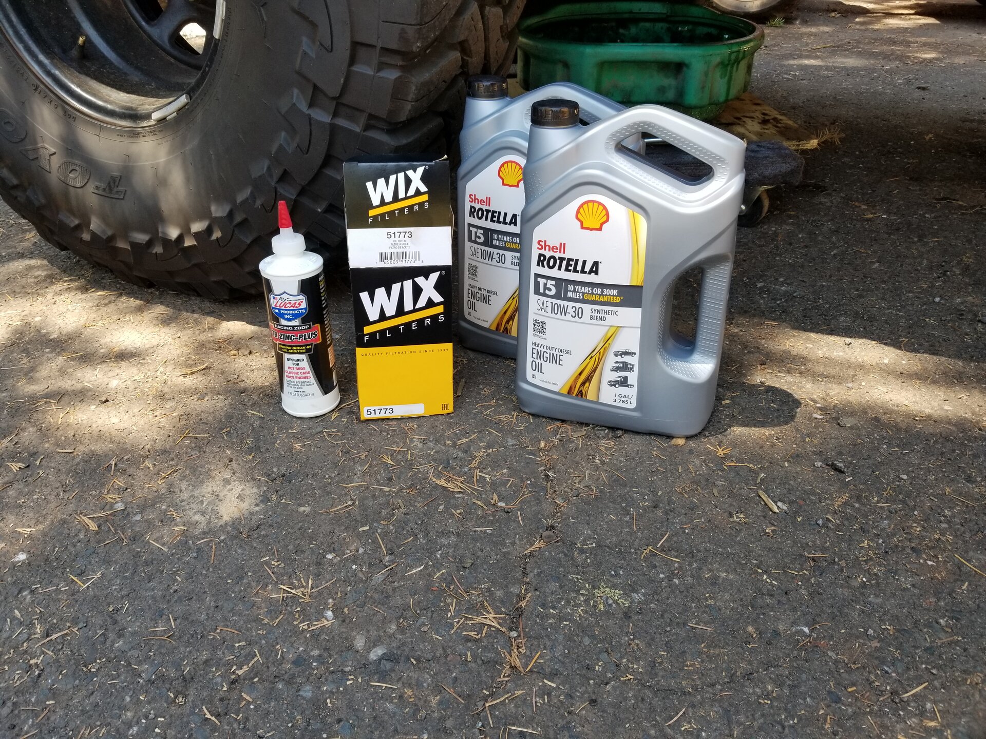

But I do indeed custom blend / mix the Valvoline fully synthetic ( ( non-zinc rich ) formula , because I do have newer updated stainless steel aftermarket high-flow catalytic converters , that were installed very very well along with a all stainless steel properly tuned back pressure for a 4.0L 6 cylinder TOYOTA engine , this hand made Kustom OEM manifolds back system was installed by the P/O and I have no reason to remove it , it was a recent needed replacement / repair …
If I was not running a catalytic converter , say a 8/80-9/87 2F FJ60 , same in kind to my 1983 FJ43L-KC general counties platform which never had a smog or emissions system to begin with , I would and do the exact same approach above ⬆️ and below ⬇️ here , except I do use a stand alone ZDDP zinc rich additive to my motor oil in the 2F , I have yet to find a API certified zinc rich ZDDP formula that comes pre-mixed in a fully synthetic 20w-50 and also the 10w-30 / 40 to achieve my best possible viscosity blend and ratios in the winter months ?
Same , I run straight 20w-50 in it Summer driving season and add the ZDDP additive ,
I should note here : I have never seen any TOYOTA a print media back in the day that talks about the whole ZINC formula and the Land Cruiser F series engines , nor …the topic of NOT using it in a Converters equipped 3F-E that at the end of the day is a solid lifters , adjustable tappets and lobe or lifer contact and adjustable push rods to the beveled tops of there solid lifters same in kind to a 1962 SIAMESE F FJ40 engine …
20W-50 and either 10W-40 or 10W-30 depending on if I can actually find the MOBILE 1 high mileage 10W-40 , it’s becoming harder and harder to locate and source both MOBILE 1 ‘s fully synthetic in the unique high mileage formulas .

Where do you find your 20W-50 and the stand alone additive?
O'Reilly's
we sadly do not have any O'Reilly's around the Central Atlantic Region for some dumb azz reason ? :confused:

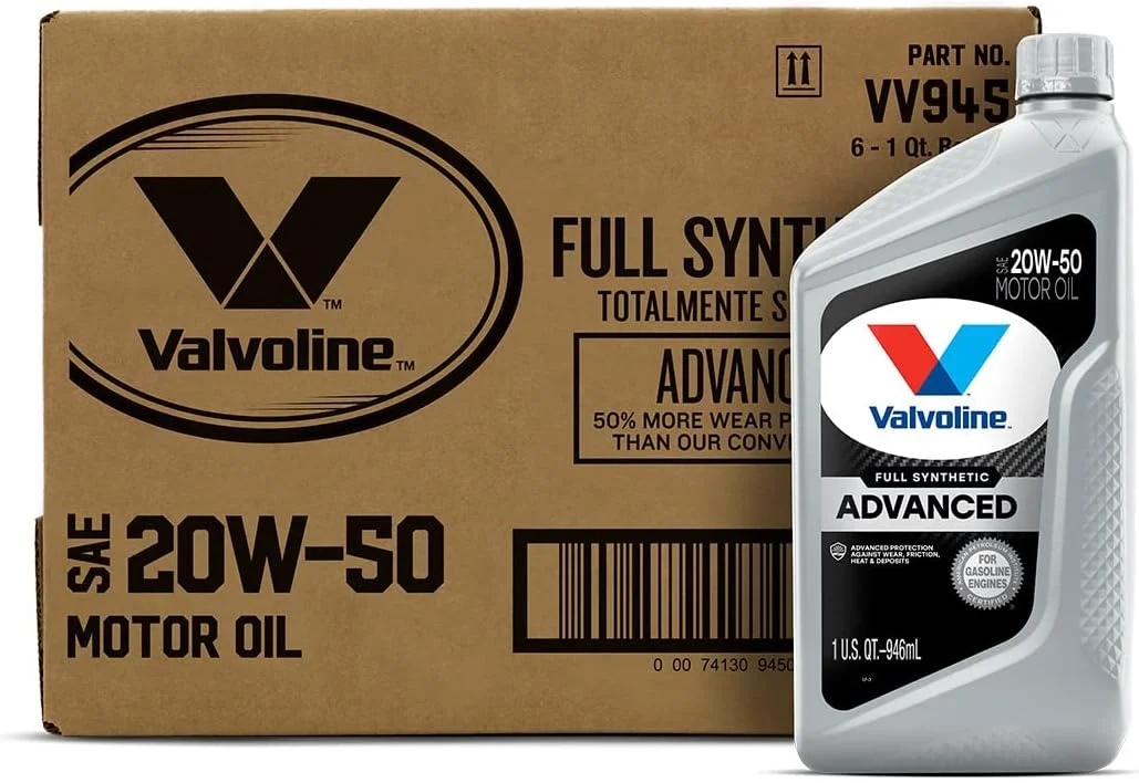

i have always held my local NAPA Auto Parts store as #1 in the highest regard place for all the good goodness , like we are discussing here above .... ZDDP / ZINC Rich stand alone additive wise .....
- i concur 100% with fellow
tech-savoy member and everyone's Solid MUD Buddy too.. @Pighead .... , the LUCAS oil products additives and supplements brand line up , i my personal and professional opinion is the TOP-TIER A+ TOP-Shelf smack as far as this goes .....
- i use have and do use , and apply several of there products for the long and longer term in all my TOYOTA personal fleet ..........:idea:
- i will save all the the kool 411 on my Fully Synthetic LUCAS product testimonials for another time , and try-hard to stay on topic here .......😆
- you do not have to stick to the NON-ZDDP / non-zinc-rich Valvoline 20w-50 fully synthetic formula like i have to in GHOST's 3F-E catalytic converters equipped motor .....
- this below is what i personally choose to use in any older no-cats F series Land Cruiser engines / 1FZ-FE and older ....fyi and add the LUCAS Zinc to it , mainly because it is API , and the latest SP grade certified too !
- this is what matters most to me , bottom line ..
- i purchase it now through AMAZON , they have the latest updated product container Labeling info on them as well , ....fyi
- this matters less to me , but i should share this fact , as is important to everyone as it should be ,,,,,
- current Prime to my shop door , on a 6pack case is $51.20 = what ever local sales tax , u get taxed on by your local MAN ?
- that's $8.53 per QT. , my state sales tax , and it's still , under $8.99 per QT. !
- that is a fair shake in my world , to get what i feel is the best dam possible motor oil for my needs and want's ...:idea:
- i hope this helps you make a solid better more informed decision moving forward ........:)
matt ..
