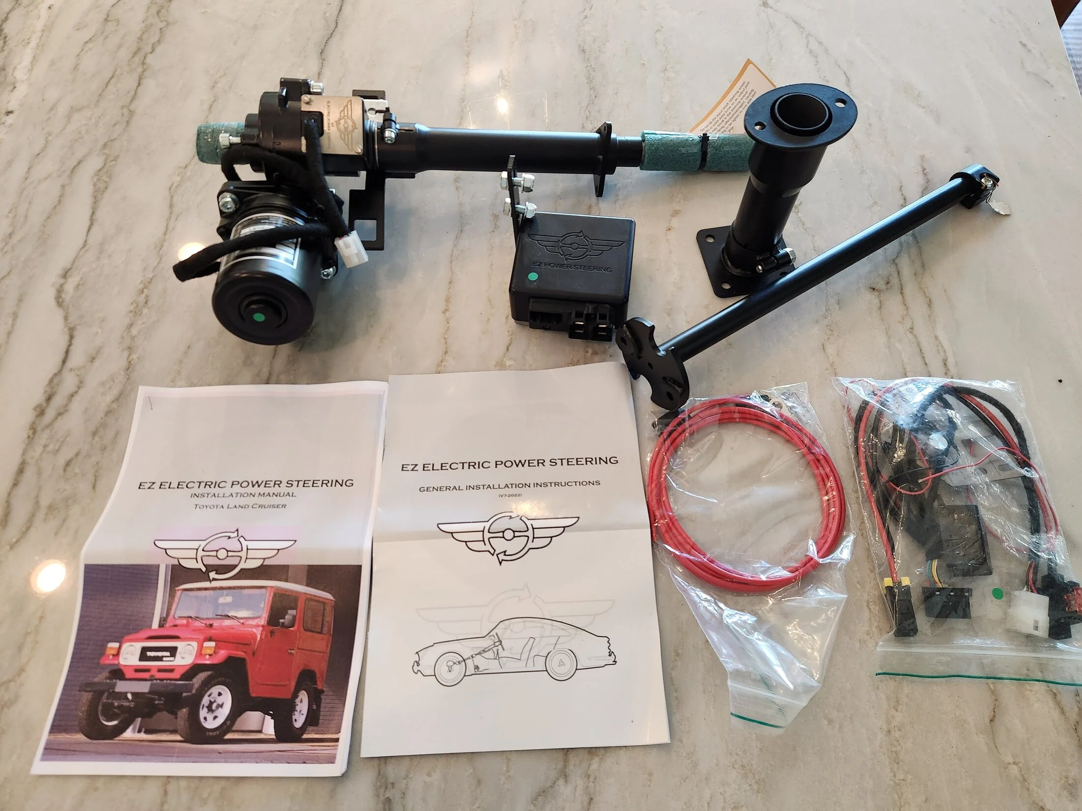

Anyone use this on their rig yet? If so, likes/dislikes? Install process? Pros vs. Cons?
CITY RACER ELECTRIC POWER STEERING
I’ve installed 3, a really great upgrade for those that don’t have huge tires and don’t wheel hard, almost drop in. Pros- straight forward install and self contained. Cons- none if you follow the directions and plan your work.
Just installed mine a few months ago and I’m happy with it. Installation was pretty easy and well documented. It’s expensive but worth it if you don’t want to spend time piecing together your own system.

My 78 has had the City racer EPS for two years now. It is a dead simple install and works reasonably well. There were a few times when running the Rubicon where a bit more assist would have been nice but for 99% of the other miles it works great. With castor shims and well maintained factory components the steering feel is great, no slop, hunting, or vagueness of any kind.
i would 100% do this conversion again.
i do have a small “kickback” if im turning while idling. I think the voltage is dropping too low because it’s putting max load while the alternator isn’t producing any power. It doesn’t happen at all if I’m driving and I could probably increase my idle speed to eliminate it but it doesn’t bother me that much.
I was wondering if that was the case. Thanks for confirming it... and that it's not a big deal. Most older Cruiser alternators barely put out below 800rpm or thereabouts so I'm always thinking about battery drain at low speeds. I'll start saving my $.
Mine arrived last week for my '76, packaged really well for international shipping. Will be a while before I get it installed....
To be clear, the kick back I'm talking about is the power steering assist cutting out suddenly so it feels like the wheel hit something. I can see the volt meter dropping when I turn so I'm pretty sure it's the voltage drop causing it. It's possible that my battery is weak which could also contribute to the problem, a new or larger battery probably won't drop as much voltage under load. It only happens if I'm completely stopped and turning while idling all at the same time. If I'm rolling slightly while idling, it doesn't happen. Also if I rev the engine slightly, it doesn't happen. In normal day to day driving it's not a problem, but for someone building a rock crawler where they would doing a lot of steering while at idle a hydraulic system would probably work better.
