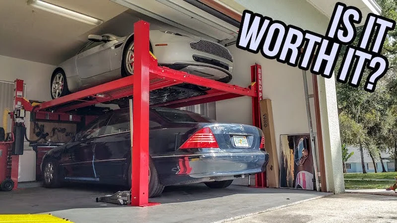

This image is from a YouTube video, but even the picture sort of illustrates what you're going to run into - namely that you can get to a strip down the center of the vehicle but it is going to be difficult to get to much else. There is a sliding plastic tray under the front of the lifted car in the photo to keep oil (and such) from falling on the lower car. That can be slid out of the way or removed if you're actually trying to work on things.

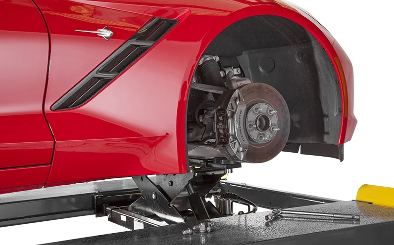

You can get a "bridge jack" that rides on the rails of the lift to allow you to do things like take the wheels off, but it ends up further getting in the way depending on what you're doing.
