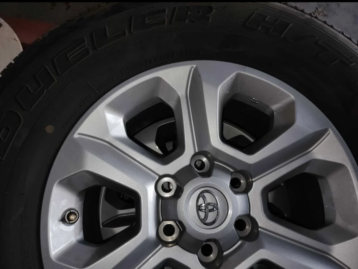

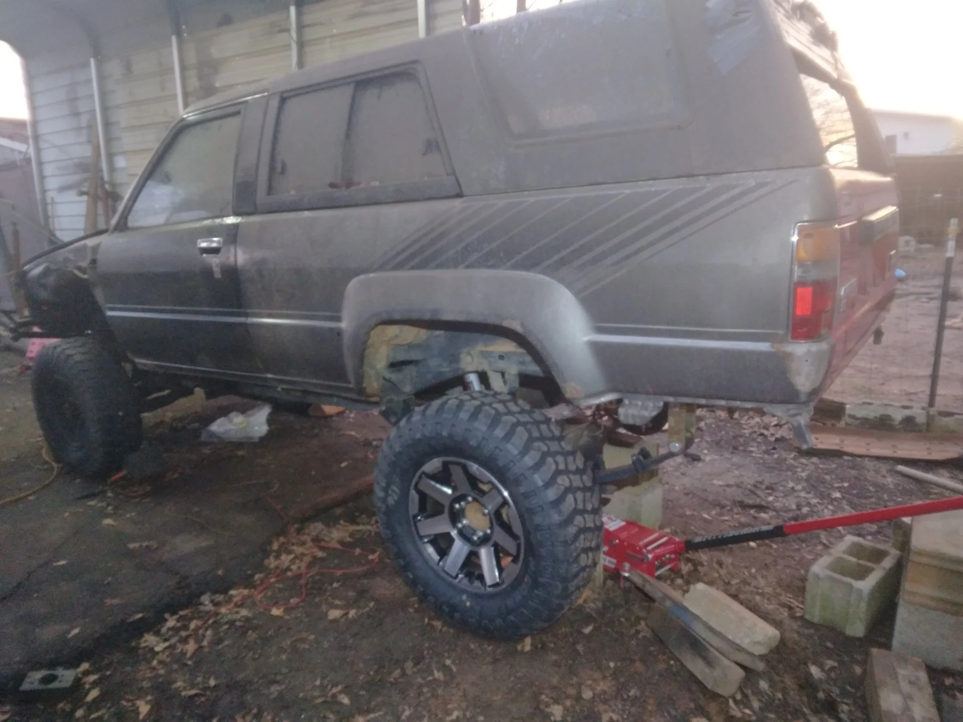

These are 17x7.5 and came off an '18 or '19 trd pro 4 runner. 285 70r 17s

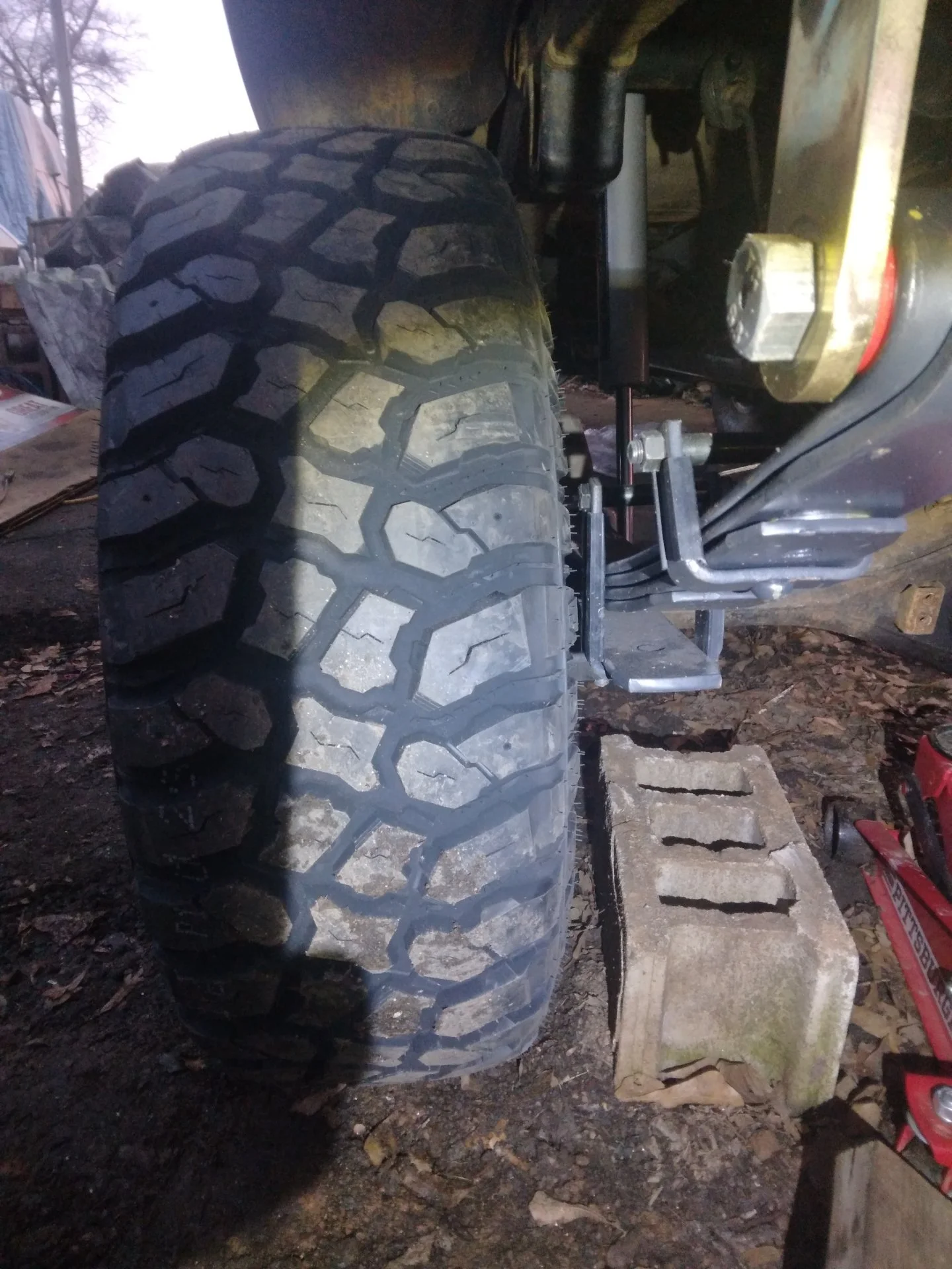

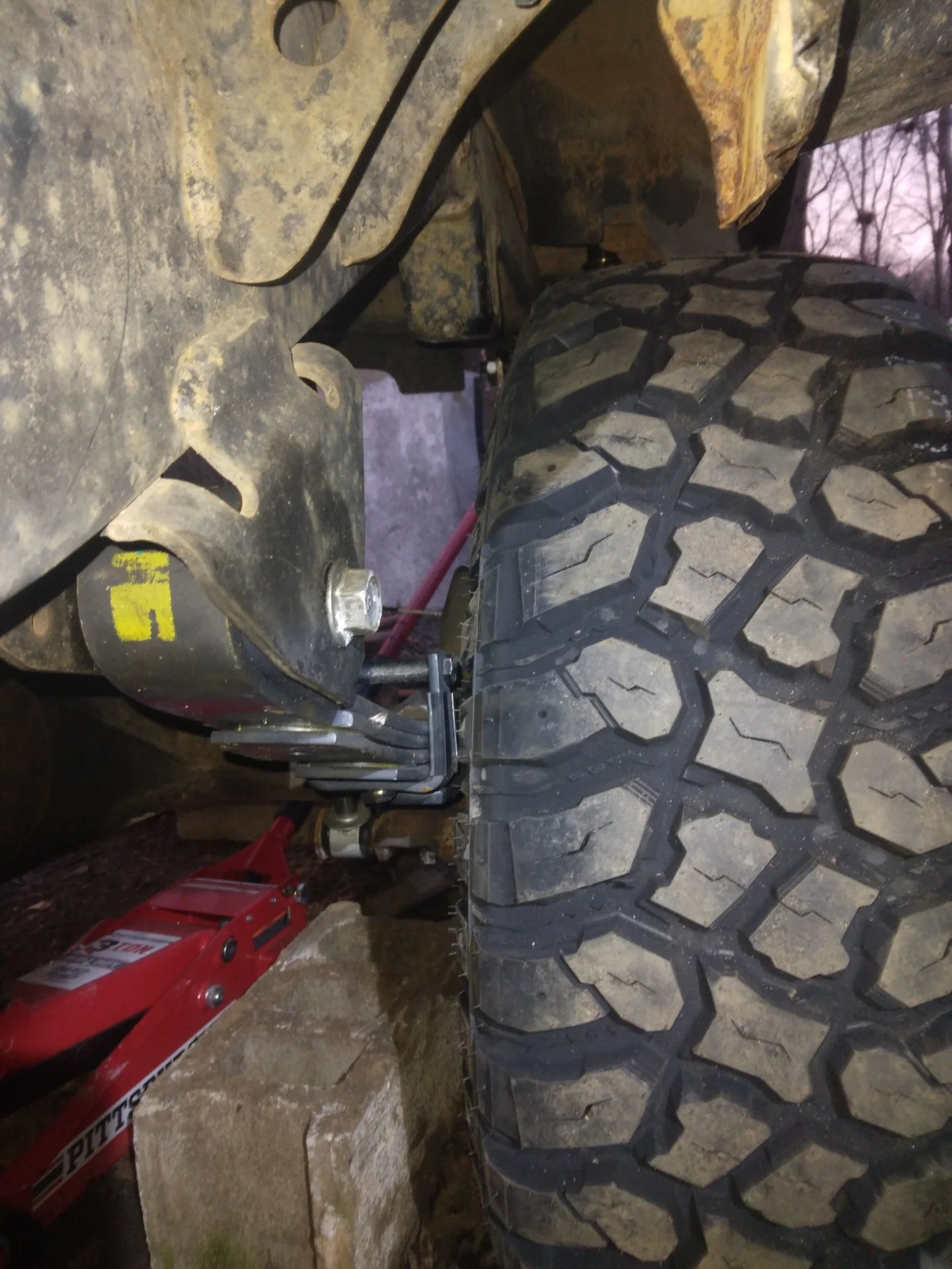

My rig is an 87 with old man emu 2.5 lift rear springs, 1.5 inch bj spacers and 2 inch body lift(to clear the diesel under the hood)
The rear tire hits the leaf springs U bolts. The front tire hits the upper control arm.
1.5 inches of spacer would allow me to air down off road or pull off the side of a highway with a flat.
I cannot find hubcentric spacer that fit manual hubs and I cannot find lug centric lug nuts to fit stock yota aluminum wheels. Anyone have any pointers?
Also, I think I should have gone with 305s for 315s
I was just running "regular" AL spacers on mine to fit my 7.5 FJC alloys.
If you have to have branded spacers, I recommended Spidertrax.
I actually just bought a set of these wheels to replace my FJCs. Showing the same BS, i don't remember being into the rear springs.(with the FJCs) Obviously close otherwise i wouldn't have added spacers
Thank you for the response. 1.5 inch spacers (cheaper ebay but upgraded grade 8 hardware and extended fasteners) gave me perfect clearance. The tires stick out further than I like, I like the tucked almost pizza cutter flush with the fenders look of the old school rigs, now I stick maybe an inch past the fenders. With all my lift i don't think i have to worry about scrubbing unless maybe she's flexed out. Vibrations at on road/highway speeds are what worry me most. I used extended reach inner lugs with loctite and installed all lugs torqued to 90 ft lbs. I'll tow it to a shop for the alignment but that will be months down the road.

They will fit but front tires may hit upper control arm. My tires are 285 70 17 and hit pretty good. As stated in previous I went with 1.5 inch spacers. Lug centric in front (spider Trax) and trail gear hub centric in rear. ARP wheel studs and extended reach inner lugs for added safety.
With 265s you may get lucky and just need a 1/4 inch wheel shim spacer and grind a little metal off the outer upper control arm lip.
My wheels are off of a 2019/2020 4 runner

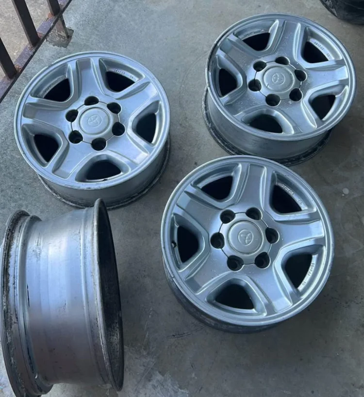

This is the right thread. 265/70R17 (31.5x10.5x17) is not a crazy size so that shouldn't be an issue. You may need about an inch spacer depending on the offset/width/spoke profile. Factory alloy wheel is a 15x7 with an 8mm offset and can run 31x10.5in wide tire with no rubbing.

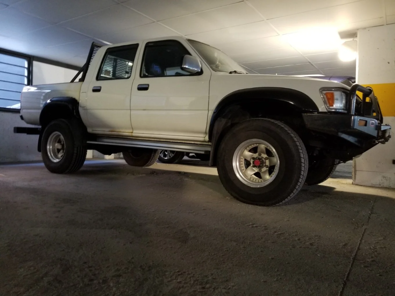

If you can look at the ones on sale, the offset will be on the rims. ET 10 etc. I'm running 17" FJ cruiser rims, 7.5" wide on my 1990 pickup. They rub slightly if you hit a bump at full lock. 285 70 17 I think, IIRC. Truck has a 3" lift.

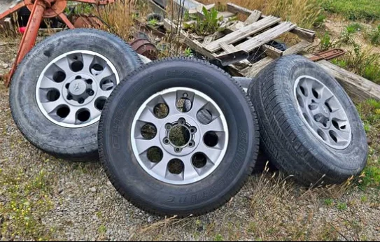

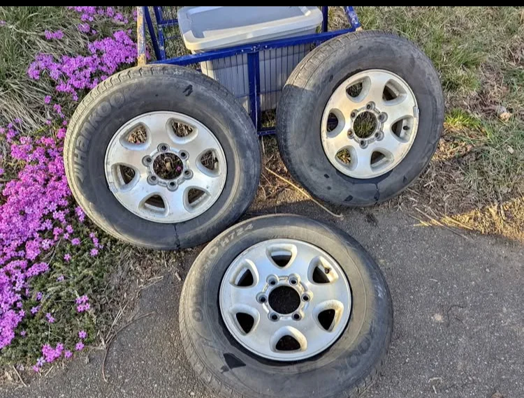

Attempting to revive this old thread. For the 79-88s, are there any pics of 3rd gen 4Runner or T100 16” wheels or the 17” 8-hole wheels that came on some 4Runners and FJ Cruisers around 2010-2014? Curious how they look with the later model styles, also considering different tire sizes available in the different rim sizes. Pics for reference:
Back spacing on those newer wheels is too deep for a solid axle truck. They won't fit without a spacer. They might be OK on an ifs truck
