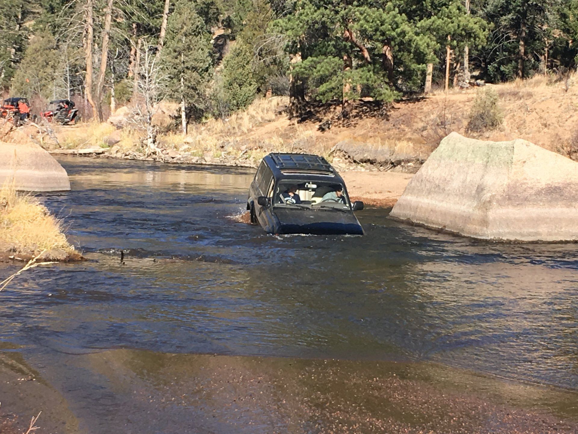

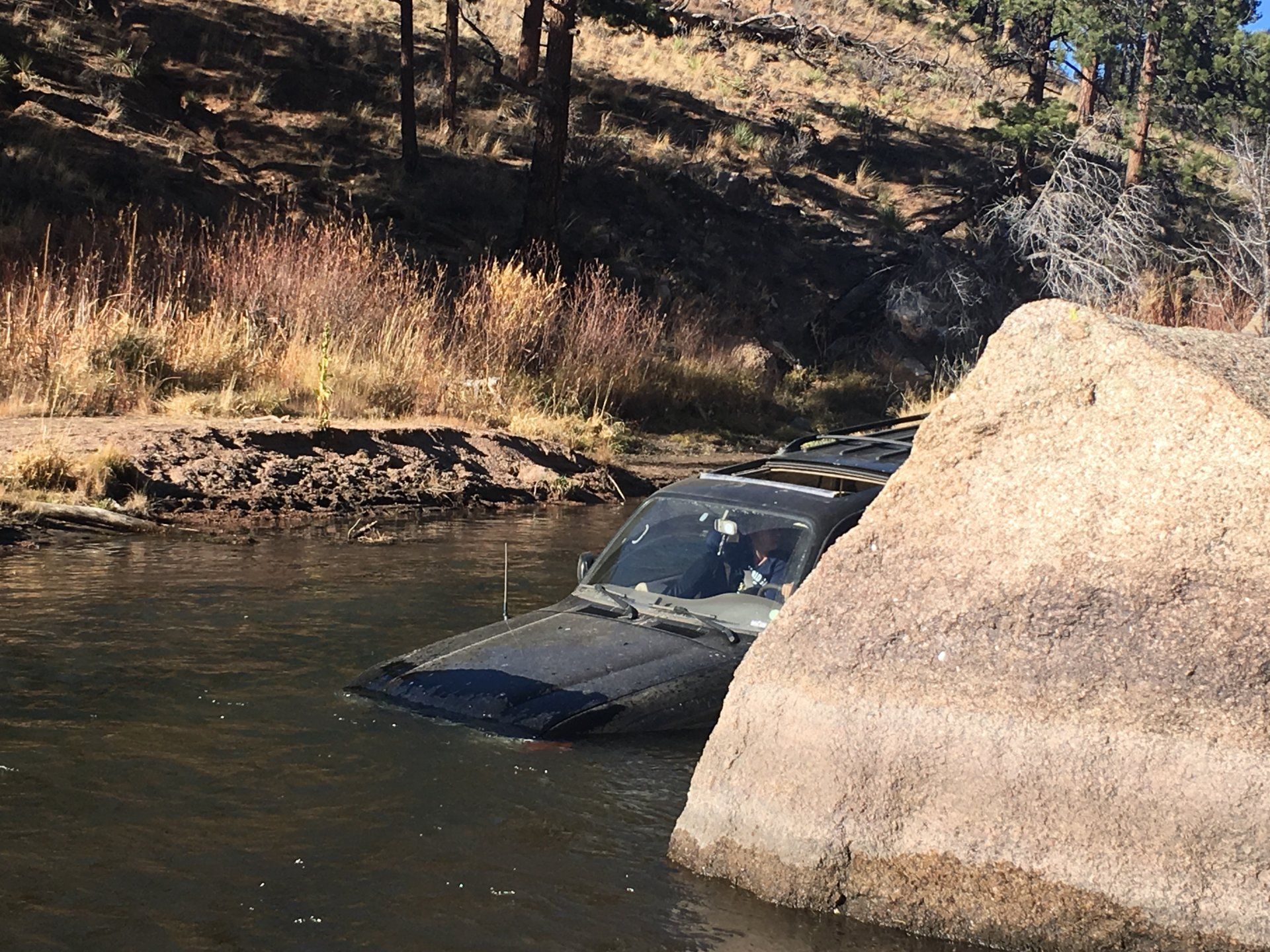

Few weeks ago I made a poor choice and went through a water crossing that was a little deeper then I expected. I cut the motor when it started to stumble and got towed out. It sat in that water for proabably a solid 5 minutes. Pulled it out, let it dry and it fired right up. Stumbled for a while but cleared up pretty quick. 2 weeks later with all the fluids changed you would never know what happened. All my electrics were good though since I didn’t hit it with any speed.

lol, what were you thinking? you should have known that where it gets narrow and next to a boulder it was going to be deep. you can tell by the deep blue color too... bet you wont do that again!
