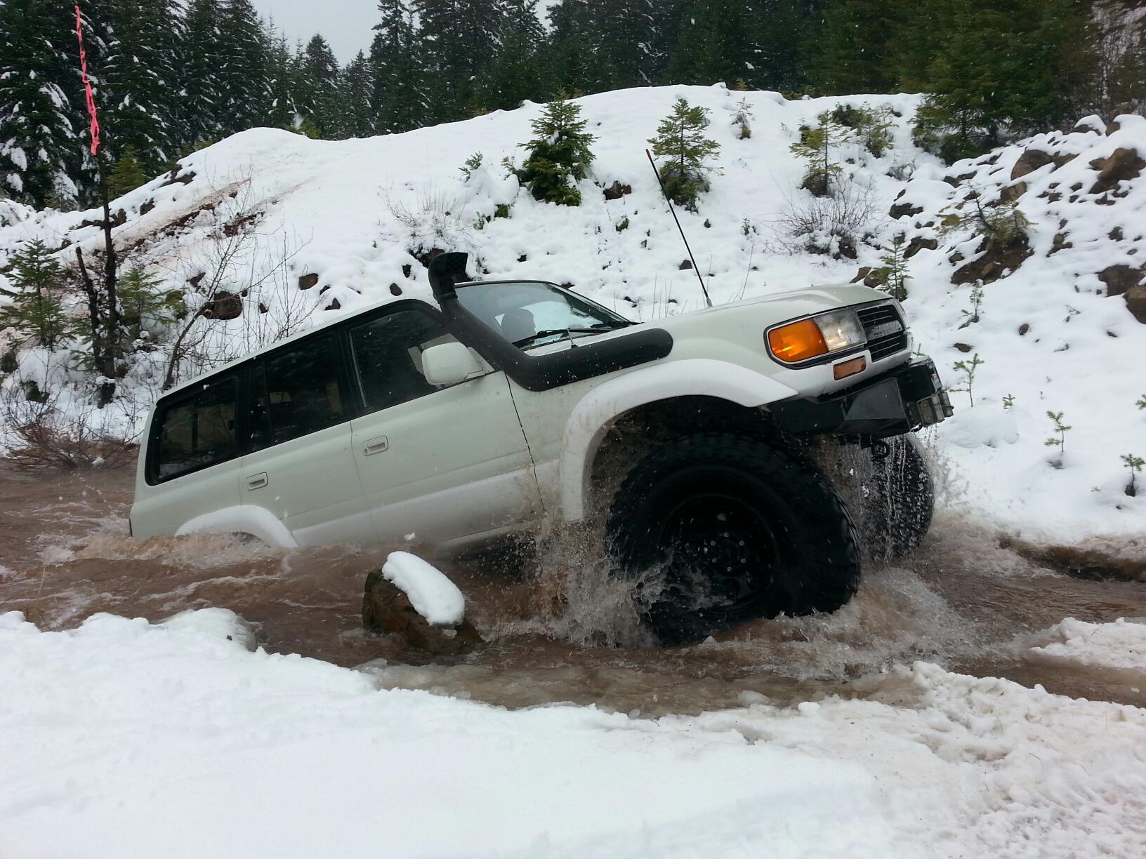

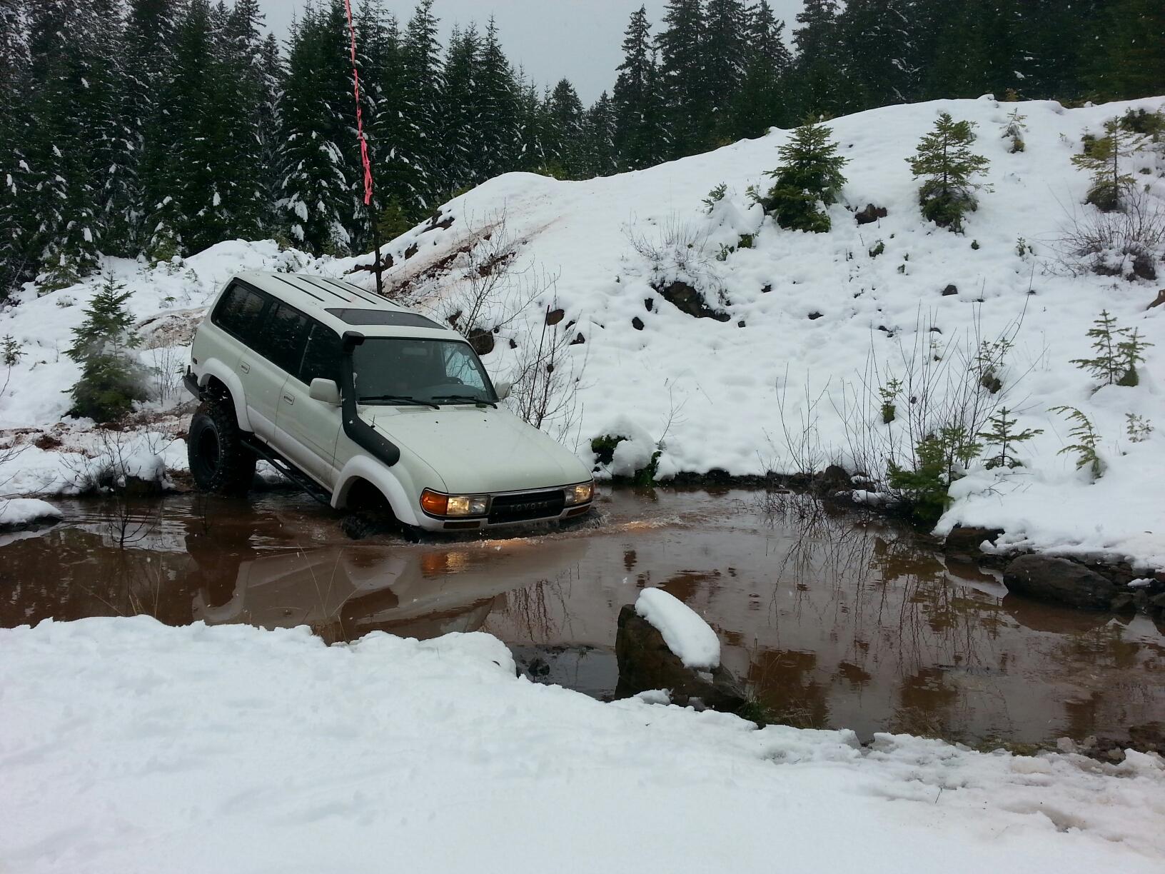

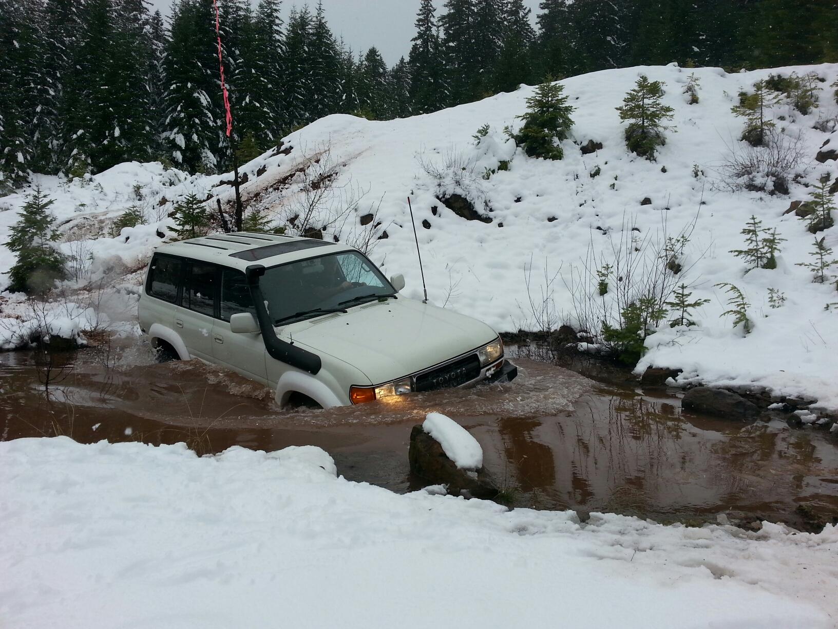

Umm...year before last on our annual coast camping/wheeling trip all my buddies in their jeeps were driving through the edge of the surf.... I went full submarine at speed for a good 20 yards and managed not to kill it. I got out and shut it off to check the air cleaner which had probably 2 inches of water in the bottom. Dropped the tuna can to drain it and carried on. So...not sure what your deal is. Also here are pictures of my cruiser birthing the icy waters like the big white whale she is and not a single issue. Don't blame your cruiser for your neglect.

That's not the beach Timmy, it's clearly in the woods. I don't have the photo of the beach. I only get wheeling pictures friends send me, I don't take pictures when I'm out wheeling, I just wheel. Point being that a small puddle shouldn't stall a properly maintained cruiser.
