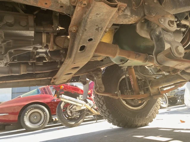

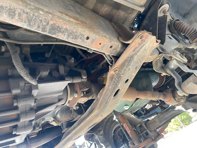

This doesn't look good. Got my rig shipped back to me, new to cruisers but man I don't think the driveshaft should be touching the motherf***ing frame right?!??
Had it tow strapped a couple miles is all, installing rebuilt engine rn etc.
that looks to be the front drive shaft contacting the front crossmember correct?
Mine did this from the lift i put on (70 series tho, but applicable) , yours looks to have been rubbing for some time, i would get that shaft fixed
then clearance the crossmember, i cut and re welded mine for some room when its flexed out
what lift is on it?
1 piece crossmember?
is the engine installed?
If the engine is not fitted then the drive shaft is just going to flop about.. Not sure if there's anything else going on other than this??
Engine is not installed. dirveshaft is hitting cross member. How do guys retrofit this normally?
without the engine installed the transmision and transfer case will tilt rearward, front of the trans will tilt upward, all on the trans mount attached to the crossmember

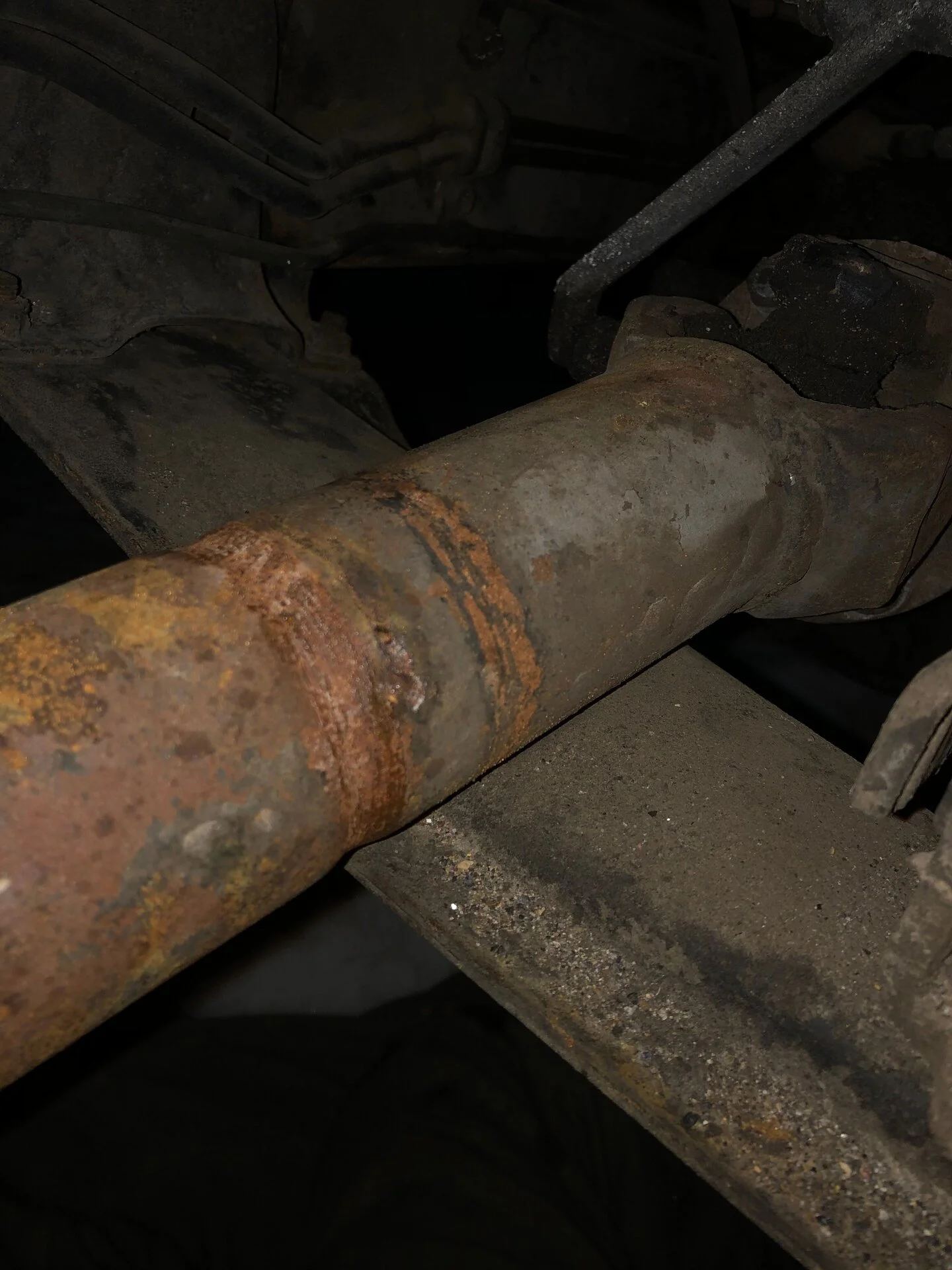

with this tilting action the clearance between the driveshaft and crossmember will be bad and interferance will occur, by the pics
if the transfer was in 2H and the hubs unlocked the front driveshaft would not have spun, causing the wear shown in the pic
you will need the driveshaft, re-tubed or replaced
Do rectify this issue, could I add spacers underneath the transfer case, or will I have to cut and reeled as mentioned?
Trying to get the engine mounted ASAP> The clearance was definitely close before the engine was pulled, according to old pictures (see photos attached). Let me know if you guys think I can run with it as is, my main goal is just to get the rig running even if the clearance is close. I will get the driveshaft retubed regardless ofc.

Was about to take off driveshaft, but seems like its somehow counter balalncing tranny weight since engine is off. Going to transport it back to our holidng lot as is. Its about a 3-4 mile drive. Will have the hubs UNLOCKED,.
PS it seems like that grinding wasn't from me. I think the gash is old and from the previous owner installing lift and not checking the crossmember clearance for some time. Might keep the gouge as is and just drive it.
