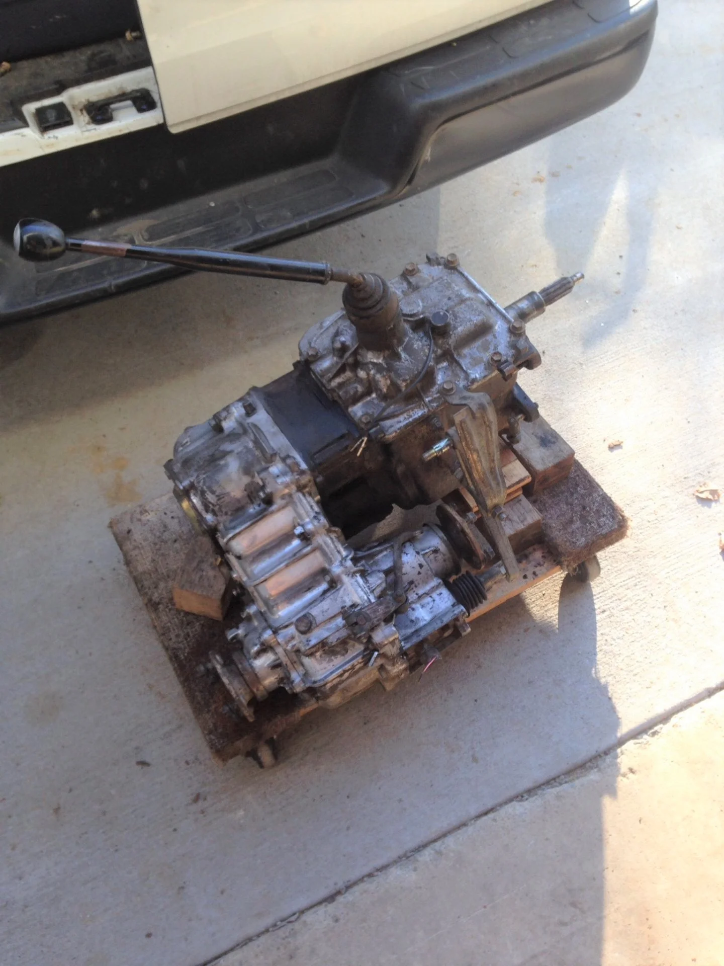

Driveshaft clearance: Anyone know what the f*** is happening here?
Had a cruiser head friend look at it. He said that I need a new crossmemebr. I’m getting some popping in the diff that could be related to the input shaft being at an angle. Apparently the cross member is dented. I can’t get a new one for at least 2 weeks…
the question is: is the transmission input shaft supposed to be angled up AND sideways with the engine out, or is he right that I need a new crossmemebr …??
Your crossmember is fine.
It doesn’t matter what the transmission does when the engine is out, you’re not driving.
