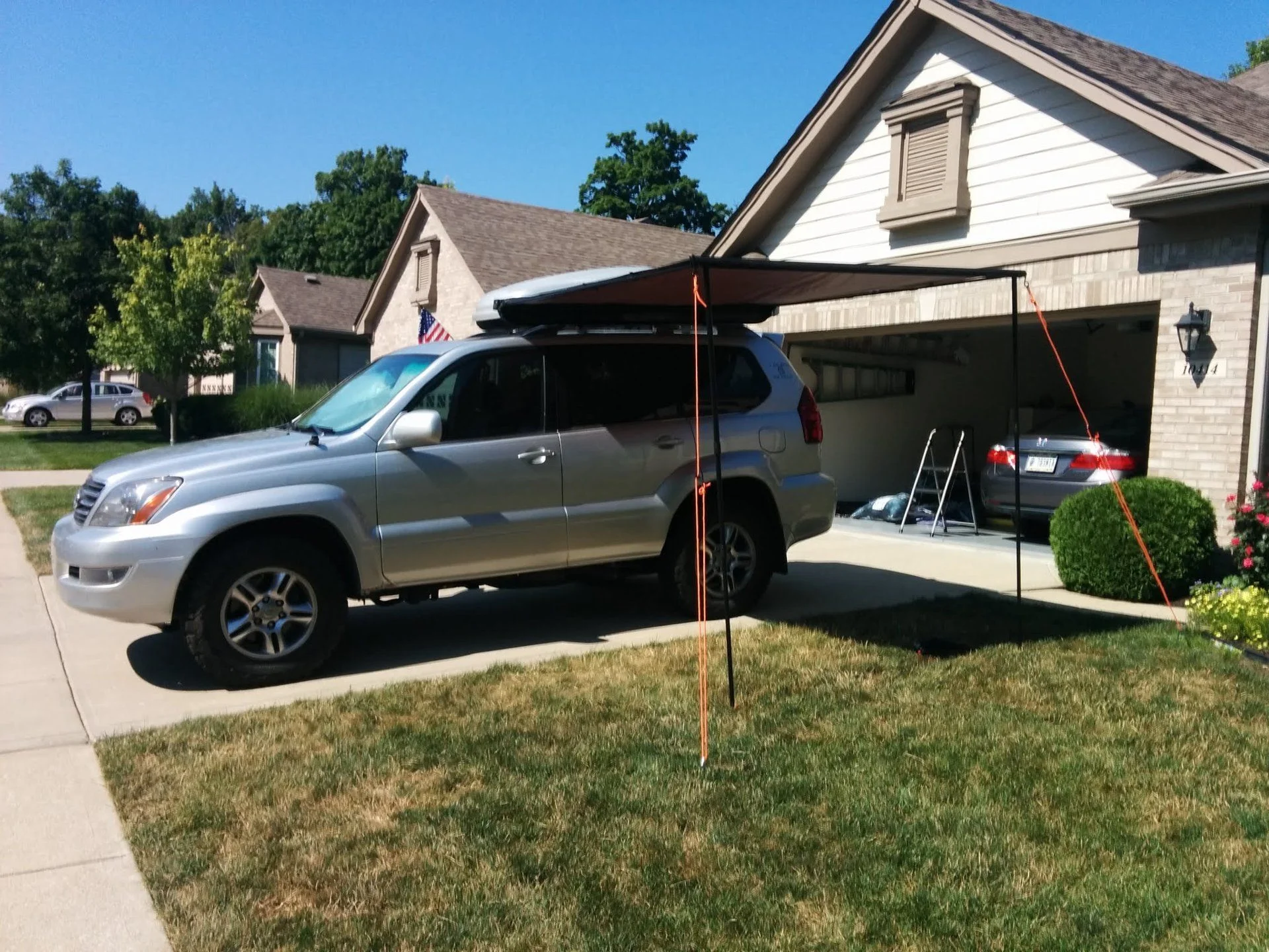

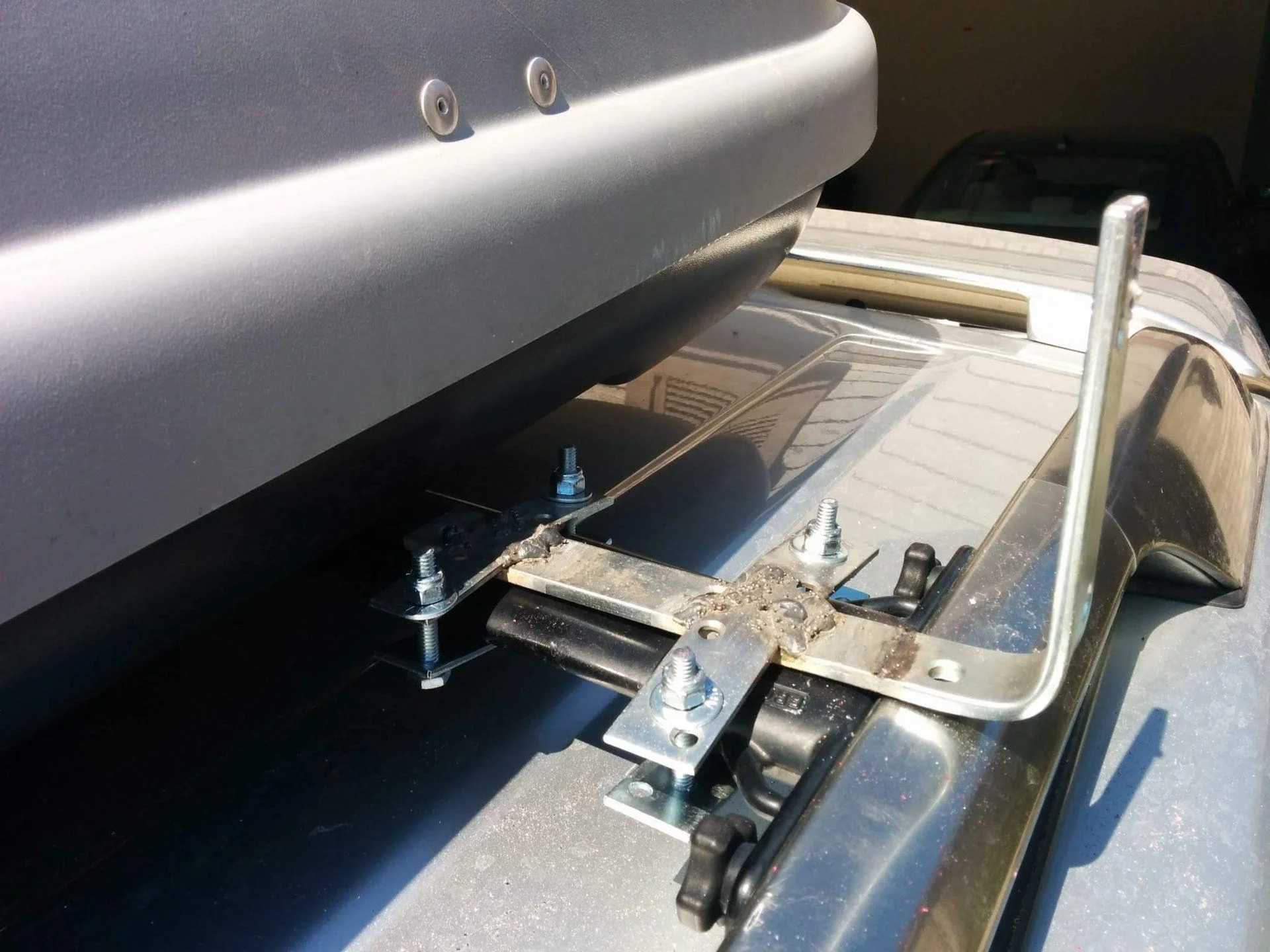

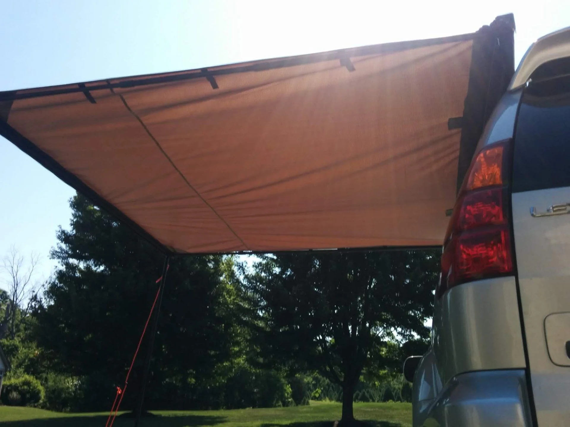

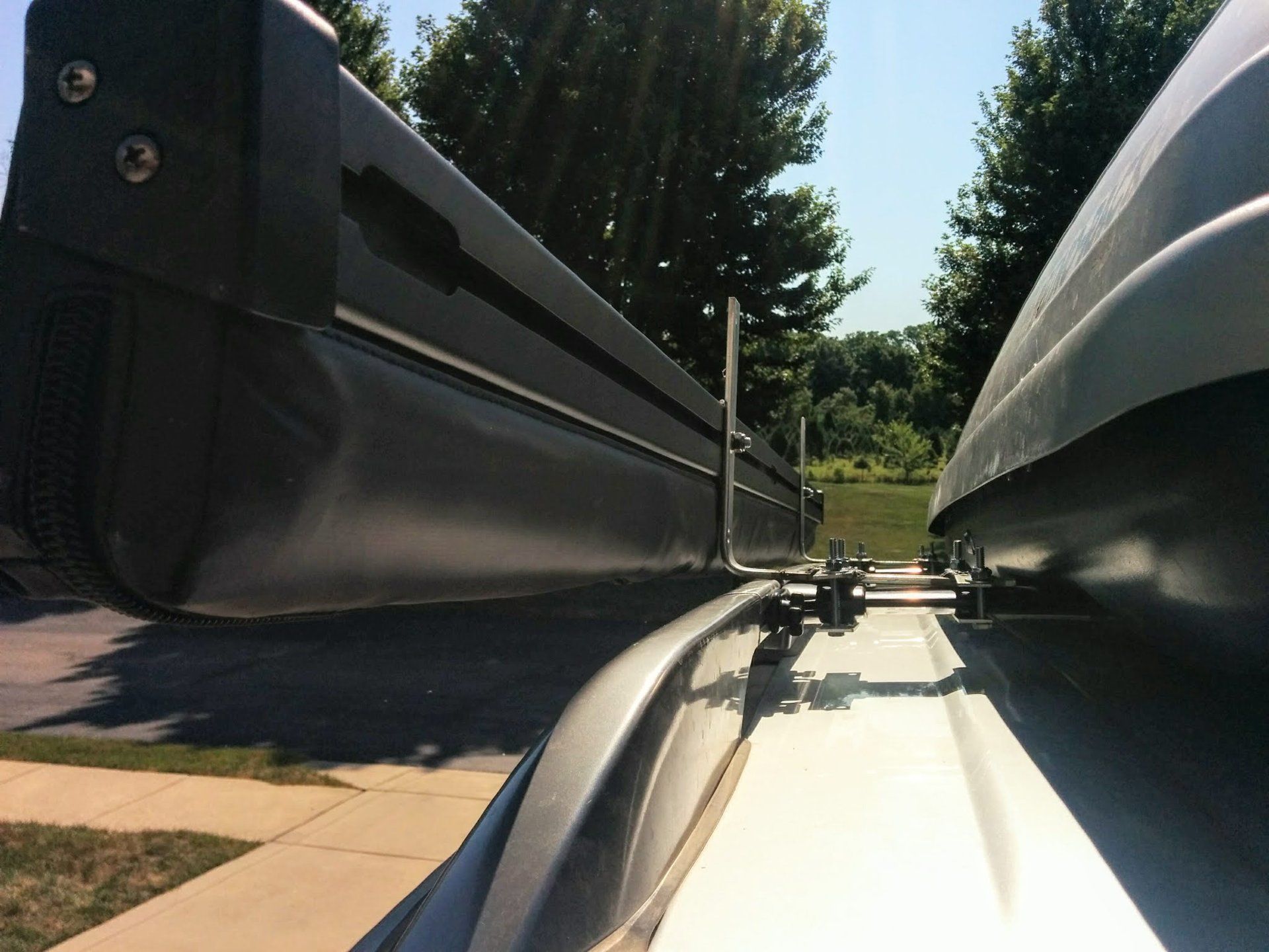

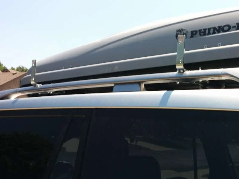

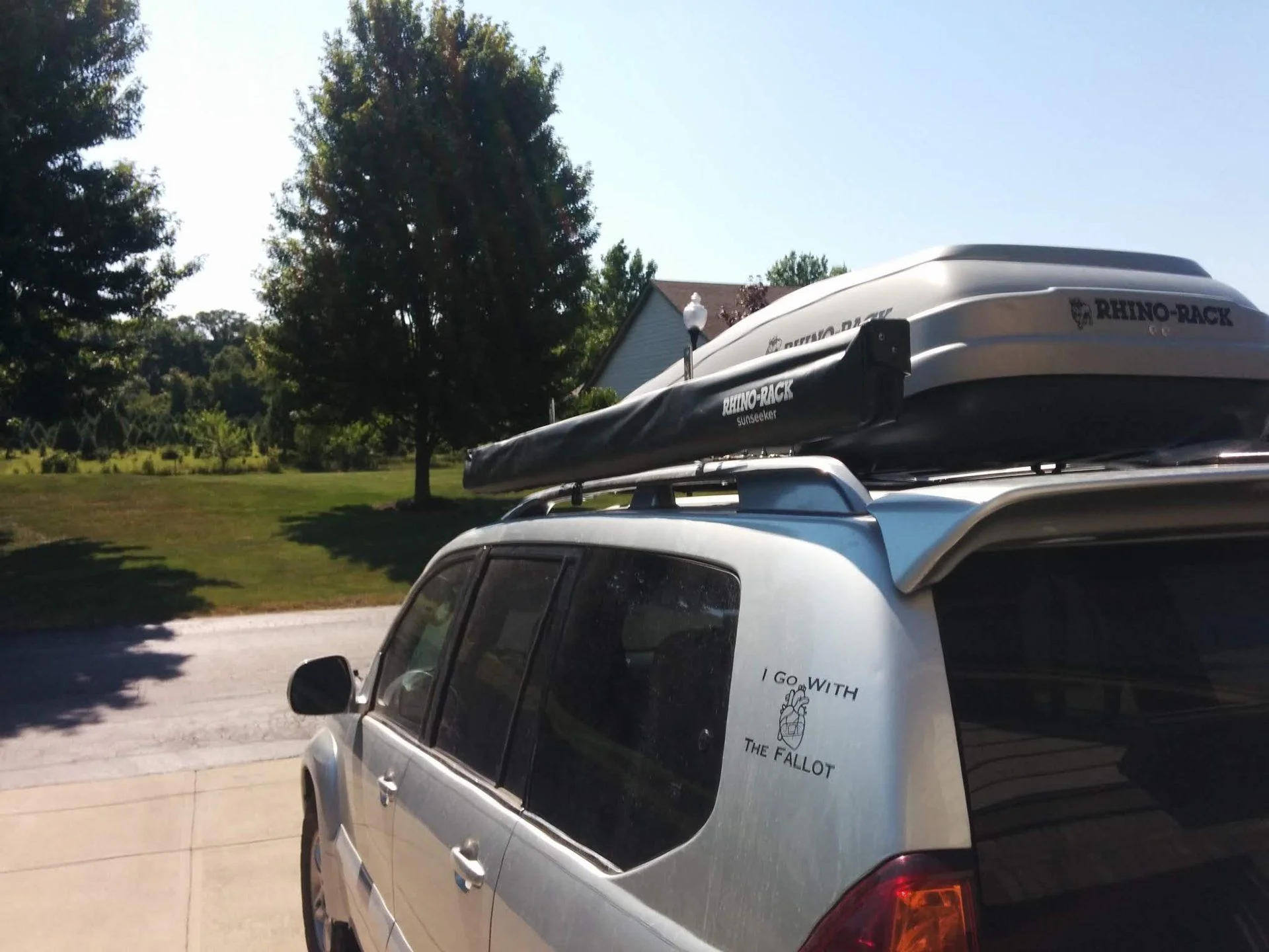

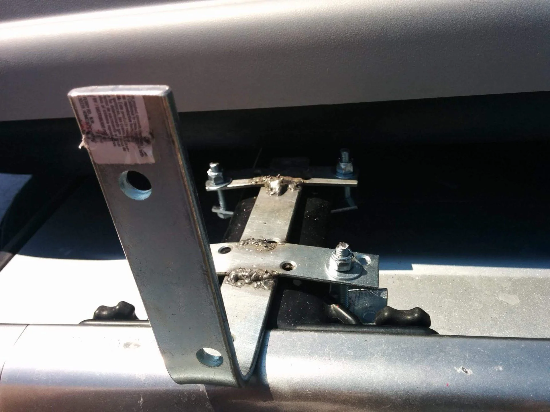

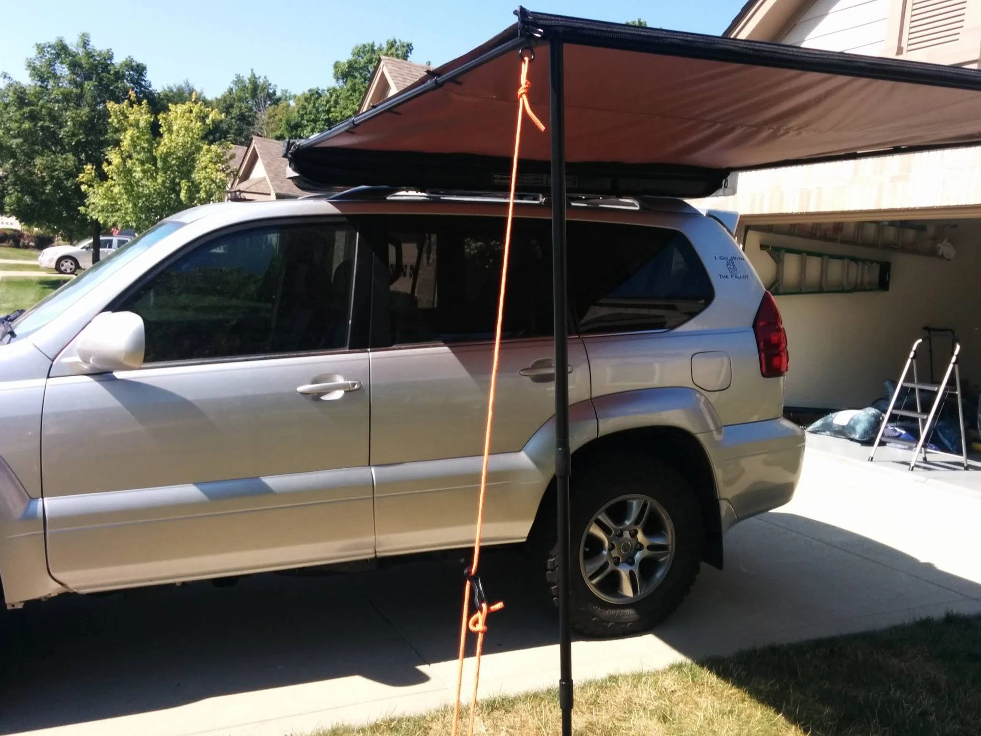

braces "welded" with crap gear, super ghetto style!! Flip-flops, hand shield, soild core wire w/o gas on a 50' 14 ga cord to a Harbor Freight flux MIG machine!! It was awesome!!!
know this, this is really-truly temporary :rofl:
NOT to be confused with the much more common temporary-permanent as quick jobs can be[come]. :cool:
It securely holds the awning for shade deployment... With the clamp on, I may even mount the thing (cam strap it to the rail) and drive with it for the remainder of this road trip..... hmm ;)

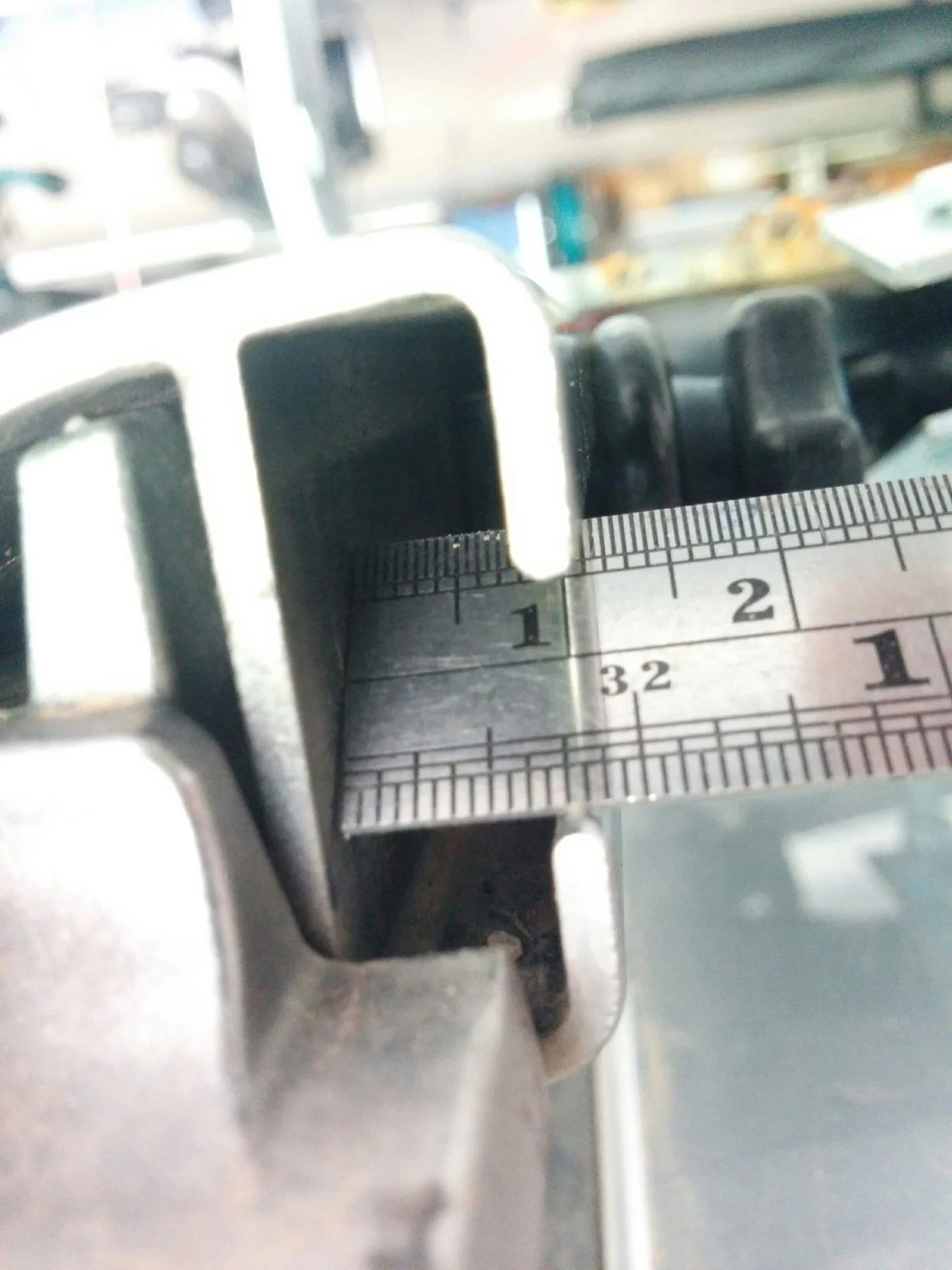

Kudos @teejnut for stimulating the my roof rack thoughts and getting the wheels turning on mods up there...
I like the extruded aluminum crossbars he chose (tnutz and 8020) and noting the factory side rails have slots I got to thinking about ways to make cross bars initially based on his plan.
I got into the rack today to see what's the what.
The rear cover pulls off with 4 friction clips easily popped by pressing down and using a plastic pry bar to leverage the clips out
f7M56_OJQ9HCVaFt5c-AN6ylY3B52ZozWdL-_fPacS_HL6WhiIf8h3ooeNld4jk_d-zpfVqBu8Ie7zF7-lSP7dUpyC7kZQRaNIIGanTwR4aHi6ZghDK2L8hCrWOWid9lQC4FNdMY96SxNZIC0itft2y3Y3Ur8tvuehVOEeEBZ07eMn2mC4nznsXmIjlwUkQPso-2OzWU_JL3VEHqlr-lwQ3D4l8YN99MYudbJiyOgDBJWOc7v8oT6jCwqOL7xT_qHyeYwnvK3l2SyaMcVCxqR05rB58gwJ_-RCJqlaeynA35t3MhdP4KqJVSLp9nCVDPYRDOZnfywS7PkNVTqV_1Bgzy3jipEC3E2CiuMLaWpgZ4xciU0la2WJ7GcS5jy9-qlQwiZEm8zibk9-GIMN2mTBLpQEmsLGtgZMMHULFn0OUgREpP_XEla64tljj2HRtgNh78wK27j4oIOnl8VPSVnv7DysJgZ2KD7sLJKzvgQON-nQqx6VVSmIz1tSChjRCfG3fx1YkpNUO4wtgihbl9ToqUeWLTHdyT3R8JrnAPlsVFLd7okTcsvAu8-T6Bq2_3QFv_QQpTPcax87F_vU6Mi1uVoPvhrDtHTT1C66o0lWk0iOXzO9RyBr9xfyzGelk0=w437-h582-no
fUdJfI8g-hzJXDxyVoaoQXIsVSB1SaO23ZWEp41HtSHTIOHu_PSXDHGvhuI5rkiPHxBUy_yQa4vcN4NQkPKjCp-zYKAayd1DHm8WN5qQvLT-OH5xq2_ag9QHT7DLuKABb7hyHhdesTq2s-pBeoOar96KZiNdaQN5agphHz4V6qoIzyvPe5UNRJUvX5iRzTxxvKDA_2unWHkcijXCP2CdU0t7zH9taBI69ezdMJCyREk0yEvmhjd9VRGucebCyQLR_8hJCNP0GQUy1x3wAk_j8uXJFWrk04GCPn3lxHEH_yGVMXKArzk8_9hCDtjVjZV3HyA_qq64h__okIvfKqga6OezJnQVRet2MA8xdwwgLNPBerxpLMElRyddC00Z3OsrfPEAJvJ9Xv2JeD1Sgx29kRW8OjXkxsU2xEAqSgvfcpsS-dytYDqIan9rZkXyzOgliKnxPZowEBt5jevwL9ZSjvPAi5al09s_z1_gNw1u2a6AXgh7hIDt7WRrxgDbk3vvwX6RWiL4J4U6MXzLNeZJVri-yN16yCJ9XPqucUoNavL8jtaEVZmVKXC7_sO6pz6fKfvWtn4X0E21K-yXFei5AUhgM0tpudmLTR2LBHOapze5nsRsNvJTFNAYYurc56hA=w776-h582-no
zGEGza2z6wtTPR7TRsXVHrv1fClCDz-C2N3MRFi3EltuKzqEJqSIJ6Io7BwjGIBJvMjYBPcYDmZ2gi_ENYz1aKe7EhP2aeRpHLaomP0zwOZMs9KG1CelIkq6EGxqYxT0WxdN8cTcDd28uO_ff1qtMjoNkNCR5dTcdQD6QHaN5uUpVOtAS1U6EDV-Aq3ouB0cN88RsbnDNgNpVf7Pzurm1dNDaBz-axbeKhkvIt90M1uzabp62yoYqJKm8vy-mXn950BxKsR4LuGnf1jYd-i_dpyBm-I7hrkKZ9m3lLM3mA1WWc6NoAwsLMS3uBZhDUuM-ljMFthGnARiZMy3akJHBh3BuqgMn1zhn2jHmTzUJPeAfM-NFW_XzALAj30mLhN83bXVZAIiEMBSIGUiza4GlUbMbmNmjPuZGA1cHsDfHwOFsnCexEuxMq_EdmgwUN9I-qTjucK6x6stazhgf7BNVjjO9w16TtZfMcJmZ3Hcw8DMQB3rCN5Idn8LFcl_3GGjjyrzSeBBRhesIyachufY_TKBKE2BUZsvCkgEqLWavh2mZR2JLbUUAEL_Ta_NK58oj3wB2Ge7iS9D_Dt_NfpR75bgdT4iNlTt-wvrXoATlYviuJcPr4CcsyRS3CCHT9Al=w776-h582-no
FCx6VIVH6Q4inWN0y828B_KxY7JO9ljTSh-fM1bEbSToqVYIYhpW4kGrTv0g_ZsATmkqk3Na7qMYYT8d8vgvSPFMMOCZ577aiQ-_gnKTbyEud7w_ZtLPlXdx-ctDN9An8d71J4sYqpoARarhYmna8O54o7M3P6IjHyf-cBqsvEOi-otfeiT7J3WI-5_JXGCqrhZRxASndXv94eaBe_j8SMt3j2KN2QY0V4Wct0xuXLQbIoWab2Wa-lXljUBu4Nto-OLKU16uZfUqtBVQNRD7h2WP5vEv_8lFP_E9XScu0xkRk2N5Os94vpH3YqWV1BH181Fp-eVsNiKIl1pClPoCwxHQb_bR3nBgXk7lRGNAIMc_-kJIvPixOR0blupTn5QiRAA2kh1ahh5Ih4rRXzm8CruXe9Lo-Fge10BcBh7XhMvDHKquSkQeW7EP2JrDu9I0wAEGmUCZKzYig56CVcygKP9wRt5YvyzcR0Dh3B9uvFFENuaw0rJGb8xKfV34p90JiKmuL-RmeDDzPeiM8E_6Q8sD64oRn4MAovM1M4j_P6pjRMnvDC5qR9yBftoLSJ97QTY7QH-Iuj3pqgG8jDHcsnLpdDwDdUwod5TLxEDx82E9Nql5x_p1l2oo2TAjmjuE=w776-h582-no

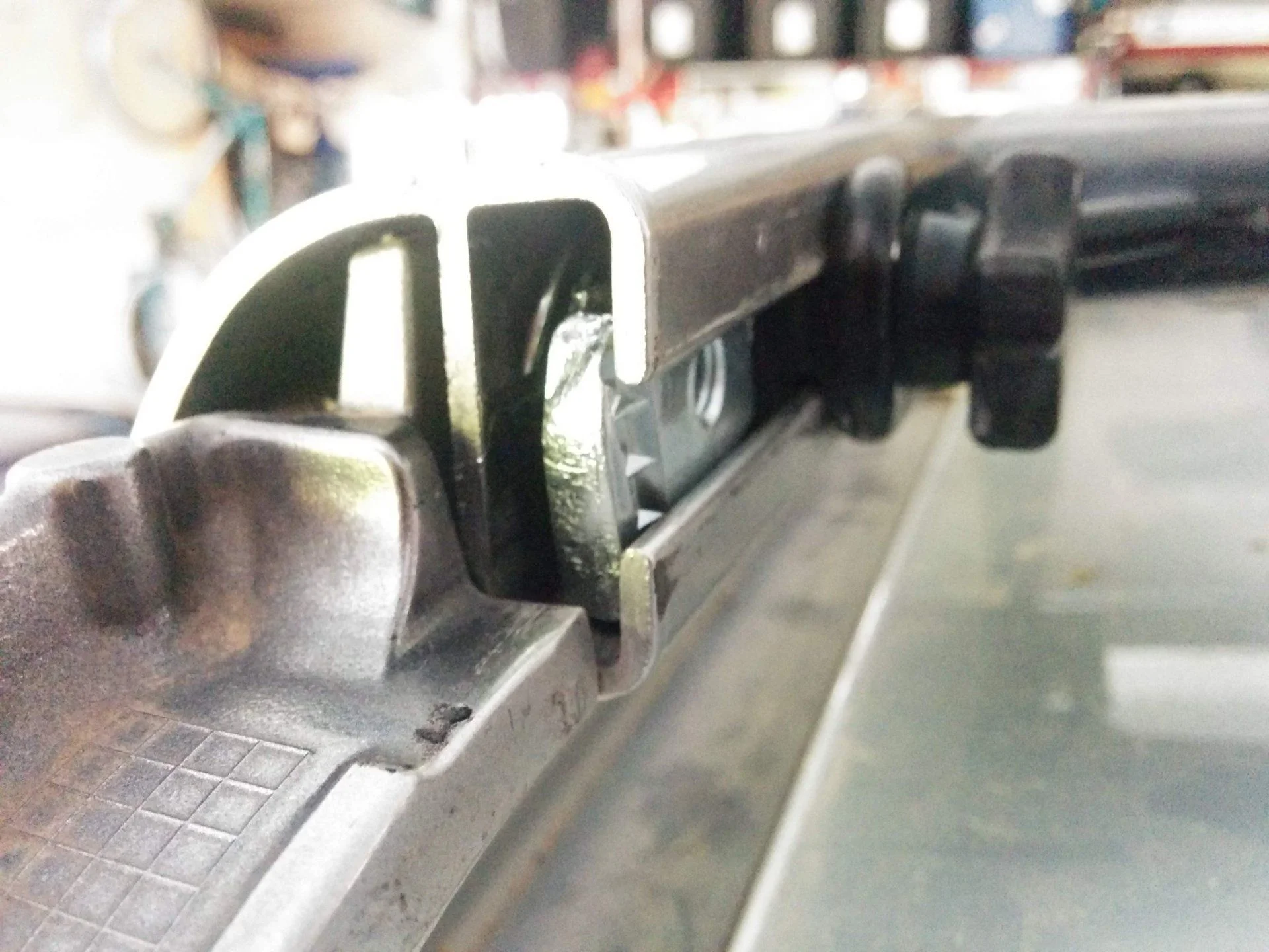

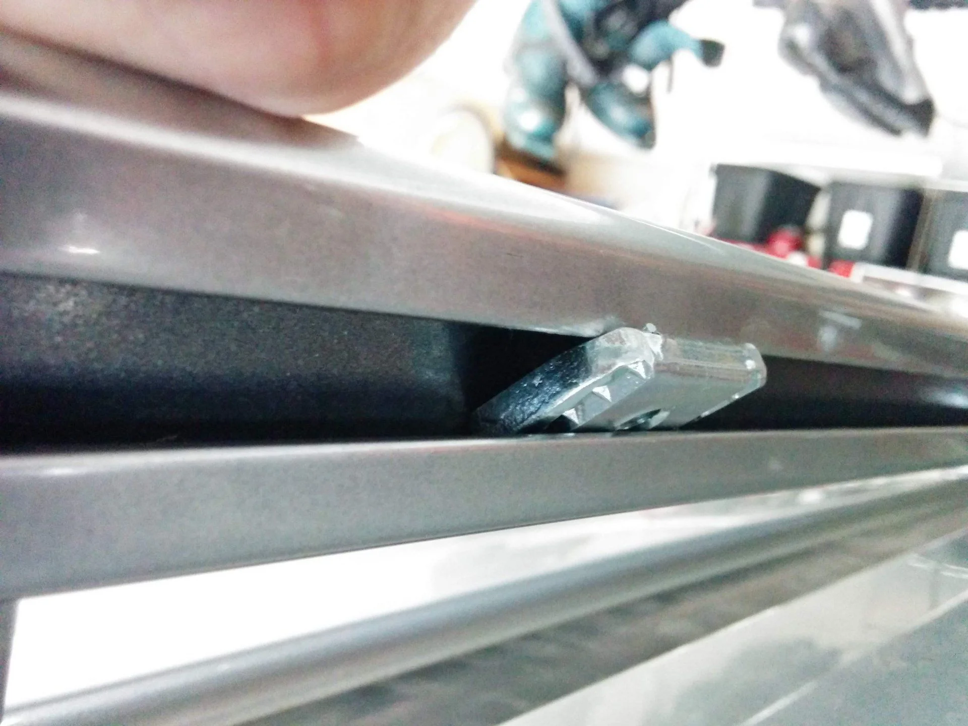

With cover removed you gain access to the side rails' channels where the crossbars slide, there should be a rubber stopper preventing the aft crossbar from going too far back gainst the rear cover, or maybe from loads being too far back over the rear door...not sure.
y67z09seFsGnMMPDQEEO9ammd6gVTzv-1EElv2aWEGlF8ulmz87MkjsxAK1BRDEtU4vf-qAdZypUjwGDF6Dsvy0-ALdNyd1D7MJxo0b_a11MXgJfitPsuLS5IBOJ84F7mjMFCwewJmUAyzccBLM2QpU2egH0sZEKNqPo5LEQTudwvYAPEtD07OisAz8ARQZJnmmF6h2mN4sfr8x3qnXR_n2AaVwCl0OiI7XsmVRNr8cFS_tSACm5eW1mt84S9ZDF5rRNPdPNVZ-sE2pPGIVVG0nxXNE7YDf9z2hq2JwqApBldWviOeg_4PerwHlQc5jWuI_DJmzghsAMV5XO-Oy9VX5Yh2fCstUYfoHbkheBfEUZrWIs1ieXEM7Z_NrbbvACY1Dz679iEKS8erkRUfcIYgLNeTrepnswfxdJw_wsV0OgZExtu9_vtrV8QdYdDthpNwaF--aSMTztIB0lTJ1hSbE7H9W7qT9GUeoYZe2J67XEudEb1jr4rFpNc9yxOpTeGiiWdtVHWV3w1ZMnugQ9BAk1nfArKikMARO_YnZkpqdtv6F0fixUQmDxr-kdKYCjp7uPeHMOMNtPxhGzW3aTt8r66SfclXCAi93hbTT6nWhhpyv7K--6aYy_jelB8OC9=w437-h582-no
NwTR04mofgBaCNhPN3M96la1PamuWrwpfeEH4iqZdk11soMWkFpJIoBI7G9z9pphCyPVO2sJdNFdKa8gG2oAgMeowY5kmvXNfiEW_-NBOEKkzuQA52hCShOckCjWWUn3UP4urTBBZpSQUXteXiClbGTWF67Oaj8e3D3csXBPmKPGdJ9AGPvrJzYA19BaSUb2tmhzkKkAet52XRgzTzuwCTbRHB-KVRiObEdm68Qklb0KzqHHv6ufXBkjz_eAwzigQJrNQwfuJHuG1tkTLIC_WJ2lG22lPYLIGJaVc64dl0tTysWY35pDdIf8FIn-YVBWokOHso4x3qbUQMlXQlroBBJRpeDghdC_9rZCiy4XVfwu75MSVRkuDdXjnR9Plxf-fZXiCN64eCdNPhQ3yoUnQexoYoFhNq7Sih9iLk_BX6Ht2qLnLOOrJdzG593Qubf0eyQGY9499TPbBPqAvGMPHm8Viov62StfZoUj0JXkGkKOP2cHkcxRSyr-nGg_74GgC4gK0rNj4O9eAKbjYMAqqTZ1kmXDIzn_8UrZXB45TJULRtFLfuyupfVuvQOjje72Shirgx8yA5bFt3oh6fc8zrk4Zq0mX4qTUJfniriMK50_EQZzif0SSgd4D-Oo01QR=w776-h582-no

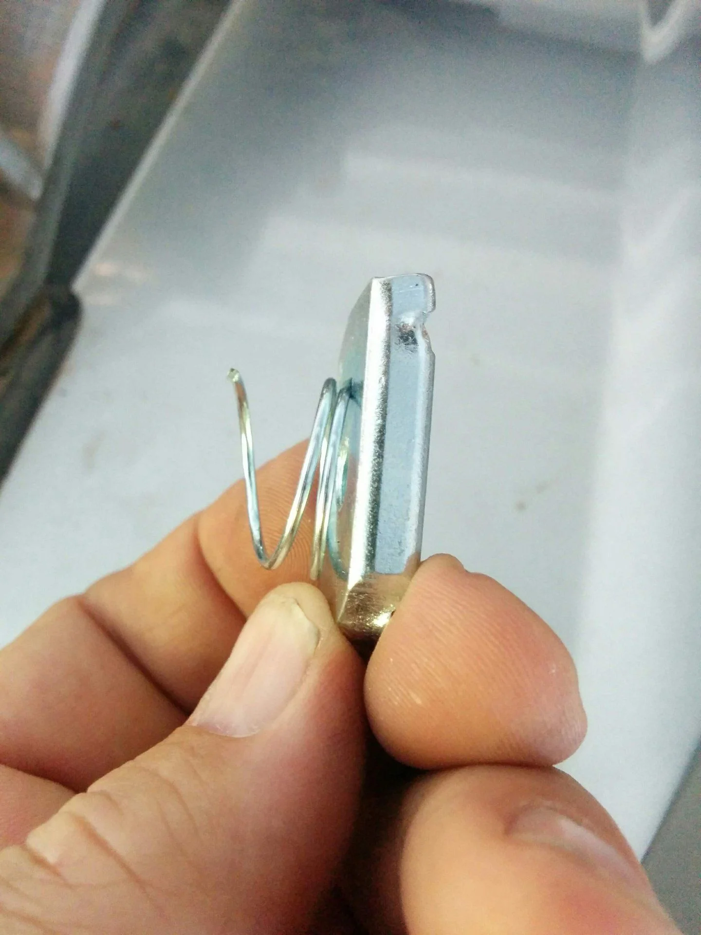

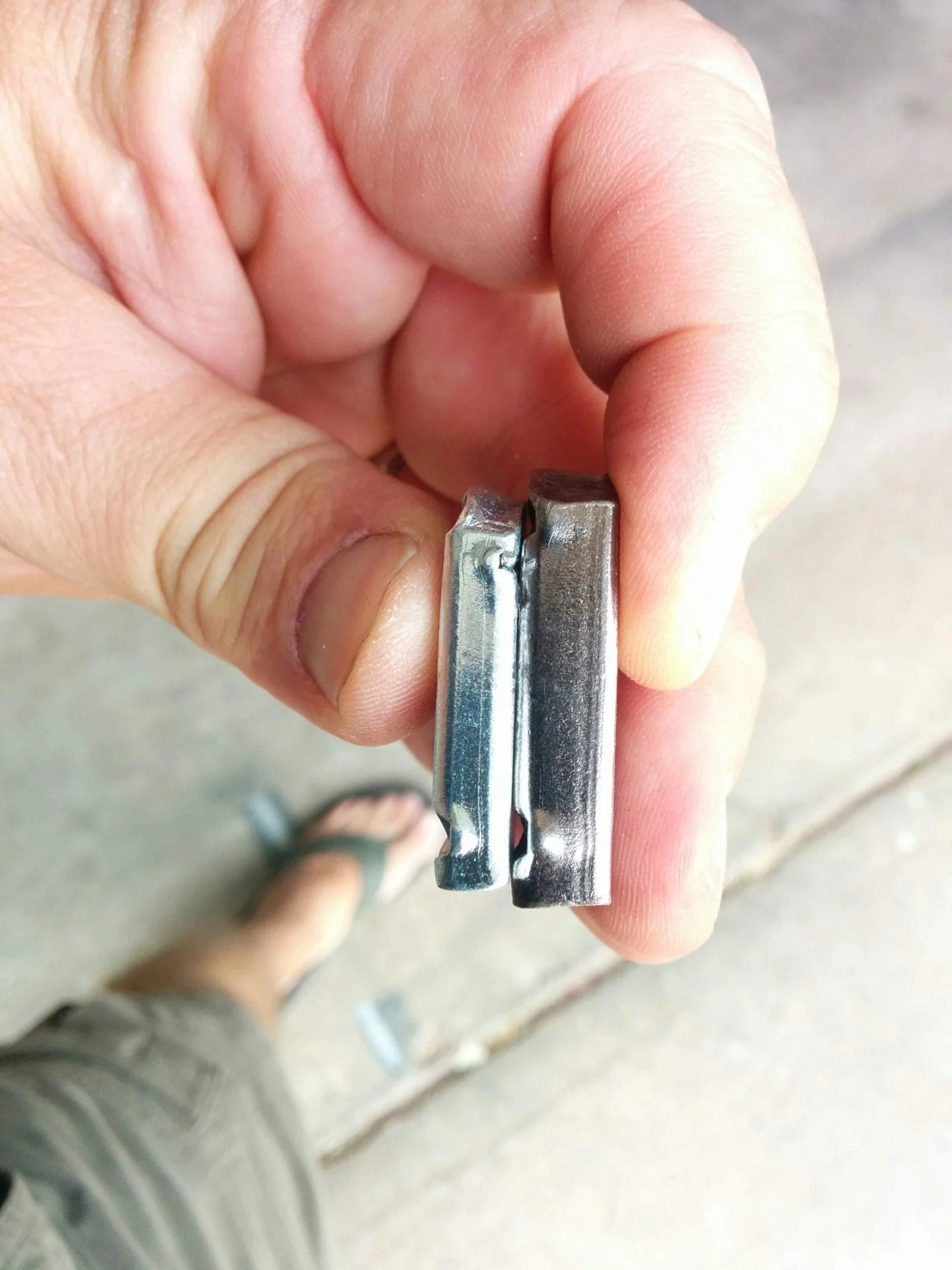

I found (from hardware store) unistrut springed cam nuts are a good fit. I'm going to go back and look for a larger size,, these fit but the hole is for 1/4" bolts and I'd like something a little thicker with a larger hole (like the cam nut that came with my awning, also shown in pix).
W0mH3j6UVTqA75-4gyyaQ2x8Iz5eH3z89CcEdWANISS2d0dojDDZKQBb3WmbxJjh7Fd4MB34Lvw1D8bE6vYC0rW3cKxiUdyAR15plnkJ0mEswPlcmyX_2dl9xqB-CtnwyJknjzP0xSKP6C2lsUrjvp-hXzxDrRqyQ-pNZCILzqKG0KJyz9ApoHlbl9aIXXDF8dYrOrJCckruewkvUKUPmfzM5M8fkTsxCdp_urpjSRosFA2JqhIvvHNMEWIINdDCG5xvEyg2gWZUdbLp5j6YsbVOUxmzEUe4w5ahmyxbL75H3poQ0ZDvWPHzHt3yPGWyGfEaRPYQpbCV0v85MaDd6COWJKlAIjKOoFMDLAe_Y3B4d4-YfkPJYD8yuG4i0Id49VhpeehqnkLVjLuzJgAZYzXdNLli3BVCgBO4Htpfd6pk2O5vD_D5x4X4JyhQWfxXewY2XJjt32IxdyTgXpw1SzNfrgzCGUteW9AWyGjjl4zgCAb0tLqldlOhPbh1v7PrHOvRIHI-MFBa5KPqVl1p88nsfa6eyDa18sDrnLtnA3S-O5UwAP9dFDRbp6Z7PsWdCzLR3F1vNhsbkmilRoVMm-G_fwpLYJNWWtAfg4Lg6SxHbYIC5mHkRT8weVfbIE-V=w776-h582-no
1pkCP3HBCLpxfg9CN951BztruA2lJTLY3RXMpmuQ5g1DHlQbj1seL8Avhk3iy7BzjPFhvPoqaci4cJE6hxqx3O73VQ5ZpWHfRb9knvki8Ux8UAb_iGbPPDrs9bh-m1WBypoPv2KQ1L1VQjPurJ7sulg85r7JCq_6N77_iy5_I1oipcBhr6P0GVPuo3bhvU4LJ5lVrgPcOu1kfwF4euiTwBmcBHBlWDzDbcxsoF2kvhZlPstXLDCM0VzTxdq5_yuSK4-0bLLZUzS8QwbewK8AvynDZ2AgALQ6MQ_su4qIzefyTrRDlz0XHbE38VLIF8AEpVVZB87Q4pPw1ZD9GhWvyUkIqhTFOr1pOV2a85dj9iPUuC4ULAmTvK3TF-UTv7PE31IJW9kTPDI-1cFvV-XZmefXDJ-ExDNWegm-BUAnB8bZLKtcnvWIOM5OZYg7X0cfmlHKhsL2vqnxNaG23UizsVBp-lxF4Qhg5v2zhvUEbpUrxOzM9PjvNcjxK8TSw2y31CYrittNj6BnVzO1dc0mlY221ckEptBd0oQapVcW2ElFM227N-0E_afhcMv1UkiPmOnlVX5E6vF2F1LTyhHgAz0oRlyHEUBdRkW70PTboHRn174lahsrYWWFg4sNIdJO=w776-h582-no
[GALLERY]
In 100 series cruisers, these will just drop right in as the channel is full width of the side rail, but in our 120s, the channel isn't very deep, there's a verticle support defining the channel as shallow.
kNB7nEDfO1Zro9RlTtPwpJqSVcMEfODfKRJ9WgRTfnKBS8LRsSb-k-RCCWStggy7rPYw4Ma98P0gu6218rV0afN-tsr_C9VGYqH8uErn-3xxChuxFGTs2NQaS72cVA86ClVp5w-a3RAnfHVq6qrJ22KIoW_0hbGnBqw_K7tuKAk5kXZO-ByfE223kRysF4x5oh_iJ8MJ35mQZOz11cat17wRU6muLfnWA0slpCw9urEUBoXIVWtGPgi1wfCSAVfbiYIm-UVnBaGcZUmeM-QRtf0ZdXUk5tWCslI8NSdc36EuY_rTVbRkhV8EzDMMWQ3m-O0S5KKVdvmawQFTSVeFT4b9gf4CjwWfJhNAy3D8RHbKtTyO1Yg2I6aQaPx2pyvETWLM05bbWaze5NVMSfEGa0clSHM38KDK_H_JUAium-rjzJBe9OgPgq9Fs5-8dTV1GYCcPRIlyMvmrBhzLCqjP_Xm8-8IwBBs1yjdhYQFACbK3uJMSI-0pwGHLwmYsQWKpNRu1XcdmWSGl4SUg0tbT7k7WQ1VenRmPETSwLkV1hth939UoLcMERSmpAJR1YaO9MOv4WrgKLeaN4gqnaGNLRhNc8X-YBYxvr3AFTheRWs9LVoOkznv5mRWjUawoZ8d=w776-h582-no
J0p_a7dyNlaWXLK9LE98ajMdOl9IUN0yvo9DPcuLikTyyrz27qsIfVwydIM_pqfse7aaypRikSWGtxBqisOeA99nF6QIhDC9r1GIEtrmxxJ08ua_M3L4hI8cE4PrQLLfklwnjXEQkPvAugFmbagjazfMy5pwRTNXiLGzrQ1zbEFDNVhKtgNmHDLFE0uNI5eBbB46p5m3c7oO2ycwGJYTwRl0r0k49zZWgrnOYqO8pWdpglxtiwsSBc3OHHgK_QjTtrIbGMlE-CcP8hLs9LIZWD_oM2xMZHioWZ9Tkn7ttWq79l7QJk26WtZzREG3ysbSr-OjmZC8weDkRwvos7c-wyjkYwz5kjwGx1sk8DPb1P2MxCsmNepDmW3qEN1X73vDVr_d9uP0vATtloCEcaW3b4TB78R2Y33o85MRztEjZva_f4EcUZc0a0e6zF-rAsAU9IVy4Khq5ZC6k5Ne9-G0e5186gswYpj3pFhYoDsMSAZFs6xy89FLHtbunwIpI3xPQjwhCovgykx2NbRfQrxnHmxpBSi-EhgweQbP5jY8Uv79dKUXRyUC9sTG4jR9bHmDcrsSXTREphsnR_AiP_CXJh7Ozglm2nYQHwl6aBm8hhMiO07lsXIpLqBk1zgGdL7M=w437-h582-no
Thus we need to pull the rear cover off and access the channel from the back of the rail.

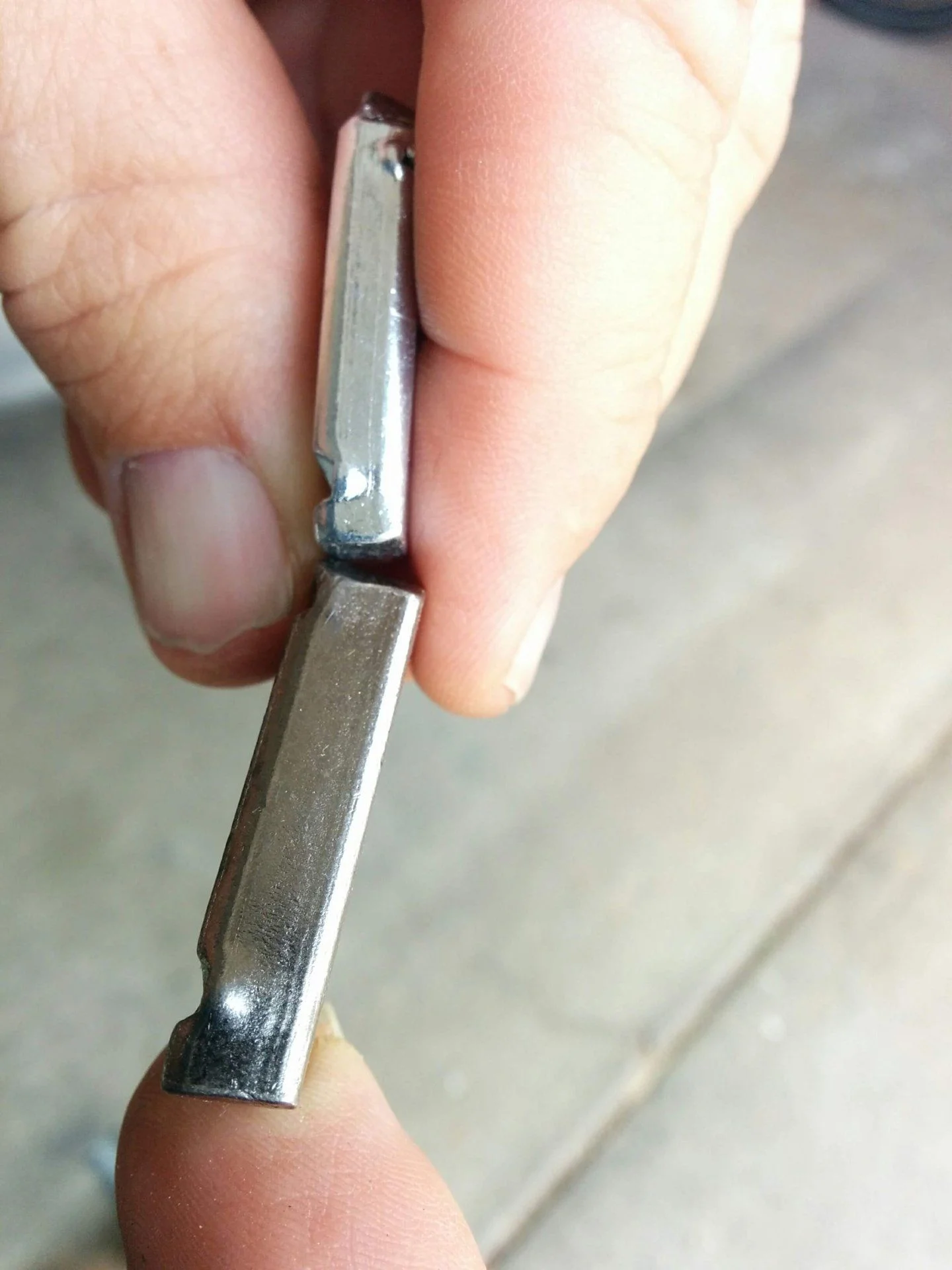

with the this cam nut (unistrut spring nut) I cut off all but 1.5 coils
which allows the spring to function holding the nut firmly
But, as I said, I'm going to look for the next size up (5/16), which is a close match from the hardware store to the sunseeker awning hardware (M8 1.25)
WfZ-m59CcYkesgu-NFMmiNBpDs_GnDtviK7BO8KsPgFVF2eSHF-RkMY51n0d__XRPpuUwzvvfLmRarhDsVWj7gD67KxXySInKDAwChVkaQRB1LmQuCaKYuQ8yGiu_sDIwbCoLFVyUt_5TrUFnBHGNR-aVCUWukbTY1myJ06-Ia0x89QLVqteSbxfACJFY_ZSa-NprmIMM5hYjKPboMzkTvEqiX6d-Vi4fw39TUOzxU7LIL8sdAOL2V_CDxK2PAoQDP4YEWUcdrKpYZ8keu5DkJwd0bi2C0LfCZPnb2IGDtkAXmzYdOBdWEYCVHa12Gj32x7JwB1kU5y6240ONI6FwWdiIneEpBUANI27tyaPLTbPjynJRWDrhG-qpMVHrJO6WkLrOvAmphKPbQFhjM1WISWKvsG0k8xKSBQBQQu82Yo44scHAB5VaYhqNBx59BlotFlzamMSZSqxcI-j4GRFNeiBTqXHmYsLOj3Ge25BmpfHnY4BUphEShArXxXfSjBcqYS5nVt2MzdpVooLMXWBFVKcfeaYctGAZrYh7HMCHjkyZpuiKZC9pEulDAhxaGrjDgHBczLBOWhdS1fufR1gJ5CEtmWilVymviEiSGKeSxnx9SL7UhWvfTquB-SmyWL2=w776-h582-no
The slotted, square-bolt is too small and just spins so I'm going to try the cam nuts and see if I can fab my awning hardware to work with the factory rack, despite the warning, ...
  • Fits all Rhino-Rack and Thule roof racks with specific fitting kits
  • Included is a bracket that will work on the Pioneer systems

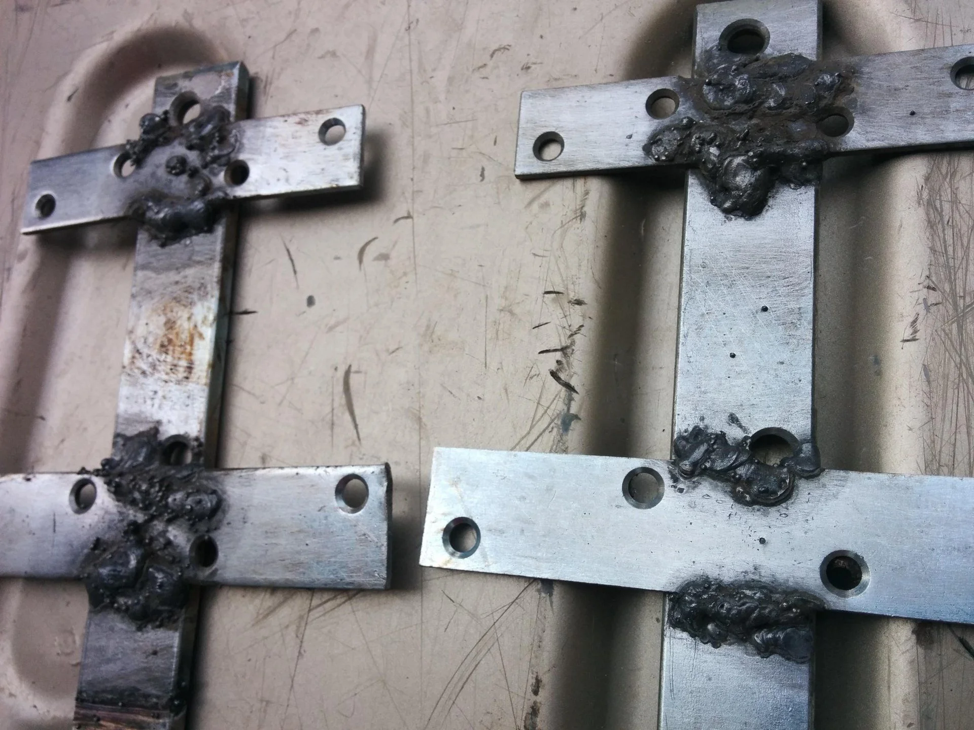

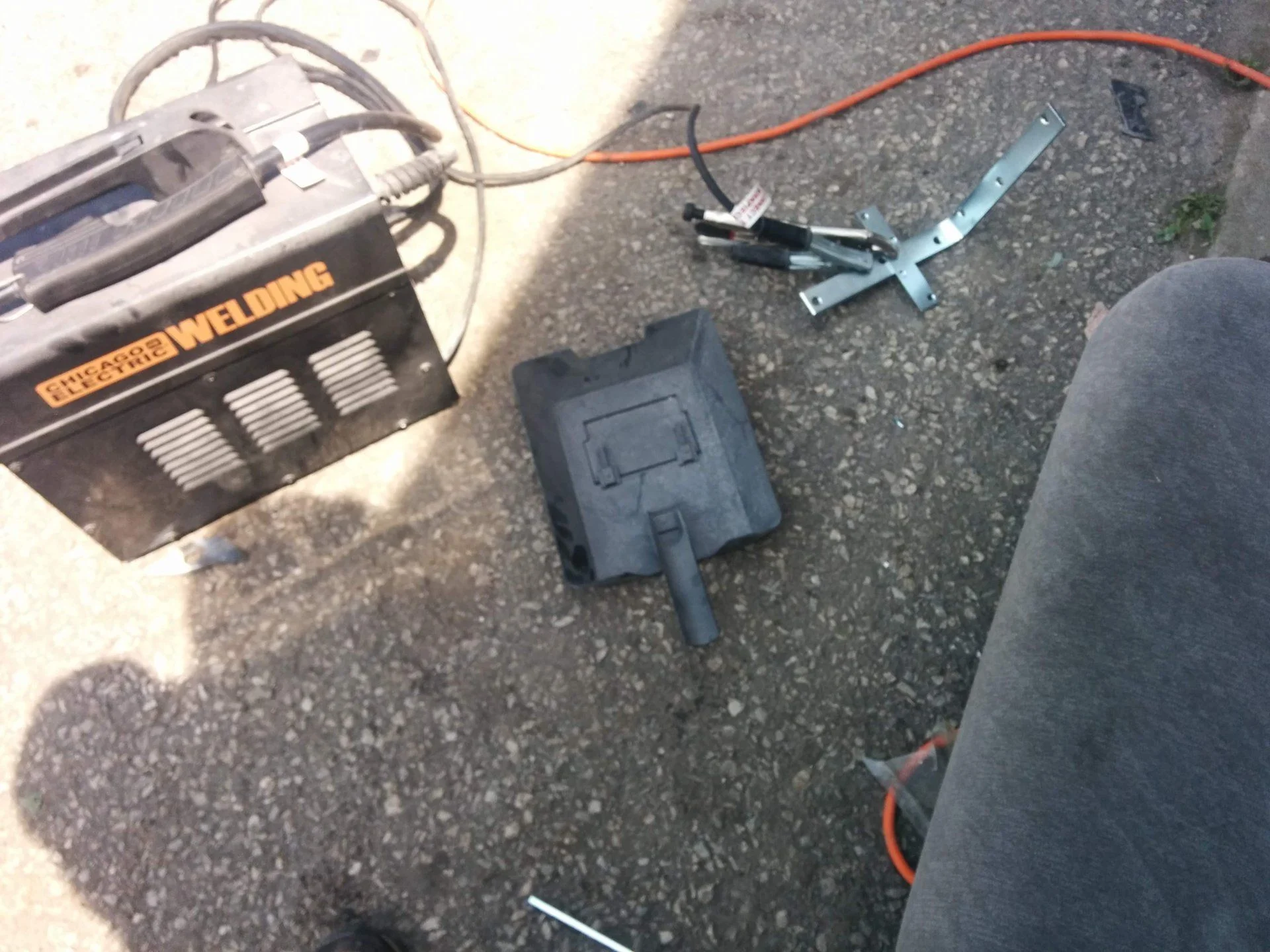

I commend you for posting pictures of those welds. Clever bracket idea though. Have you considered drilling through the factory rails and bolting your "L" bracket through the factory cross rails?
That is so funny and true.
As for the welds, I am not trying to be critical but some of those look like you did not get good penetration. The spatter will just be there with flux core. I started on one of those and a grinder can take care of those if you want to clean them up a bit. One trick a fabricator taught me was to turn your work vertically when you can and gravity will help your bead puddle and result in better looking welds. Get a helmet as two hands makes a huge difference. As you alluded to, a shorter heavier extension cord may help a bit.
The scary thing here is that looks like galvanized steel. Be careful about breathing in that nasty stuff, even outside make sure those fumes drift away from your face. Consider grinding off that coating before welding. Another thing is that some people use brake cleaner to prep surfaces; don’t be one. I think most new stuff is non-chlorinated but the arc can cause a very nasty chemical reaction and make toxic fumes. Point is be careful of your solvent choices. Maybe you know all this but I am not trying to come off as an expert just sharing things I have learned over the years as a hobbiest
One last thought on the flip flops. One day you will get a nice bounce of spatter on your foot that will burrow into your flesh. Good thing is it won’t bleed much as it will self cauterize.
Find some scrap steel and keep practicing. Once you start welding the projects and things you can do are endless and fun.
@CO_Hunter,
That's awesome, I appreciate all that beta! Yeah, this job was a total joke-fest, and was just to get the awning mounted to get it home. I've pulled all that craptastic bracketry off now and am going about it in a better way.
RE: The welds, yes, those are s***E!! ;) You're not being critical, you're being too kind, while probably wincing with sorrow that someone would post that . ;)
It was a cheap flux core MIG on a way too long 14 ga cord, with no gas and solid wire, not even flux core. Wire speed was too fast, the welds were too cold, penitration was like rice and a doughnut hole.
Crap tools, crap job for sure. Didn't even have a flap wheel available... Yeah galvi is poison and I usually grind/sand that off. Surface prep on this job was...nonexistent haha.
Here, for your amusement, I dug up more of the $#!+ show fo . ;)

I appreciate the tips and tricks. Sometimes I use the anti-spatter spray, but often forget I have a can.
welding is rad and I like hobbying with it.. As I lay awake getting to sleep coming up with projects and ideas, it's fun!
updates on the awning rack per learning how the side rail slots work...
I removed those crap brackets I stitched together on the road in July ;)

There's a simple way to use the factory rack (despite Rhino Rack's warning that you can't use the factory rails ;P to mount the the awning) with the hardware it came with.
H6bTBTmL9rEQrcTbxvz-k-ir89PuCkYSwtcRVmB3zVwNn8KBLjOW8l22ARBXqevgk2nCOWK1n6JqMU8DN7M6KardfCXGI_shiQJO32d8rtyEtt5W6QYVgz0oj4a92gAyLADcw1ydVzb0NnUFR1jLGSNuFkXDgX20Z4_GHpd4Wc5gKdZ5EPE96s3Oq5p2FyJEkr9NtFOFbqi01RZ5NNjjV6bD7HT3uEwGidR6vC0bULP-KeY2pEf-gldgj54xvA-QjvnOjkvCKwxpViXiJtA7vhQ_MadCvK7Xcm0iPix2lLtnu0KTljV0hMGr7odf4nvcp1goj96LqUG-QoXQ7_cfqQ1jD2auJxx_8KXS7CpLHTVIANNyTOaarwxsbGqcEWtI50VOpvTKhU9ZETts_4oLzTIS9WD3xZKk3oPoUUp36SYVLKN23hM9Ba11iMrtWSOGE85qUXDY08DKAmY-ETbQrKe_j0wgPwmq_HukezBygB7dWHbsLqGFphc3QqmnOmDVsmeINOSpYber8fPy69sstddyMmVxWO7rqS7dF5YODzaTdMP9HhxgKBL9iigjpYIIZ2Wj0qA3EQAmff-m2hFDbwFVdoiuNPZqKbGCbOObzijxnZEK-sShvCdVyamSAlHV=w1192-h894-no
V6uipE6CmhGVe8rlFnVmN2NRUpqPOUD43SdZoX009fBrrDMsCBdfGxopjcFjD-Dc_MlfSzRG9P5LCUOBxYZc_cuQRdq7I-xXUqX2CVNmjxUtt1aRbnR6Pnw4W8OfxNKdFQg5hurYR03C9ggf70OWcpccL2_KvgLsLjp_tzf3X7FcKksYc_OsBPz1EBaax2TNGmJeXCMcxQ8gIOHm_8Cf3mtRqXqoglAfSIt2rZds3ABCpFrWswGARMgK5n39iNJEh8iXcZMl9LSsbM5Qz34wr6e0CEHxdM3CRVI9ghTwtXdRL7cIym_h8OKefLdFZDEvY3IdXPQiz0tR_kVfVss-SNhIMkugQn8KKNHH52tntFeiE6KI4YJch1ZJ0CVL7QAA6zCCjbOg1in_z6RB9Lnn0AhmBWreRmGuoGTaXauvn9xg1kmu_XPOxuX6euPAlo2KmKno1DetuwvLG-QheqTY5LC2nDmadNmxEMIN3jGTwPVXfpUyxoZzbC0FOsLE7SapoqUeuj80cYHtANtdVtG2VqopBOJoQFDaOTAZ5aFii_3uozH1HN_dKCU-HD4atW1pgPPeu-Rs02PXBME1h8o1gVb8nJJAX3JZ1PbTgazwF9iL3MTIKcLDQOAwE9aOoUE9=w671-h895-no
yd1XOT0WiCXFvJOYOkRz9Zrt40O4-lDbECXNvmbw52U0uZ6swxapqevbWGCfchi_gIPM5YgT7XvjGMO2STx9H7j51KLQ6L9xzVmITrln_8brQ7hQcGDQEPi-oRol4T_zSkIy07bjDZGaOdH8QTKT0jYMCmpg8dW_BUjc5VmnyNRnQ5hTV33pbyzWx5o2Gc-oOSQ-FLlSbieigr-ccrAZ3R26Yo0-U7o2e0fLDku6qFWinSJFv0OAlg5uIpIA02qgrXL5f9dkMKITNT34R50cdTsu7p_kEIeM7w1CUcvTy2zbfxzGZWIKBEAA7Sl5iZ20mTEA6qkuipj7Grdjy3Y2npRCpLwSWuhb1ADIbj1anhd9axAoMaVCl5FVlJbMR15lBDkdq2BSdz9pNoeLVi703ubTvXn7JIgrtWGdxJTiV73sj65vok0pwgp1XsarSix8f1Z4ubXn7V9joLYwWu3oSdh-YGLtgZBpNoO-WTyR_PDQ5kgO2EOzPpPAuOn51IJlnLsNmWYKz8omnjeBHIdpJwpoQqo7BoRt_Fkhf47F6kFyxyhgUN9DarUHhh77dm_SLksJd4EGx-qn2CCyxiZ-oGtEdMV2HD98QLW1Ut2mDm4uD-IklHes_gZirpD98pkg=w1192-h894-no
then vise and bend the bracket up as above
The cam-nut's fit in the side rail slots (this is a hardware store one, but the Rhino ones fit too)
gumQ-MmmMvuSqOBFhMI9YZvctH7AtDkofAf-lxJxOUArwxgi4KrZODcTUfQGBXkHykoBOcQbB2hLEKRF2Ls1884IP6RdrgPsjTYEiMARybWSi0obRF2cAxrtwXYAuwH89BQLcbW1m7GGRInyvp_wLJA2vXLEhltT8Bp53hEUZESvz9Y9KYrtuGOnbiu0ZweBUlUtxVmQQ_oFLz3tVBGz8oist3Afo1poWD_KlfgbkijBxlTLXfLaZ_mvXqrYybnthUI7TV45oWkHFOdR26bIu3AGPD2O6SYJ_Y7lvsEVGioRyOKCfW_QR2CLAbZvi93jub2XMxyvOlBKQERNAf8nkJVsTdrlrYgwLU3oBEEb4gSINUA1SFx7oawrYVWz1Unpj2pK28WRENkwO6CspbdieI36ASGm8OlFlnpLXghrnVnjxkYbciUagZDTPS5uRBZz86xiTs_7Kfwe9urSTx3HvuoRtMMSltx50G1pIf_X1JxMyyVdtev0NsNw5KIqmxLBU3w5H7MVufnn-QXt3_Itybz1mw6ahJ0bgWHQj1vvjASuX9j44qp3hROk1OhD7QL7YJdNLvZqIJ3v63t1CAbeBTMyRAXe6AA_basO214wLqklLEc4SapzsJhYdPhry_rm=w1192-h894-no
I slotted a couple more per side for....whatever ;)
I've seen similar on a 4R thread, but I didn't want to drill the crossbars. Fear of clamping too strongly and collapsing the hollow bar w/o a sleeve inside. Plus are they just plastic or is it an aluminum tube covered in plastic? I dunno....
