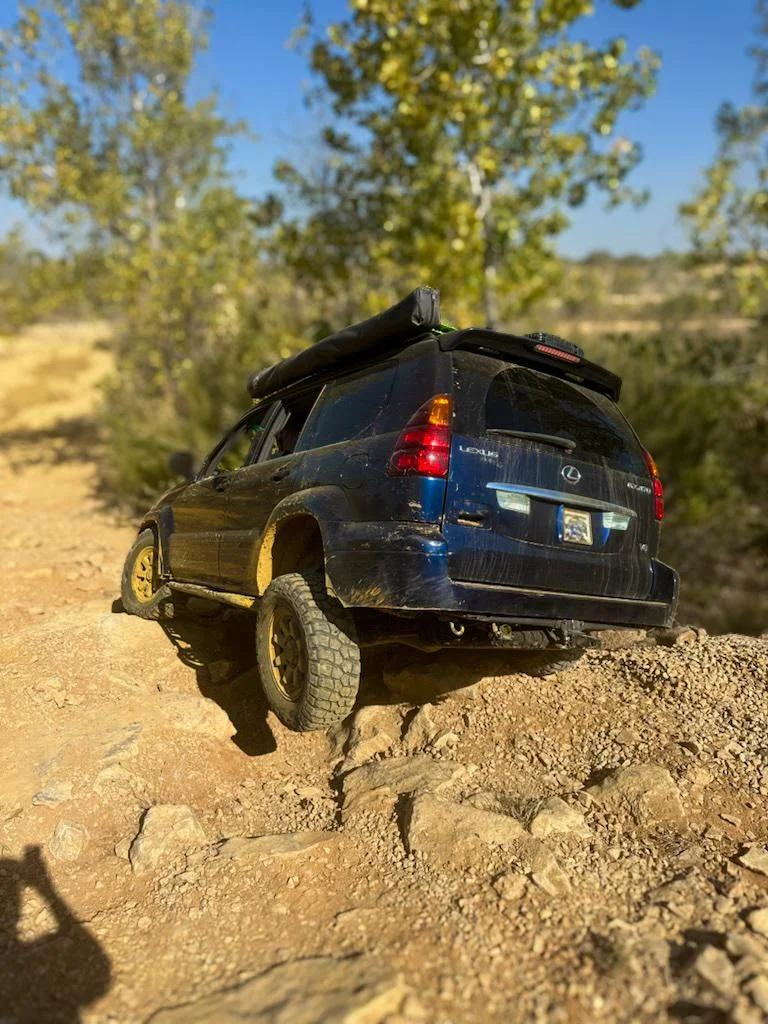

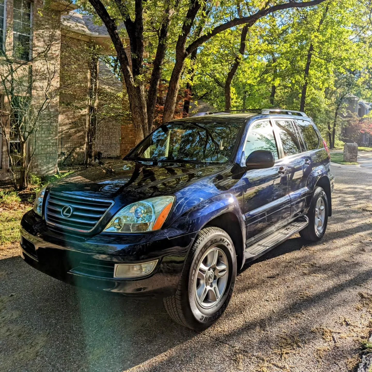

Hello! Long-time lurker, first-time poster here. I’m starting this thread to document my poor-man’s GX470 build, both the mods and maintenance and hopefully contribute a bit back to the community I’ve been learning from for a while.
The rig:
  • 2006 GX470 Base w/ Nav, non-KDSS
  • Just rolled over 200k miles (I bought it around 150k)
  • Picked it up bone stock and in great condition for about $13k in April 2023
  • Dealer had already handled the big-ticket items (timing belt, water pump, oil, etc.) before my purchase
Currently serves as an occasional daily driver when kiddo pick ups are needed and I want to ride in that good ole Lexus luxury 😆. It's been to a few Toyota Jamborees, solo overlanding trips, off-road park visits, and occasional park camping trips.
This build is very budget-focused. Most of my upgrades happen during sales or through FB Marketplace finds. For maintenance I stick with OEM parts when I can, but I’m not above O’Reilly’s/eBay/Rock Auto specials when costs get in the way. I’ll keep an updated list of current mods and maintenance in the posts below as things progress.

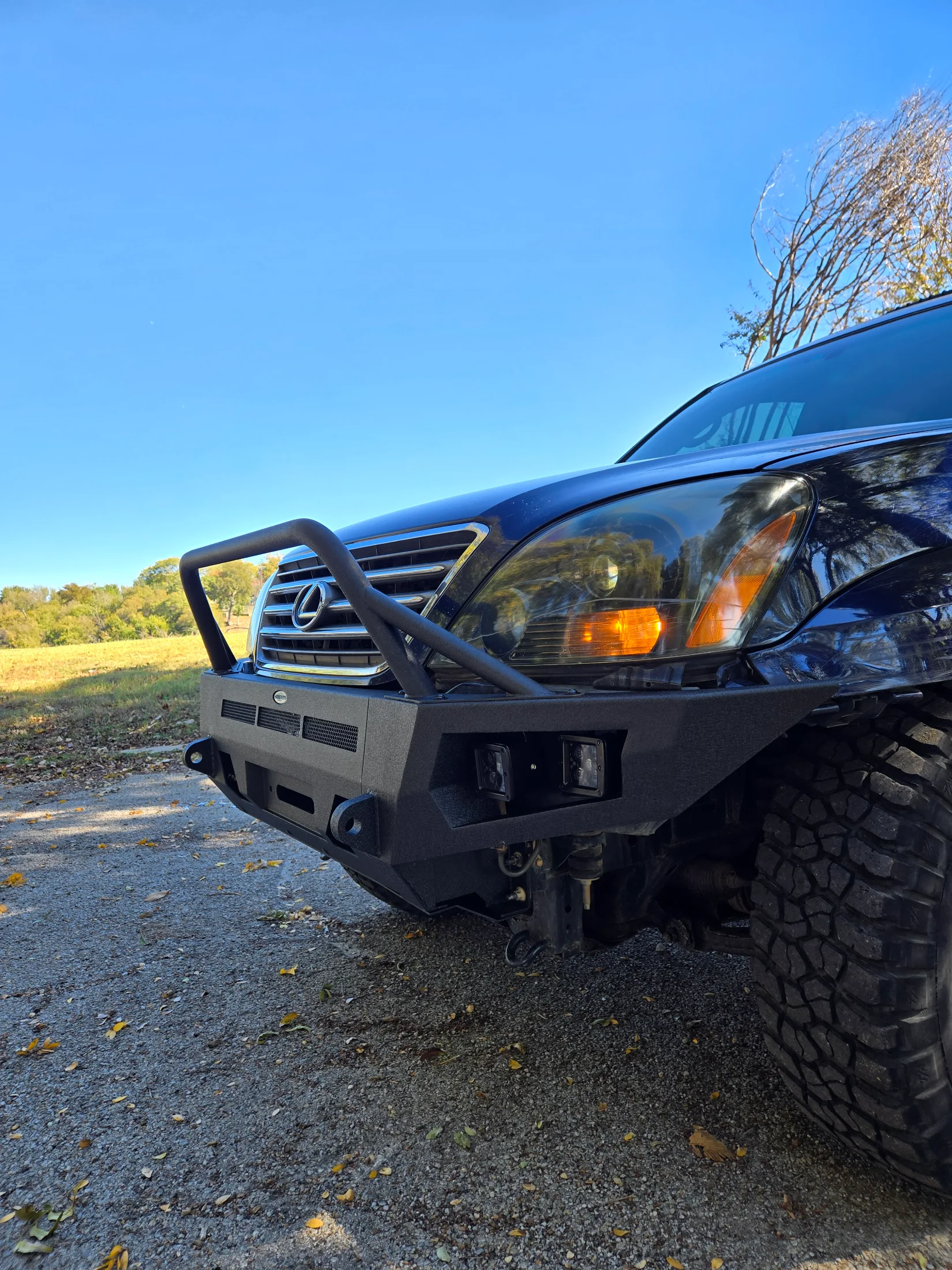

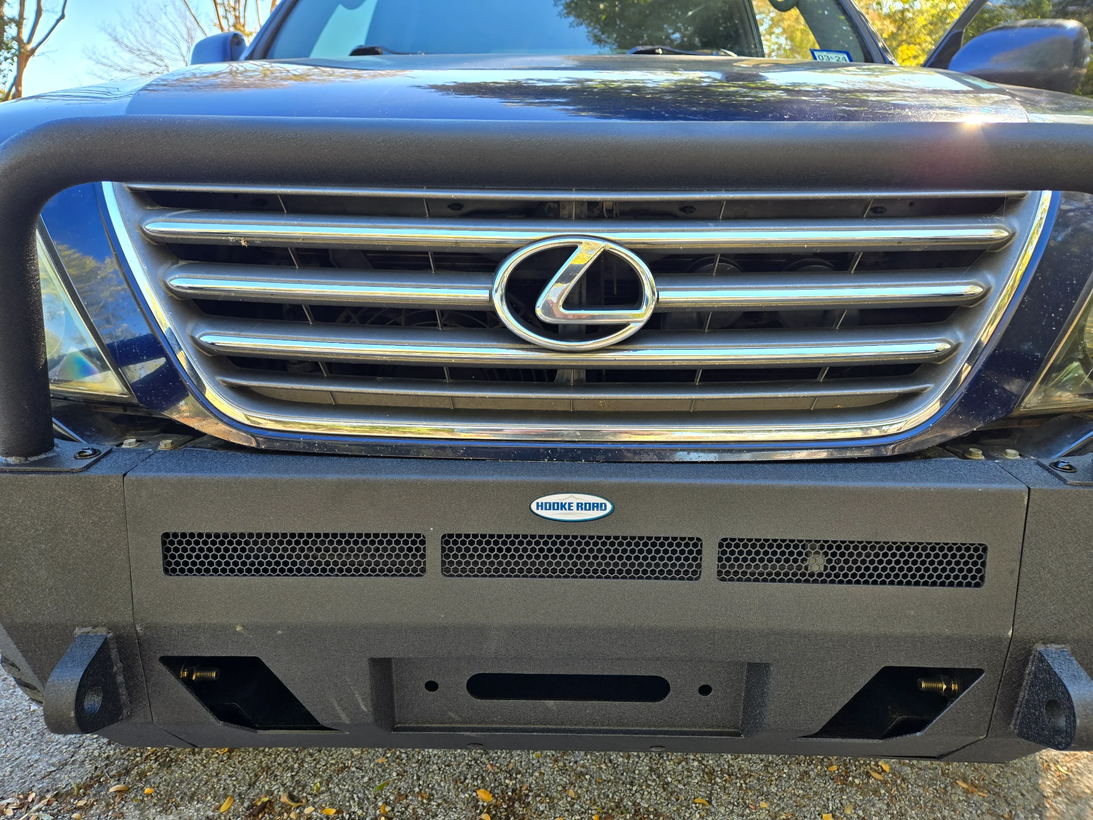

Front Bumper: Hooke Road Earthshaker for the 2005 to 2011 Tacoma, found on Amazon. It needed only minor modification to fit the GX, just knocking out the middle stud on each frame horn. For eighth inch steel it is sturdier than you might expect, and I have been happy with it for the price. No winch yet, but I added Goliath Offroad frame reinforcement brackets for peace of mind when using the recovery points and for when I eventually install a winch.

Really interested in the Tacoma bumper. It bolted right up after knocking out the 2 studs? For $500 I’m might give it shot. There’s nothing for a GX under 2k that’s decent
Yup! Just take off the bumper and cross bar, hammer out the 2 center studs and it bolts right up. You will need to cut a couple plastic tabs off each side to avoid rubbing. Lookup "Tacoma bumper" on the GXOR FB page and there are a couple in-depth write ups for the install. There is also a guy on YouTube that used a similar bumper for his 03-09 4Runner with the same steps needed for the GX.
It obviously will not line up perfectly with the GX body lines (neither do some of the $2k bumpers...) and you'll need fillers for the blank area between the headlights and the bumper if you care (I don't). There are a couple aftermarket options for headlight fillers on the market. You can also cut up your stock bumper to make them yourself.
A couple pics of the bumper fit -

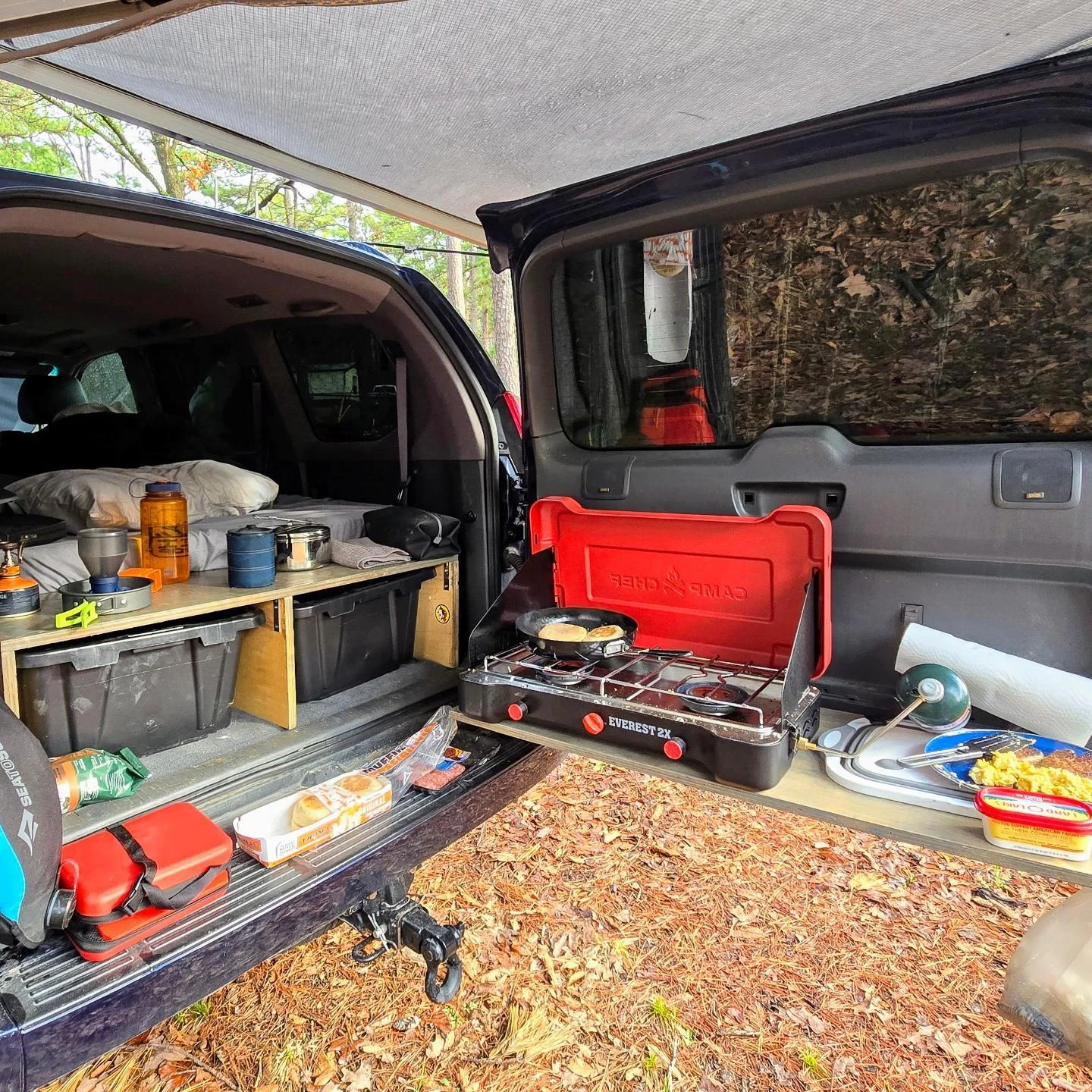

Custom-built fold-out sleeping platform using plastic storage totes for support and storage underneath. It fits perfectly in the third-row cargo area and works great for my size at six foot one and 230 pounds with a 32-inch inseam. With a 3-inch thick full-size tri-fold mattress, I have even fit myself, my wife, and our medium-size dog at about 60 pounds back there comfortably.
Custom-built fold-down table mounted to the rear hatch using inexpensive Amazon folding brackets, reinforced with aluminum supports running vertically behind the plastic panel to handle the screws and weight.
