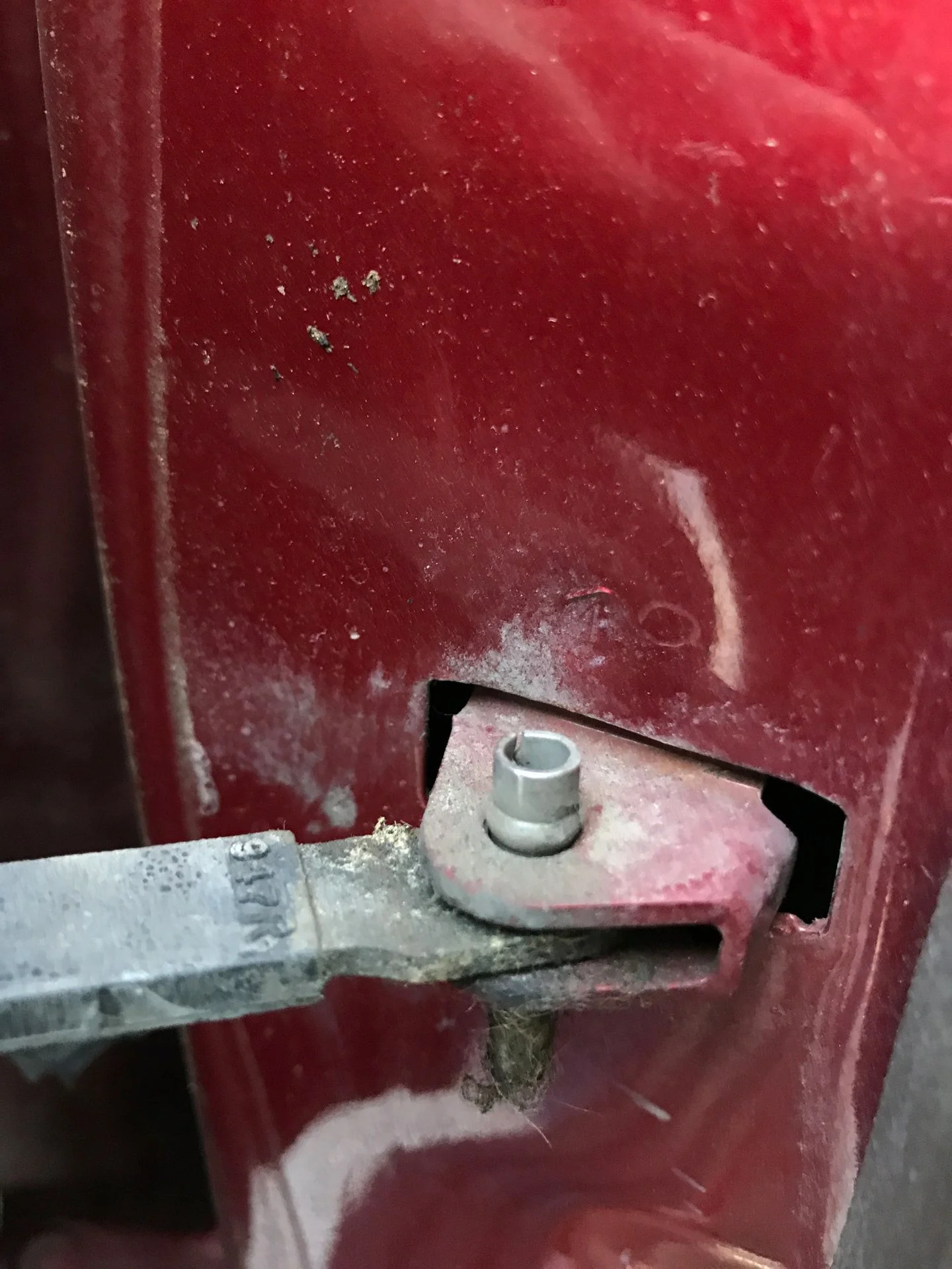

I just replaced all the belt moldings on my '96 fzj80. I'm now looking at replacing the weatherstripping (seals) around all 4 doors. I noticed that the strips run behind one of the arms on the door and in front of the hinge.
Assuming I have to take all the doors off, is this going to be a pain in the ass? If so, I'll likely take it into the shop to save some time.
You don't have to remove the doors. Just remove the pin in the arm that holds the door from swinging too far out (metal, black arm) and disconnect it. Should be able to get the strip around everything else. I did all 4 doors a few months ago, took about 10 minutes each. It's helpful to have one of those body pin removal tools (can get them at harbor freight) as some of the clips can be difficult to get out without it.
Oh snap. I think I have some in a kit I just got on amazon for trim crowbars and misc clips. This is exactly what I needed to know.
This should save me about $150 in labor.
Thank you!
Actually. I don't think I have one. Would you mind posting a link or image of the one you used?
Gotcha. I do have a bunch of the trim removal tools.
As for the hammer and punch on the pin, does it go back the same way -- just hammer the sucker back in? Wondering if I need to have any extra pins in case I mess it up.
Nevermind. I finally found the part name so I found more info on these guys -- door check pins.
part number 68617-20011 for anyone else looking for these.
Just wanted to follow-up here. It only took an hour or so -- super easy. The only other note I should leave for anyone else doing this, is to prepare something to hold your door in place to keep it from swinging wide with the check pins gone. You might need some pliers to remove stubborn plastic clips. It's also helpful to have a toothed plastic crowbar (lots of variants of these tools in those interior panel removal kits on amazon).

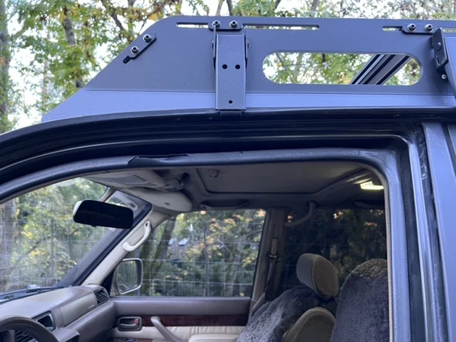

One last point of clarification. What is the weatherstripping on the top of the door opening that is held on by a plastic trim piece? Pictured below. As you can see mine is shredded. Is that piece what’s called the “Opening Trim”?
