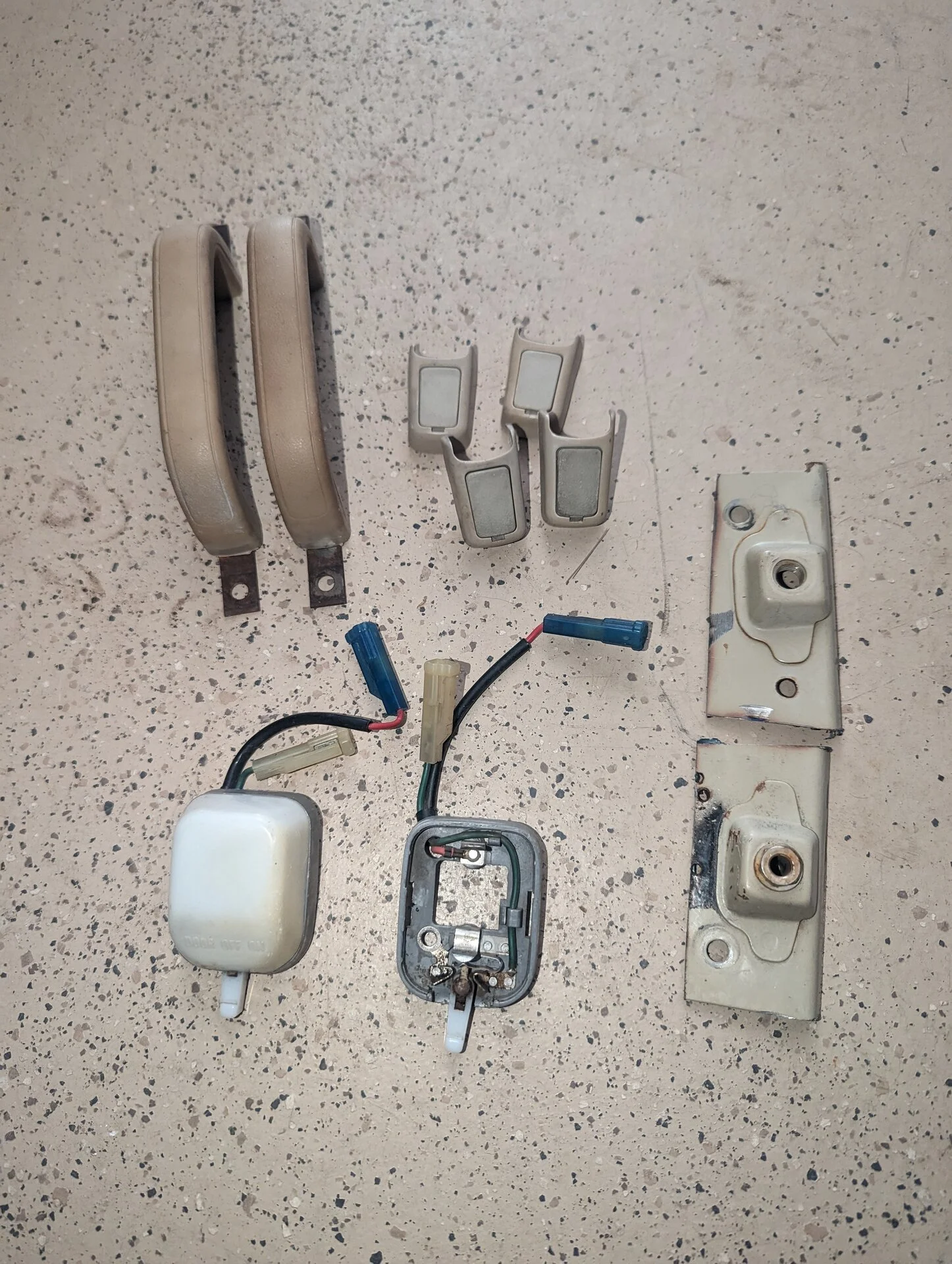

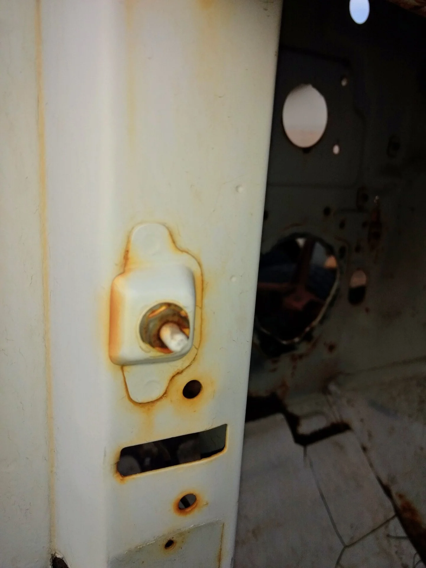

Can someone share a pic of the door jamb switch on the A pillar? I may try to rig up my 1977 to have this feature if its not too hard. It would be nice a night to hop into a lit vehicle. If anyone has retrofitted any other mechanisms, please share your ideas.

FYI the internals of the two-wire dome lamp are different than the standard one-wire lamp. The two-wire lamps are NLA and expensive for used ones. The A-pillar switches are high-quality, sat in a raised mount, and the doors had a bump-out to meet the door switch plungers.
