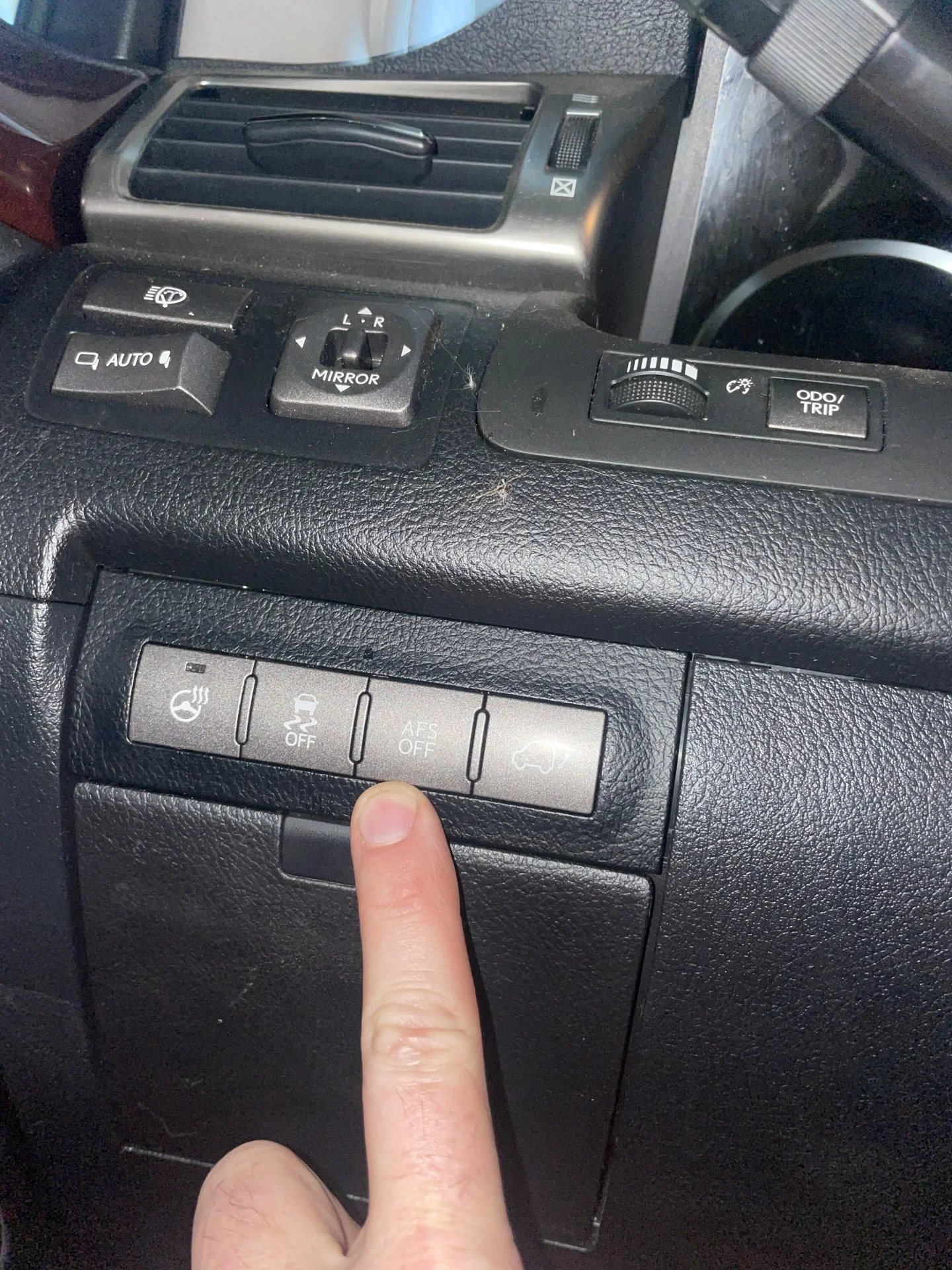

My 2013 LX does this, I think was part of the AFS (adaptive front lighting) that was added in 2012. I’m pretty sure it is LX only feature in the USA. possibly LCs get it in other markets?
If you don’t have this button then probably don’t have the self leveling lights.
My 2013 LX does this, I think it was added in 2012. I’m pretty sure it is LX only feature in the USA. possibly LCs get it in other markets?

My 2010 LX does it as well. I suspect any vehicle with AFS would do it for sure. If you have a bracket/arm on your rear suspension that is designed to measure the height, your headlights most likely should be doing the test. I can tell you on my 2013 GS, that at one point water got into my headlight and fouled up the tilt motor on one side. Once that happened, I got a warning light on my dash and the startup test function stopped happening.
