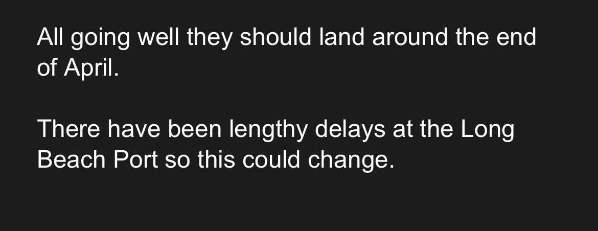

I guess nothing ever became of the TJM part they said they were shipping over? Been several months now.
I've been hearing mumblings about TJM not doing much of anything at all lately, noticed Slee isn't selling/restocking their stuff anymore either, maybe they are going out of business or quitting the US market?!

The last contact I had with someone at TJM was that the cargo ship was due to arrive at port in late March. I ended up using the Weber linkage, but I’ll shoot off an email to see if they say anything
