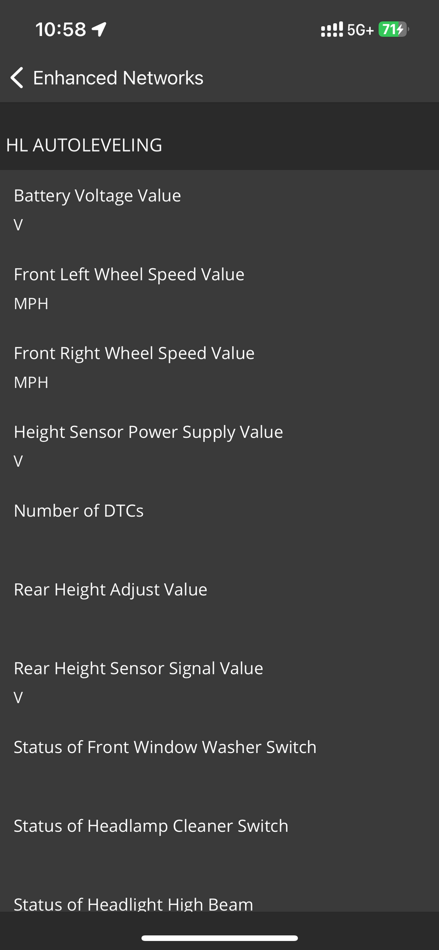

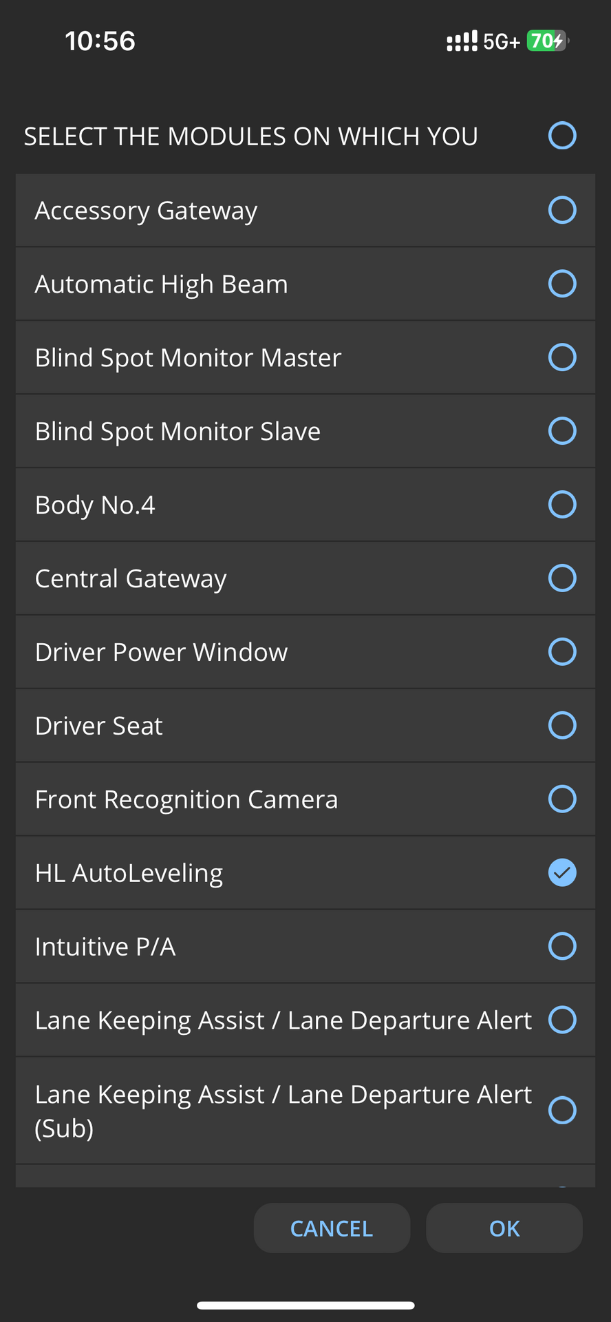

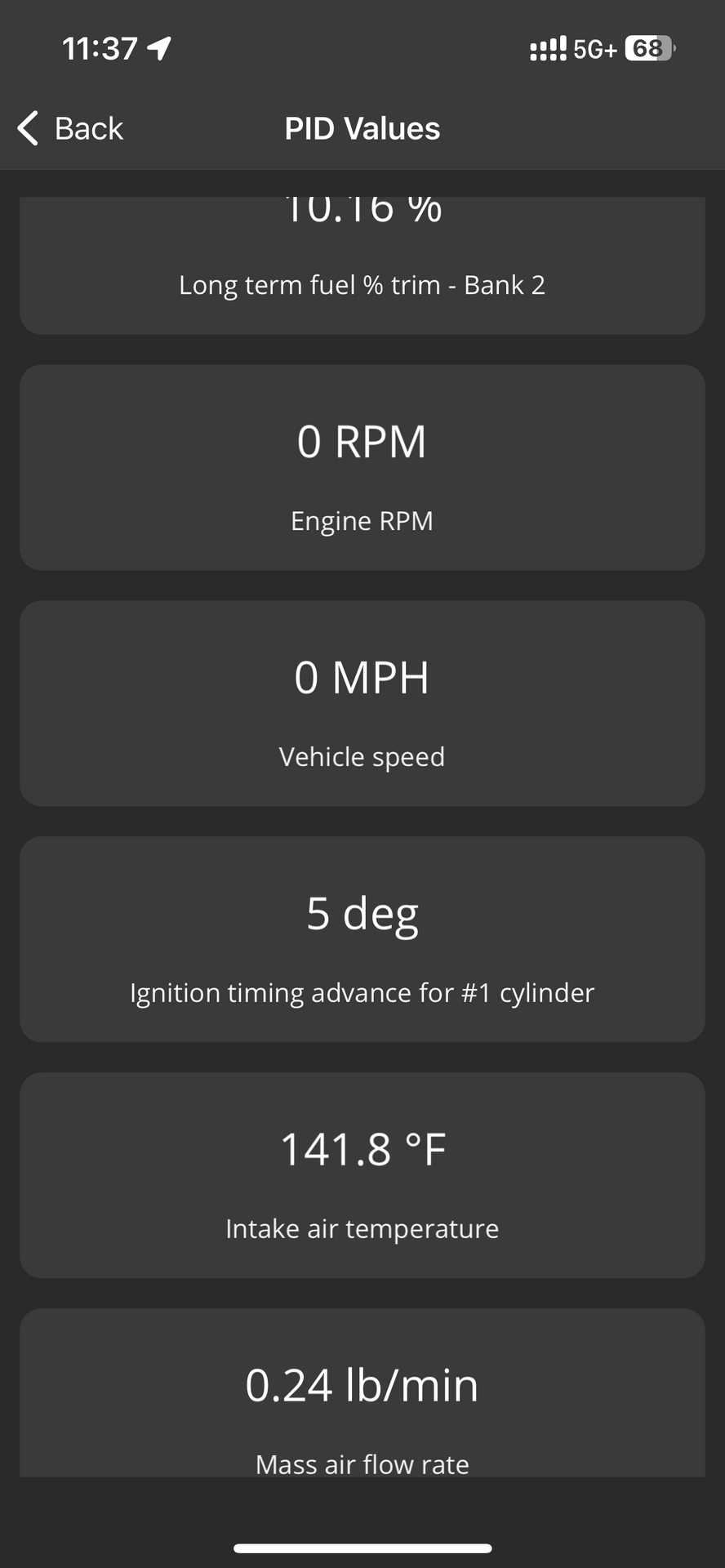

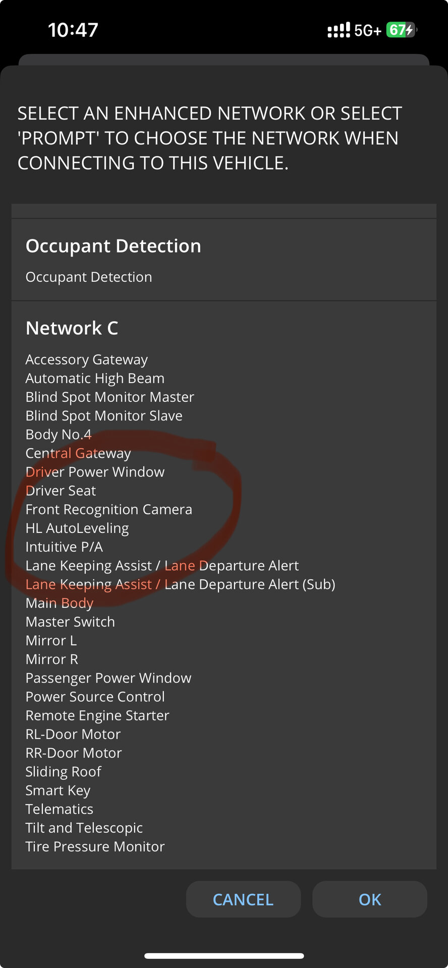

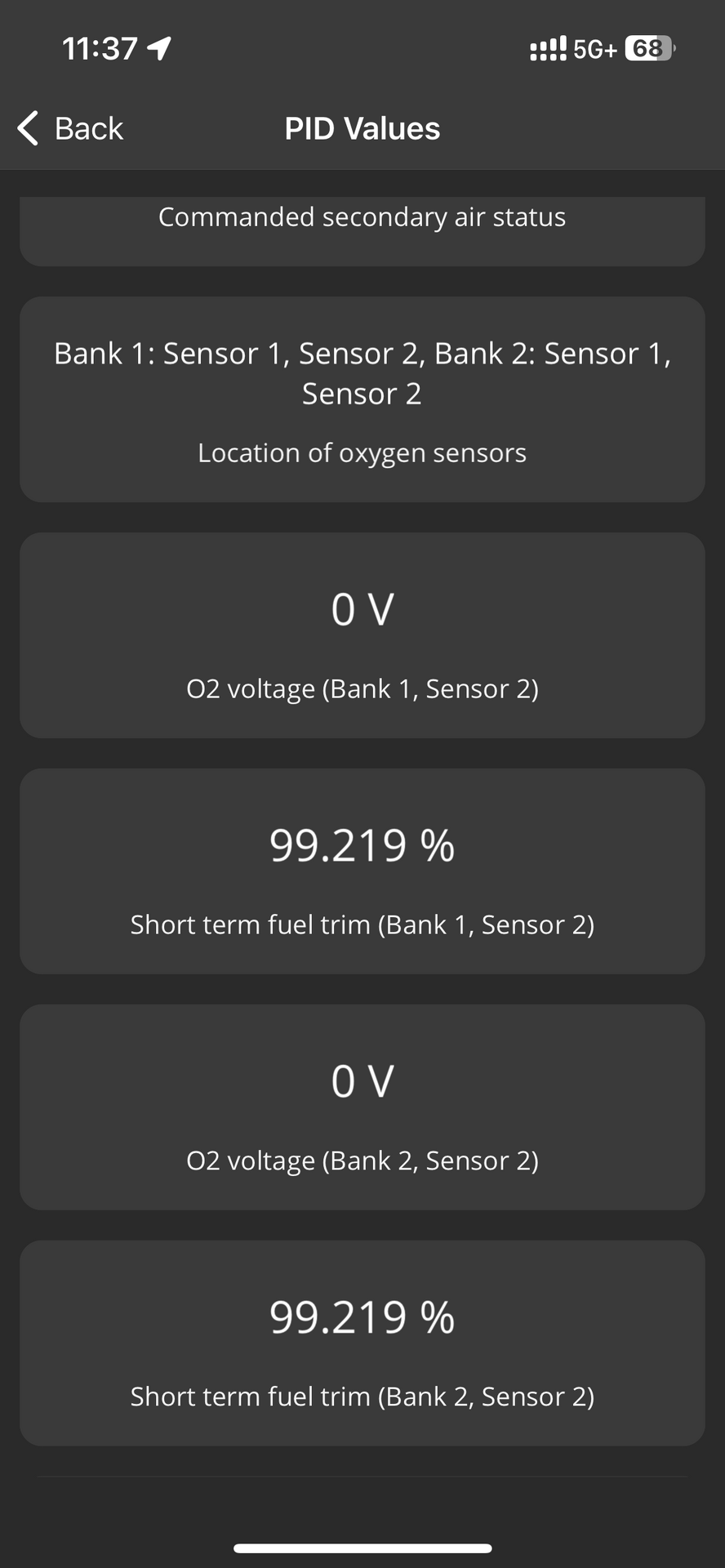

This is what I selected & got after the scan

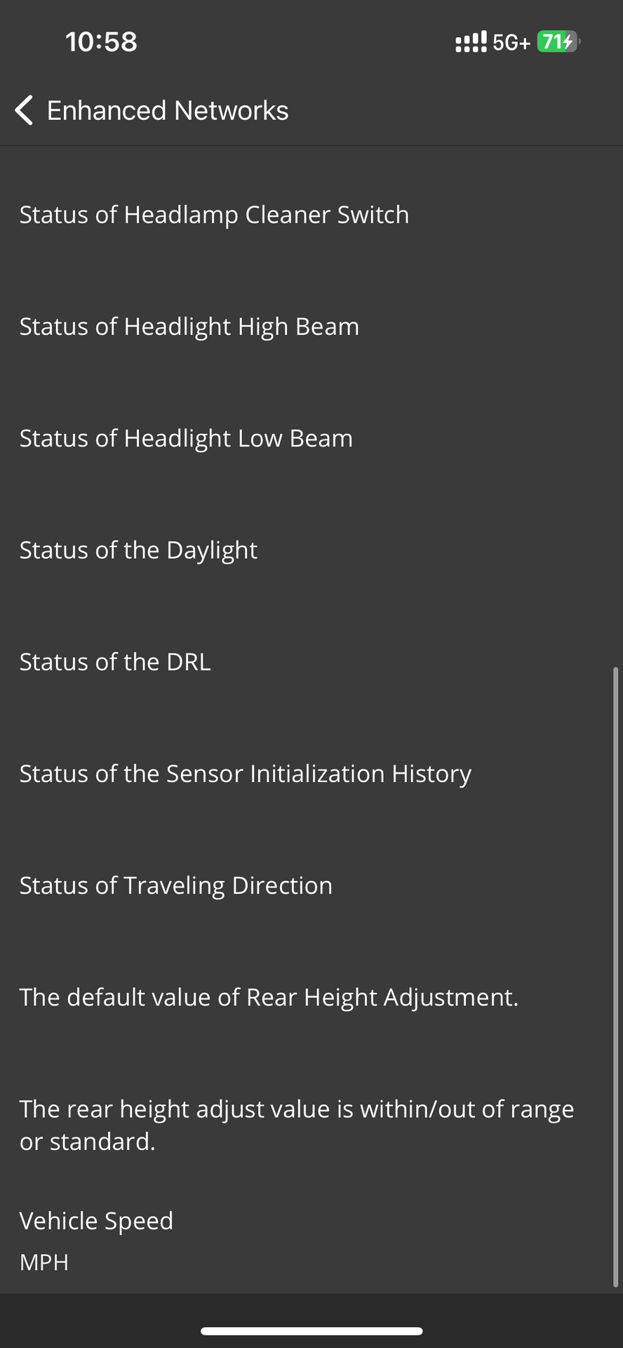

Is this after a scan, not a DTC scan but a PID scan? That seems more like a generic, all the PIDs it's going to scan for list rather than a "i scanned for this and this is what i found list". Since according to the Techstream page in the other thread, a lot of those PIDs are not part of the data list for the HL Autolevel ECU. What does the screen before this look like (like the last screen shot i sent)?

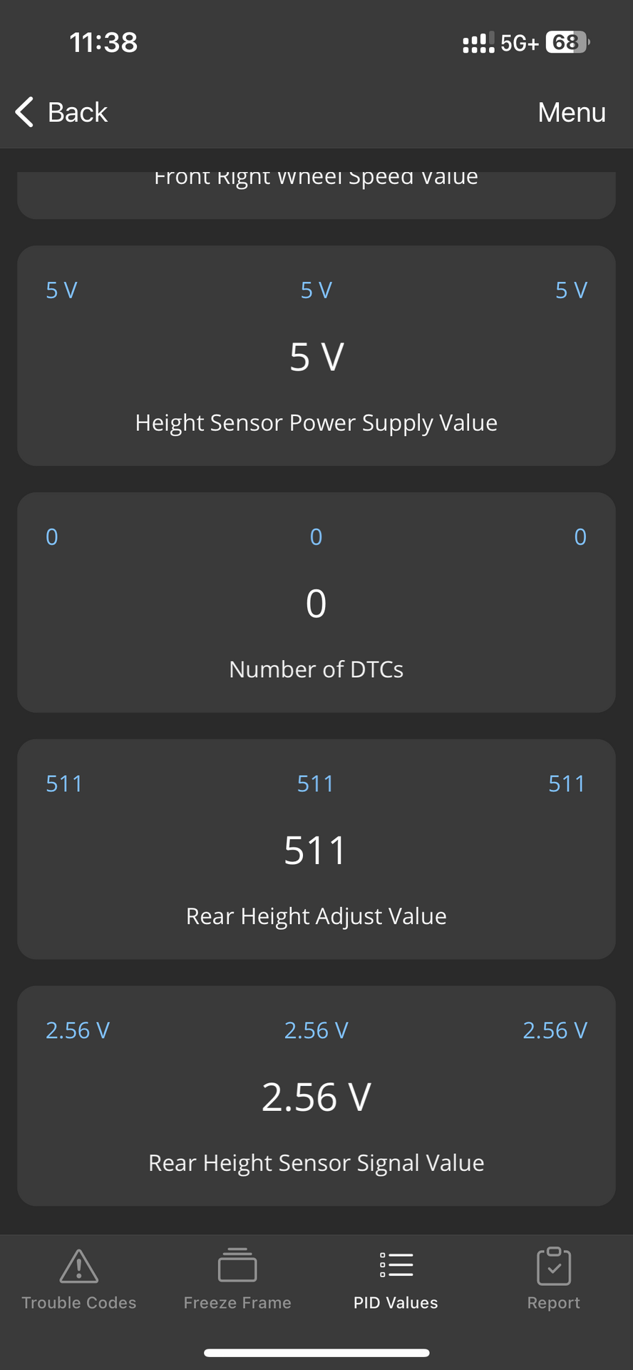

If you've done everything properly, you should be able to set up a dashboard to list some of these PIDs and get values from them. If you are getting values for say Rr Height Sens Signal or +B, then you can be reasonably assured that the HL Autoleveling ECU is working.
So it seems my post yesterday did not go through. here it is again - is this right?!?

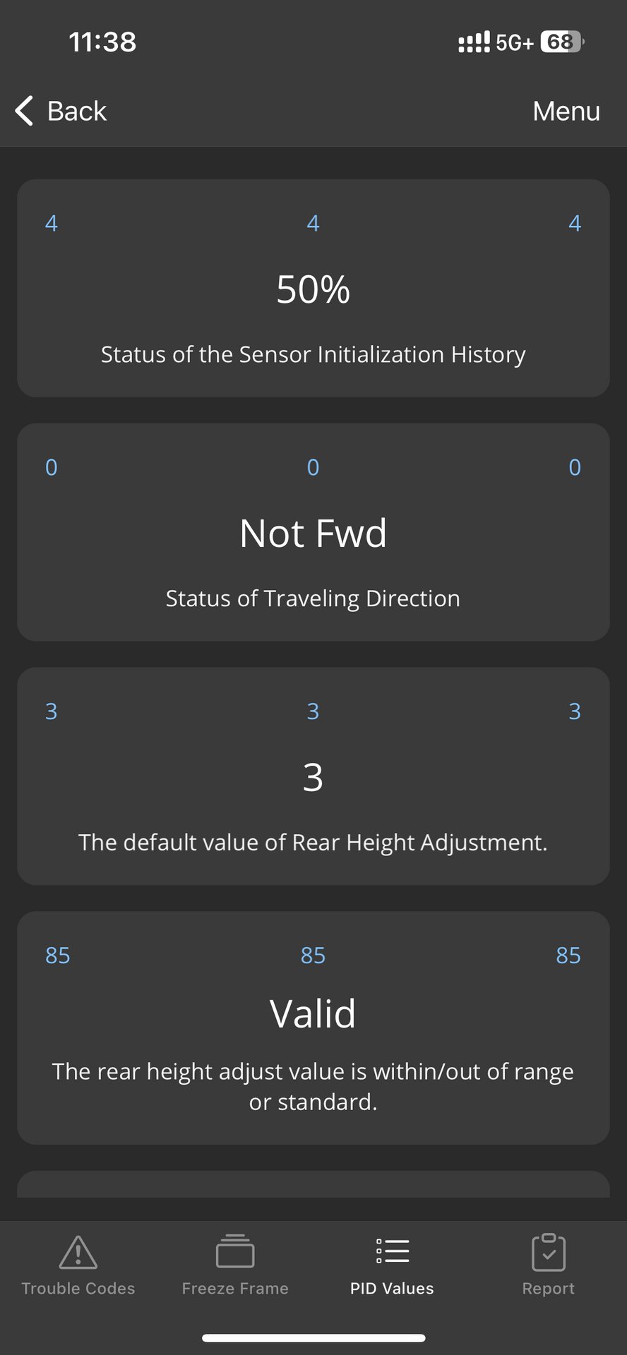

I dont know.. seems like that at least checks out that the ECU is working. Wonder what “status of sensor initialization history” is. And why yours is only 50%. No idea what that value is for. Probably have to check the FsM.

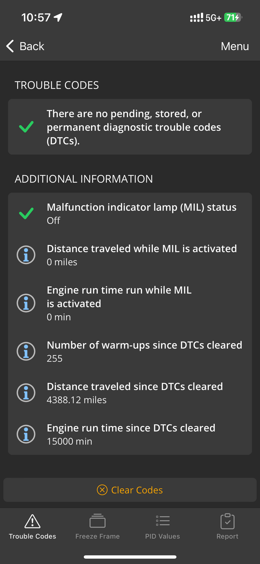

In their defense, it does look like there isn’t a DTC, based on your output. OBD Fusion can most likely see all the values and DTCs, but certainly can’t do any of the tests. I do t think you will get much further without Techstream. Either that or going through and validating each value in OBD fusion?
